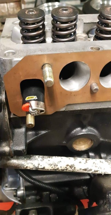

  • Looks a bit more like a motor again! Tried to bolt the manifold on this afternoon and managed to pull a stud out of the head 🤬 will have to wait until Monday now to get a helicoil for it. Once I'

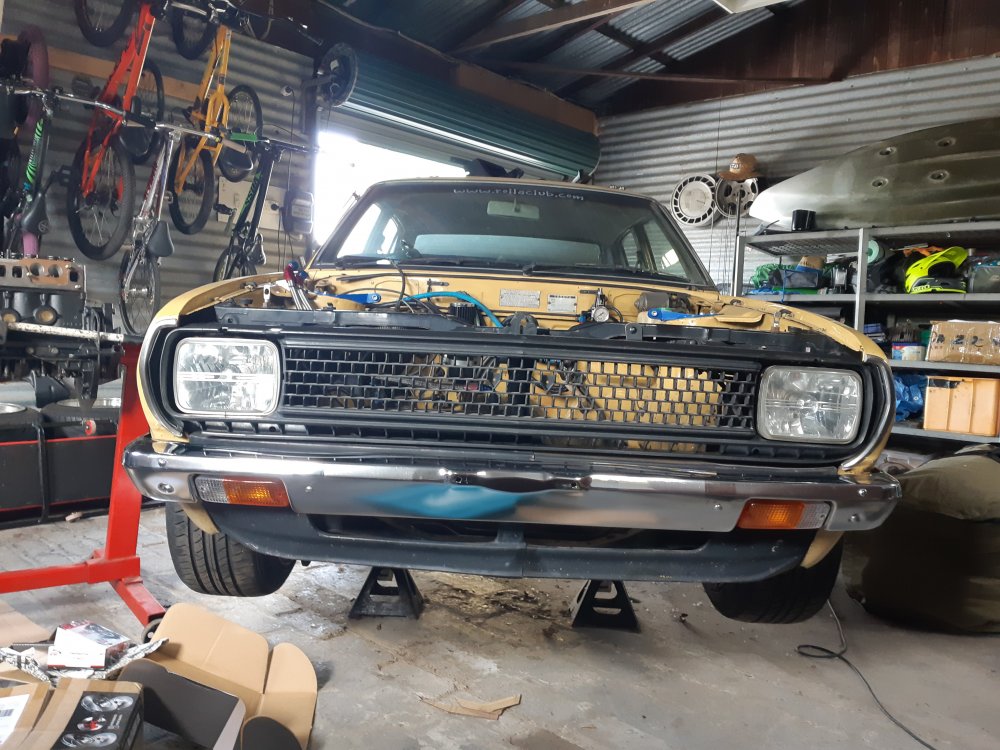

  • So long overdue update. Guess I'll be doing what will become inevitable in a lot of backyard garages in the coming months (Hey let's look at the positives) and getting some work done in this!! Wh

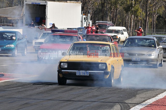

Well done, is that 60 ft right? 1.28? can't be right at all ??????
if it is, sure its not a faulty timer, as the breakdown for the whole race and et vs mph is way off as
far as i can see ?
actually looks like more of a 2.0, 2.1 60 ft with et/mph?, otherwise
it should be in the 13's??
more boost, ha,ha, be interesting to see mph, vs psi gains.
whats your highest mph?, do you know what it weighs?what where you other 60ft's?
Does the strip not have half track mph/times, as that would also be a help in setting up the car
as you can breakdown where you lost time.
Well done, be good to see you times drop from here.

I said exactly the same thing ,its not i don't believe you Si but it just doesn't add up mate.
MAtt
Yeah I know, Nick could tell you what Tarmak is like, its not always the most accurate of timing. :yes:
Listen to the commentator at the end of the "bearing noise vid".
Since he had the handicap on me, it was probably the other cars back wheels or something that got taken as my 60' time maybe!? :lol:
Edited by Taz_Rx
1.28 would be on the back bumper..lol, and would run 13.1 in my head working
it out roughly. Well done though, theres heap more in it, you really need a locker
or lsd to get into the 1.8 60ft or below , and advans are probally 1.7/.1.6 capable with
caltracs and locker.
Still did better than i ever have, think mine only did 2.0's, 2.1's or something on 145's though.
Would be a large weight difference i would think, makes it a lot harder for you unfortunately.
Be good to crack the magic 100mph barrier, more boost!
