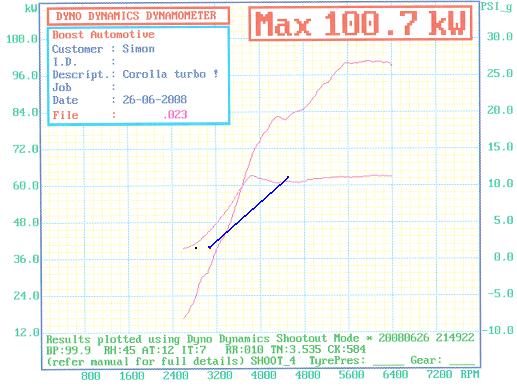

Yeah top end AFR's are fine, great infact.
The .48 is like a stock/very mild cam - Its giving me awesome response, and still flows to the limiter at 7000prm, but I would still like to shift the 'power band' of the turbo further up the rev range.
Oh and I'm not swapping the wheel, just the rear housing. :)
Id like to map the boost curve??, have you got a copy of the dyno run.
MAtt
