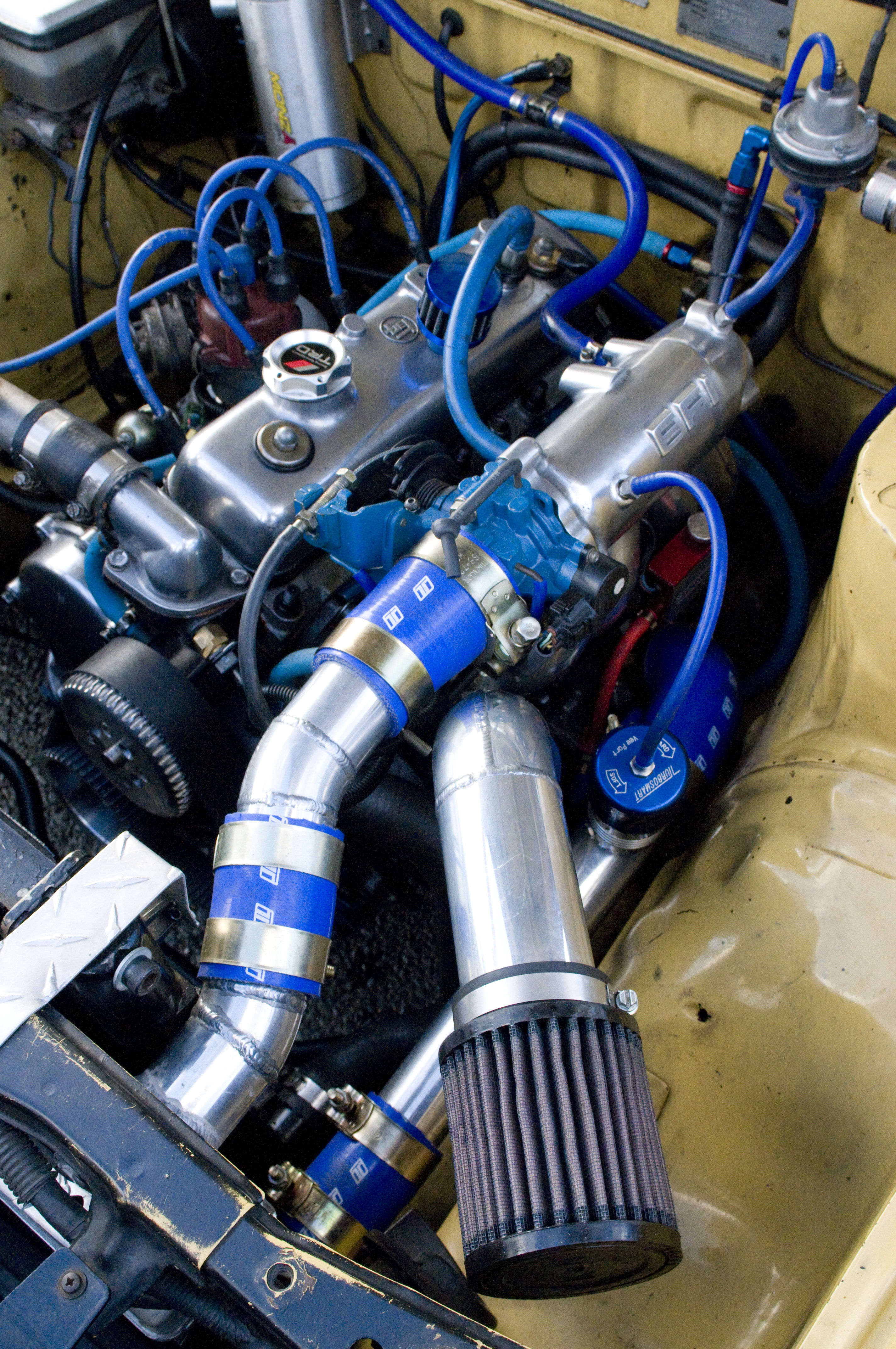

nice pic from the weekend's shoot....
Nice job this is starting to look sick!Well done. pity my engine don't look like that (N) some of the oil lines were too short so had to use garden hose :jamie: ghetto spec much. Finally got those bolts out so will rember to lock the dizzy this time :P
How much is efi's for k engines?
Paid $250 for the EFI system, had to get bigger injectors, ECU, fuel fitting etc etc. Then tuning as well.
Do yourself a favour mate and go and get some correct size auto hose and piss off the garden hose. It'll get hot and crack or melt. Bad idea.
Haha yeh hose was just for the test runs before the headgasket blew.
Hmm might look into the efi system once i get it running
now thats a nice K engine!!
Always liked this car/build up, I might do a simple turbo 4K for myself day.
Cheers, Ben.
thanks Ben, give me a yell if you ever needs some pointers when you build one then! :dance:
