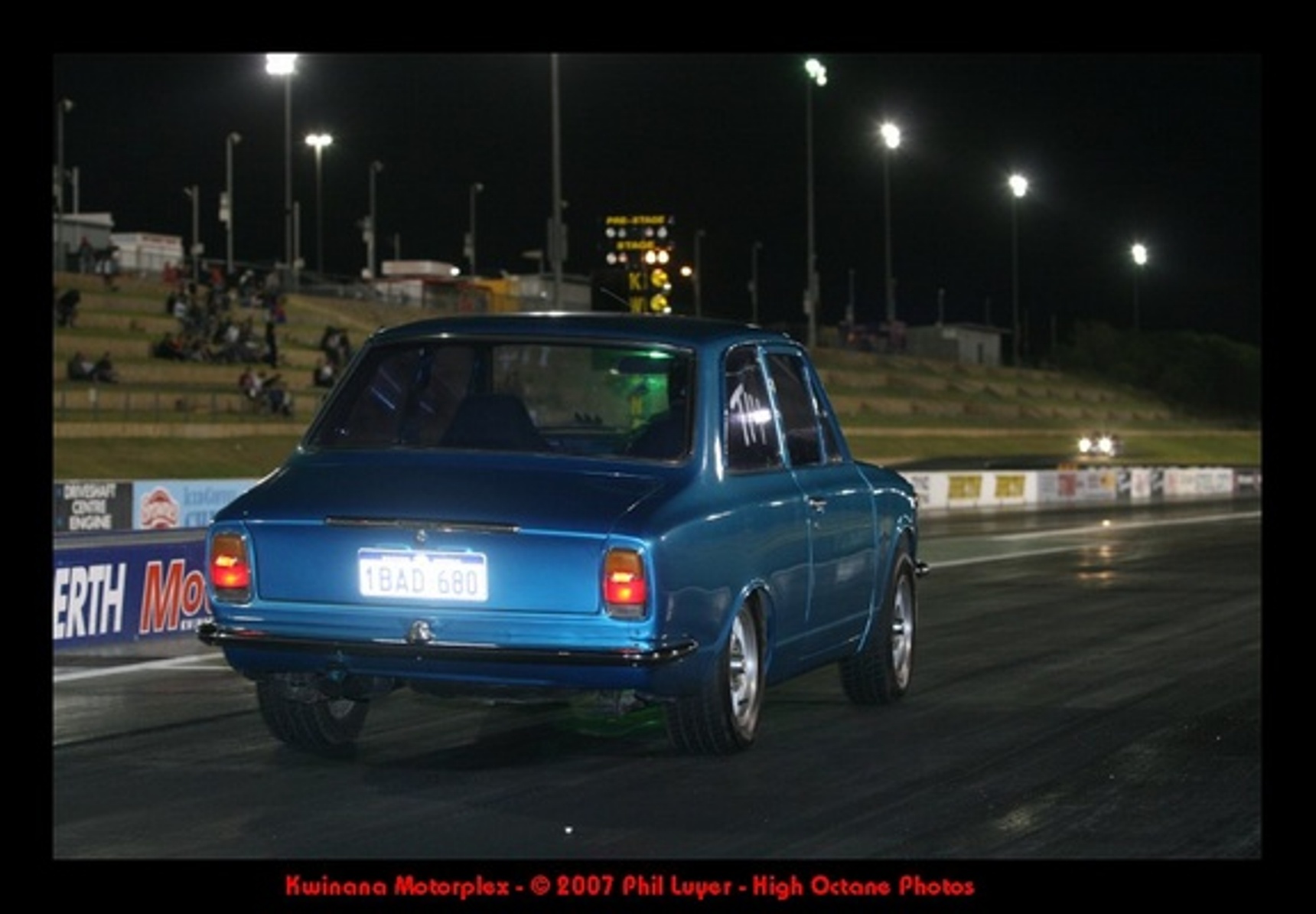

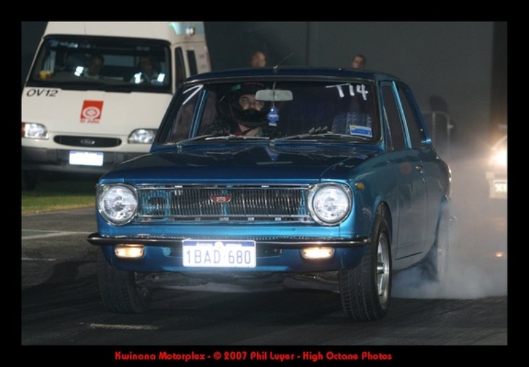

Yeah ran 13.7 @103.
Got a few issues to sort out,but was happy with that with first run on about 16 PSi as clutch wouldn't hold anymore than that and gearing is all wrong for any bigger MPH at this stage.
Just make sure its on a DD dyno mate or you might get flamed.
Heres a few pics from wed night,hope you don't mind.
