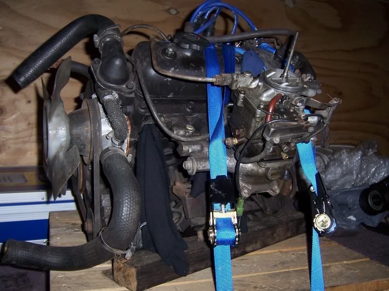

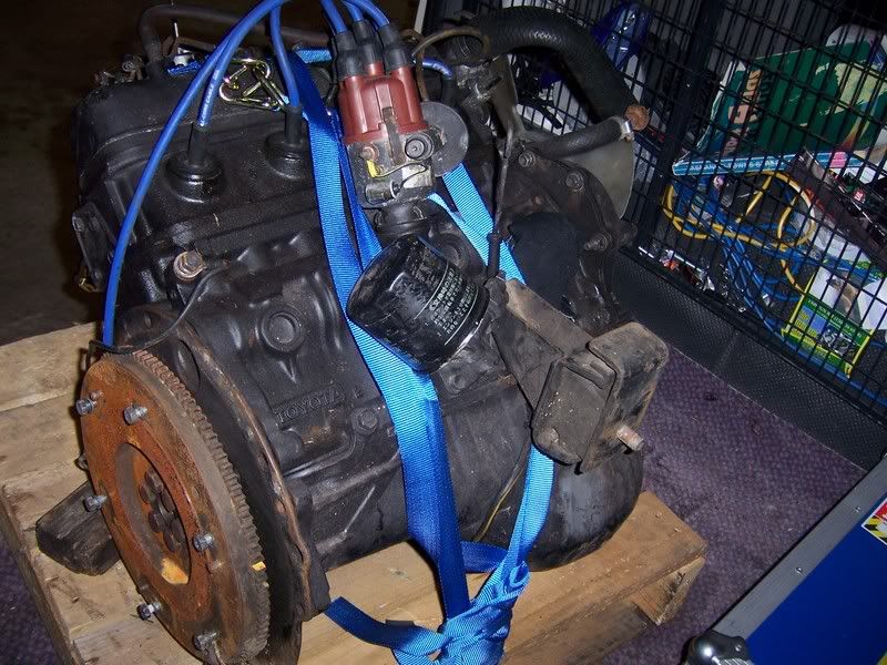

This will be stripped back tonight and start having the turbo stuff bolted on.

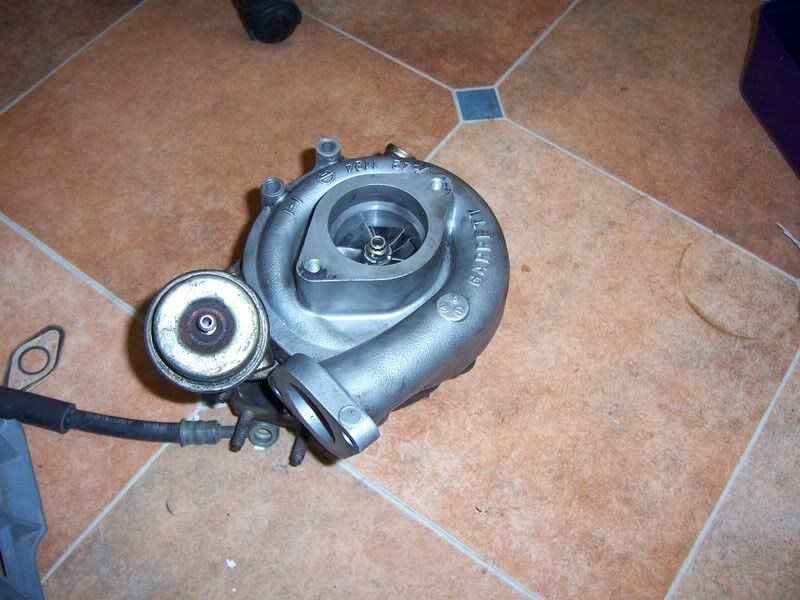

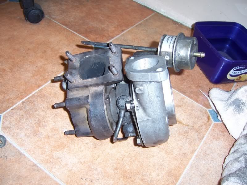

Have pic of the turbo I picked up last night. Its a T28 off an R32 GTR. :bash:

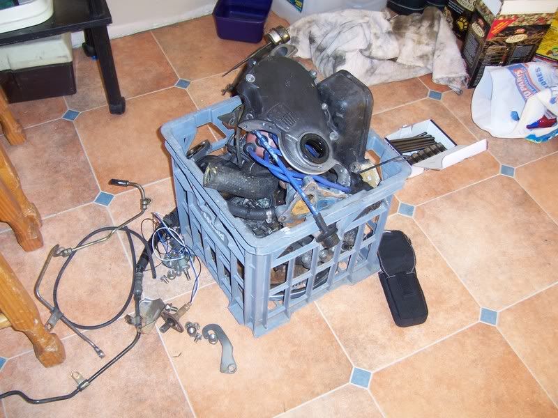

and this was how much shite I stripped off the 5k last night, plus the head, lifters and pushies, not pictured.

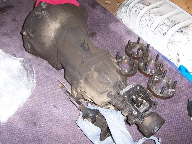

cheers anyway si, tis looking good mate! and i spy bolt on spacers? whats the go with those
couple more new bits.....

Hey Si whats that gearbox out of again mate and did you send me a link to another bellhousing???
