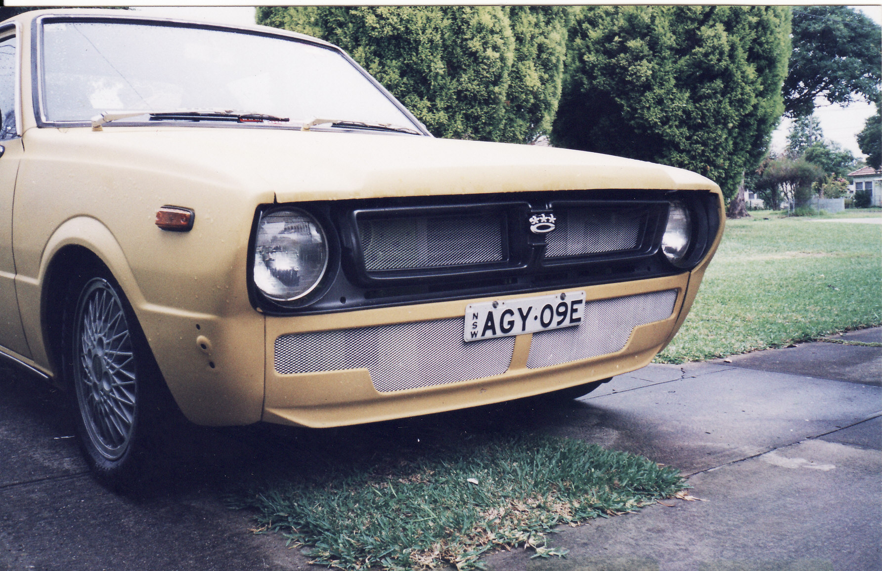

Hi mate, just thught id post up a pic of my old KE55 with 4K ,charade turbo carby , liberty turbo , big cooler , fuel pump , 18 psi boost and stock every thing else. i went through 6 standard gearboxes in the time i owned it. carby is suposed to have a plenum on top but is not in photo in case you were wondering. hope you like it.
carby was jetted out so fuel wasnt an issue, but even though it looked good, it only made 69 rwkw on the dyno on about 17-18 psi . It was a gun off the line but had little up top. :wink:

carby was jetted out so fuel wasnt an issue, but even though it looked good, it only made 69 rwkw on the dyno on about 17-18 psi . It was a gun off the line but had little up top. :no2:
Yeah reckon you have a few isues to sort out there mate. :wink:
carby was jetted out so fuel wasnt an issue, but even though it looked good, it only made 69 rwkw on the dyno on about 17-18 psi . It was a gun off the line but had little up top. :y:
I made that on 8 psi! :no2:

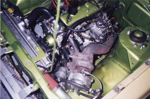

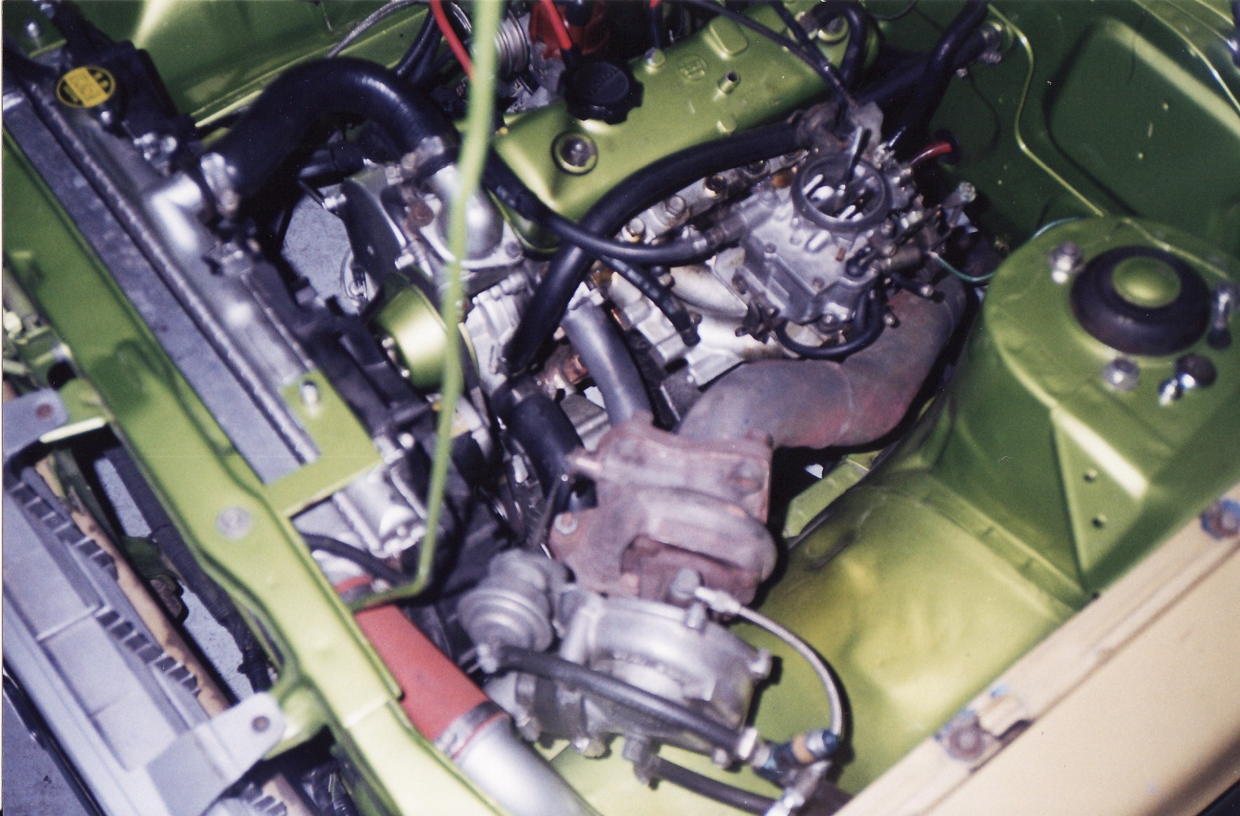

Was up til 3 on friday night building the 5k, swapping bits over, and swapping engine. Had an early start again today and was working on it most of the day.
Got it running fine in the end, had it at about 14psi (will upload a vid of the boost guage later). Still only running 20o, so I might bump that up a bit soon. 5k isn't quite as much more power as I was expecting, but I'm just putting that down to the low comp. Need more boost and spark now!!! :wink:
Not much need for pic, looks just like it did befor cause I swapped all my polished bits over.
