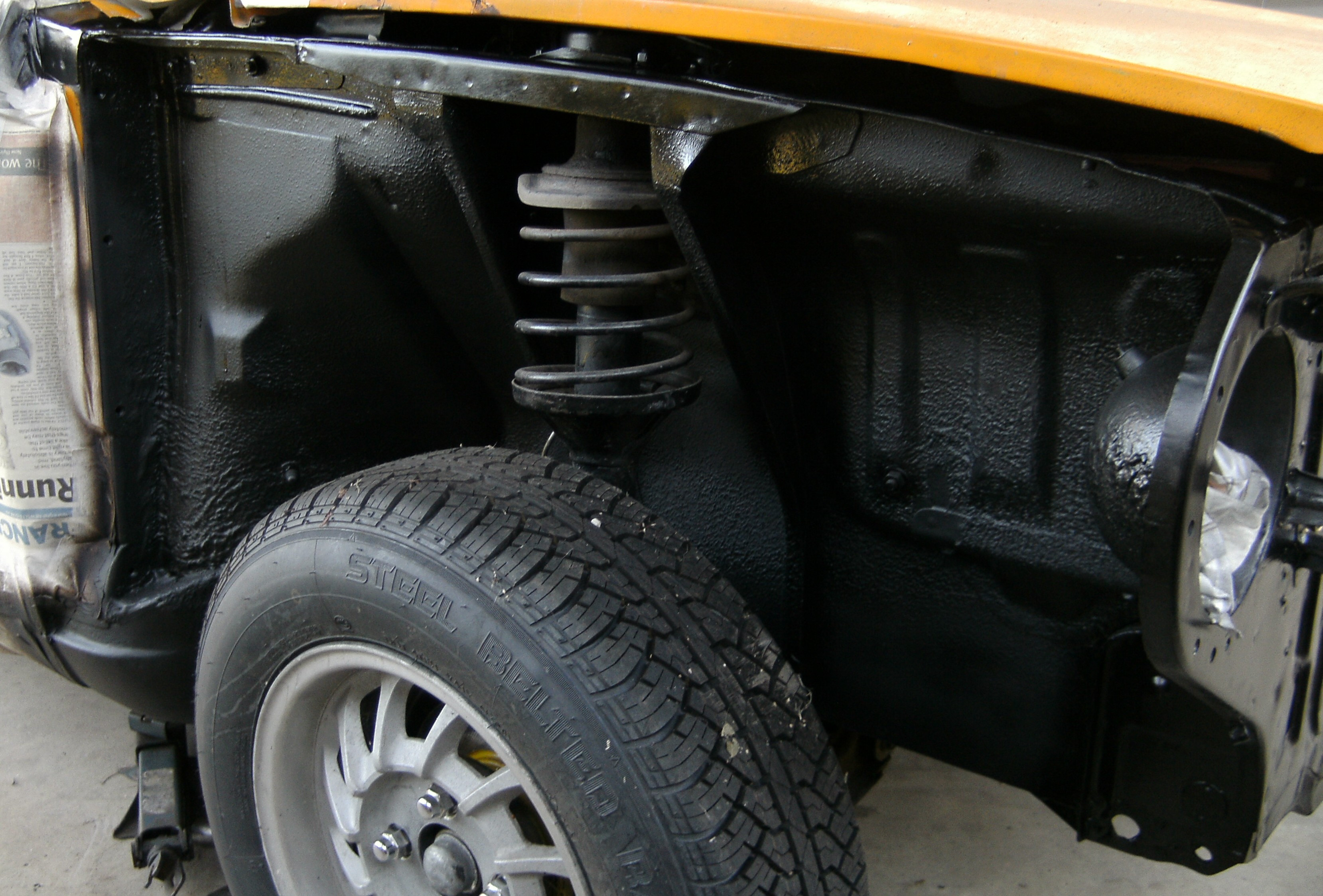

Well got AWESOME news :) Tonight I confirmed my restored powder coated stone chip tray for under the front of the car is going in the post :D Should be here soon so that is that Item taken care of.
Also tonight got the rear braided brake hose line in the car :y:
Pics below:
Looks AWESOME. Now to clean up the rest of under there..lol
Also while I was in there noticed was dirty as so on weekend after putting clear coat on the car if I have time (going bass guitar jamming) ill be stripping the rear wheel wells and stone chipping them like I did the front arches so they look the part. Also will change the small rubber line from fuel tank to metal fuel pipe looks old don't wanna risk it.
So that is the updates for now watch this space....
Cheers
Cameron

UPDATES:
I got some more painting work done. I got all the front pannels off the KE15 and noticed one wheel well was half painted black other was fully black with a lot of dust/dirt and a lot of over spray orange. So I got excited thinking ill strip it right back new anti stone chip and have it all black again. To my amaze ment the original owner never washed this part of the car when he painted it the first time :wink: So out came the tooth brush lots of degrees er and water and about 4 wash dry wash dry..etc cycles later it went from this:
TO THIS:
Now the above photo was a half way shot you can see the front is clean and there rear I hadnt done yet. I also then cleaned the rear half and then all over another 2 times but don't have a after I was done the whole thing photo ;) BUT long story short the guy who owned it painted over the white (original colour) still covered in dirt with black, got dirty again then painted car orange locking in more dust AHAHAH So jsut by depressing and washing I got the whole wheel arch to white again wish I had that photo..LOL So then I proceed to strip a few spots that looked like they were rusting and NO RUST. Apart from small spot in lower left of photos. So out came the stone chip and black paint and went crazy. Finished result:
You can see how good this has come up looks a million bucks also did passenger side. Might as well do both sides when the whole front end is off the car do it properly once.
CONT next post....
coming along very nicely well done looks brand new under there

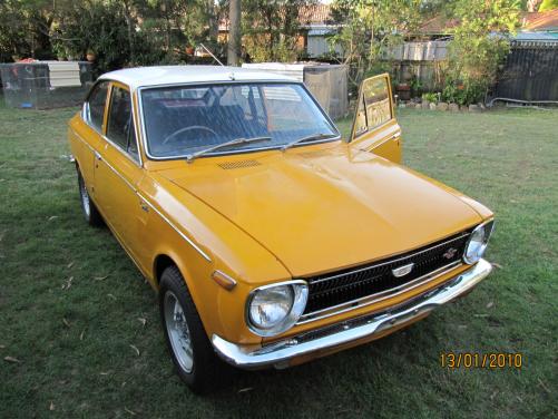

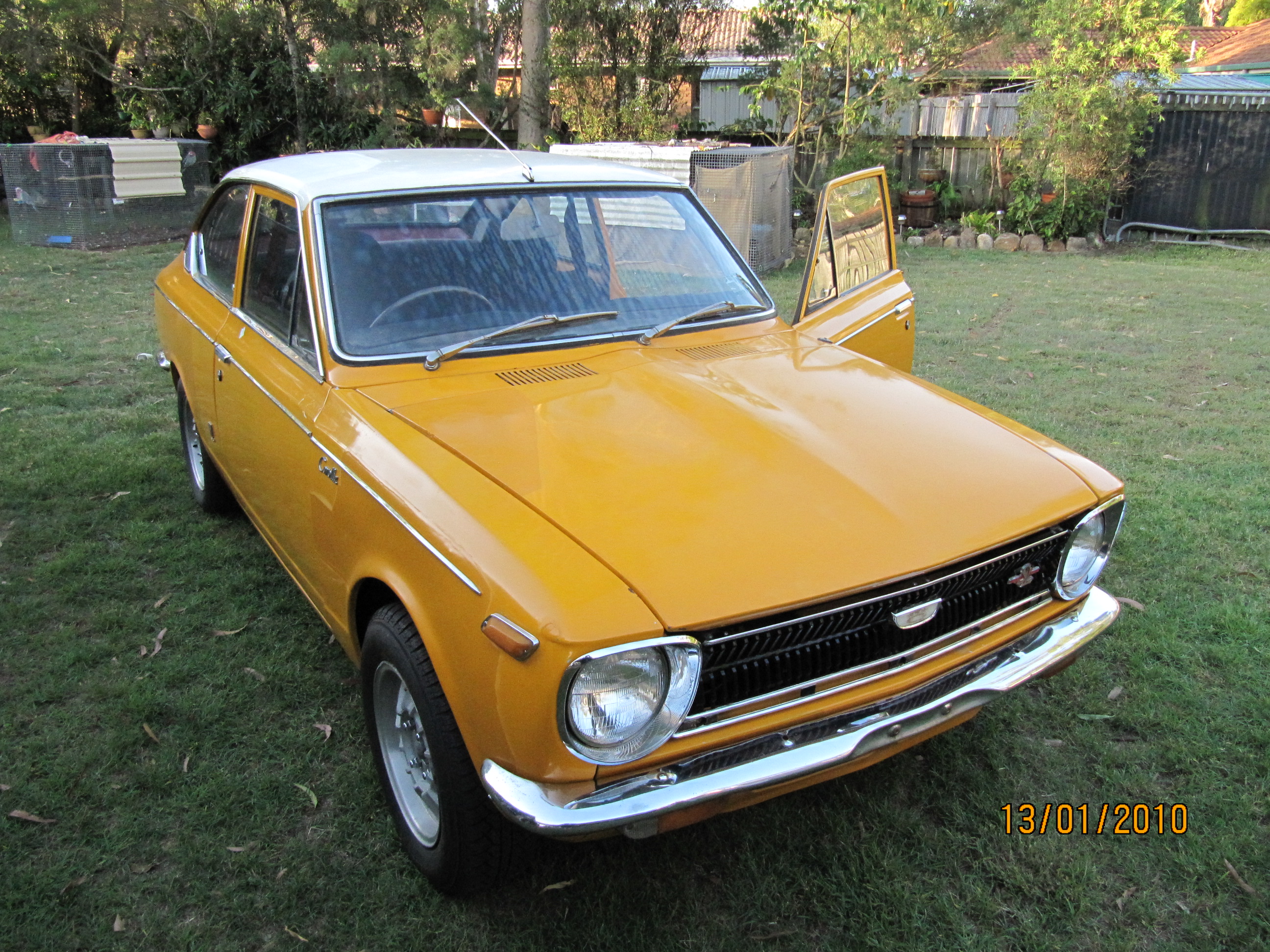

AND IT IS ON THE ROAD.....
If you have all read carefully some threads on here you will notice that the car has been on the road now about 4 months..LOL I'm slow to update..LOL
ALl I can say is these cars are SO SO SO SO much fun to drive. Everywhere I go people look ask questions and love riding in the car is AWESOME.

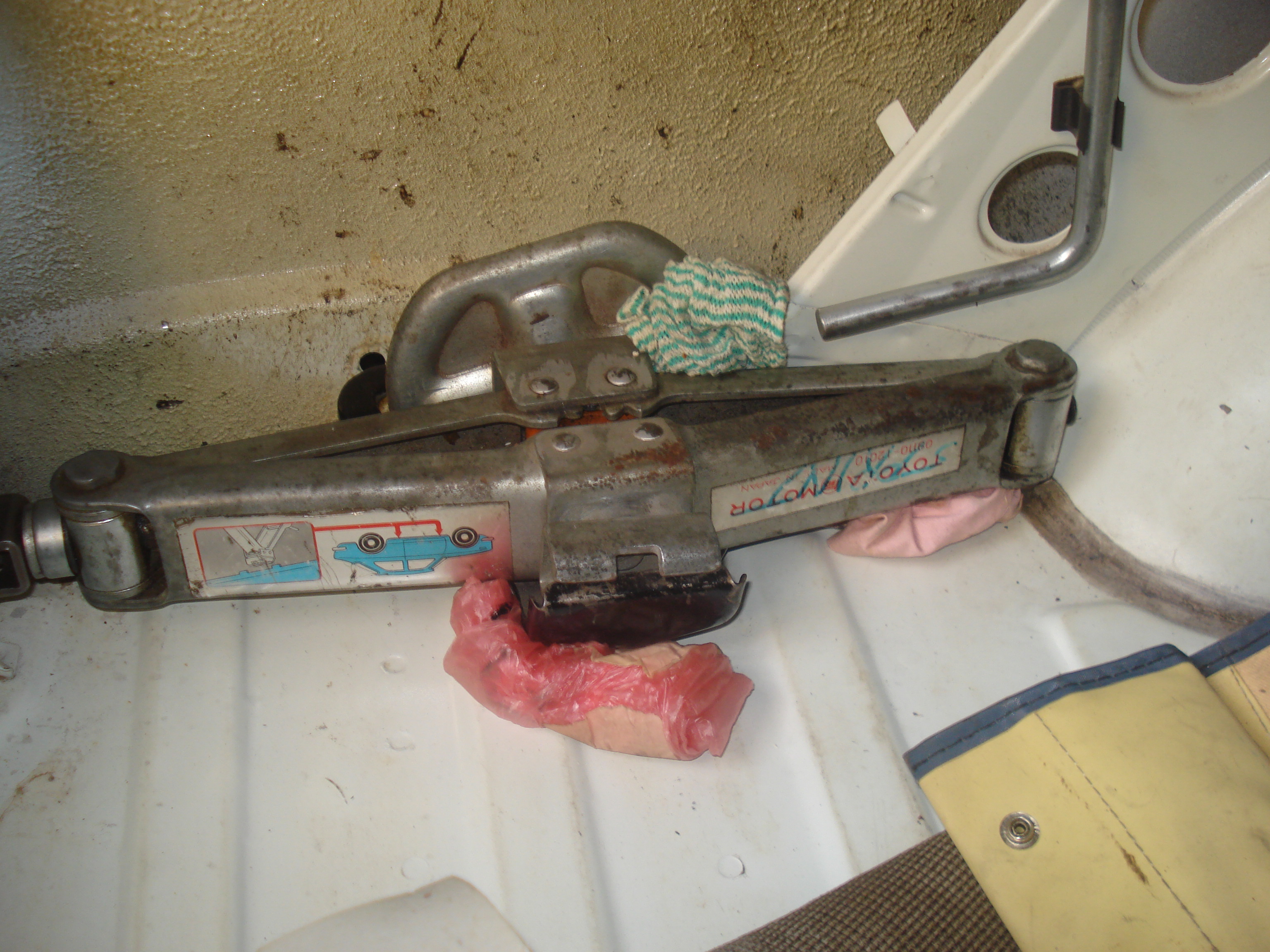

- find a KE1X jack. (has a KE3X jack in boot and it will not fit mount so rolls around)

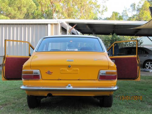

Below is a Pic just before I put the plates on it the day I got rego :P

Oops forgot about getting a pic of my jack for you. Try to remember over the weekend.

Felix: Yes jack pics a must :(

This is what my jack looks like, complete with factory padding to stop it rattling! At least that was how it came from the original owner. I presume it is the original jack.
