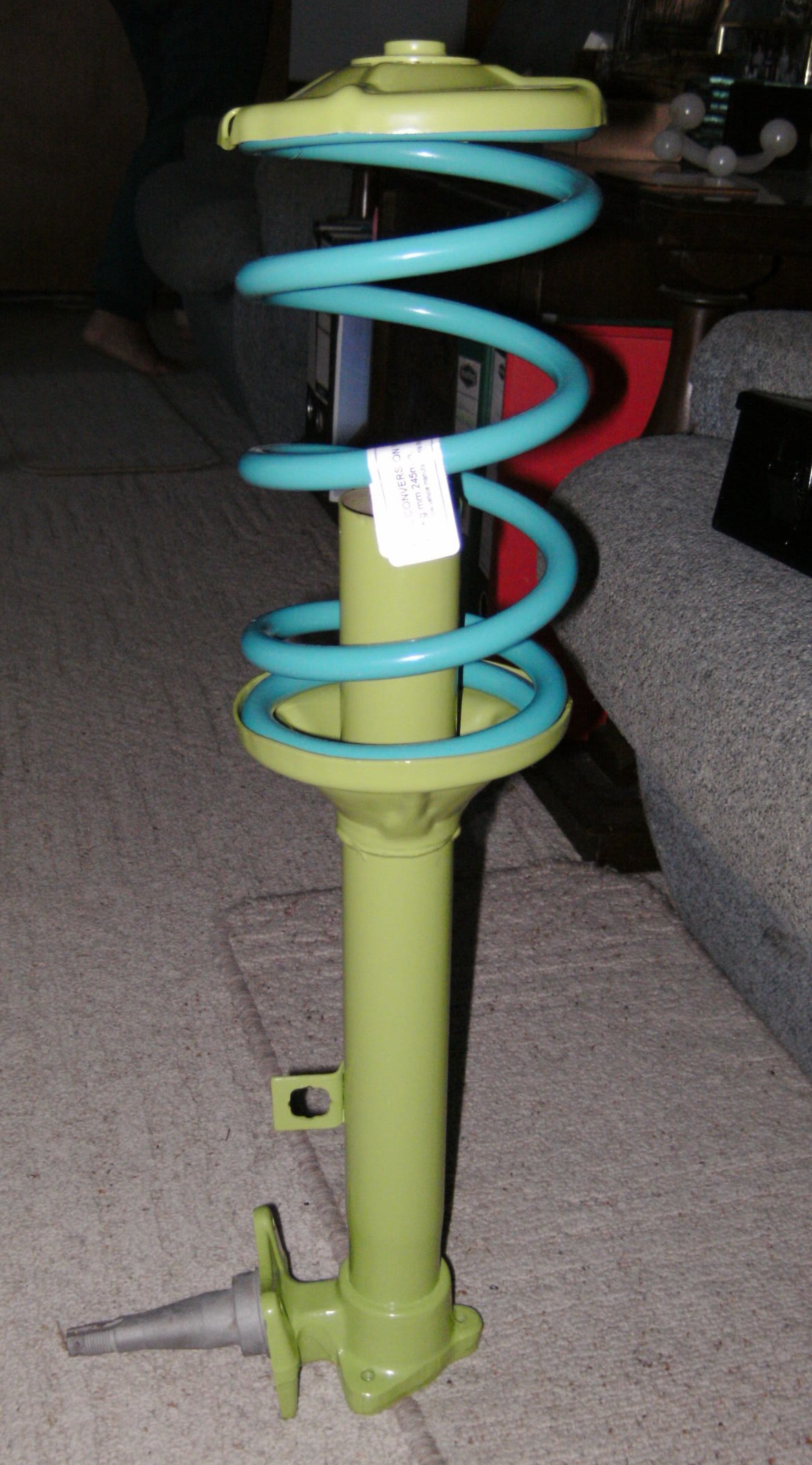

First off suspension: Not much progress here so nothing to post yet.

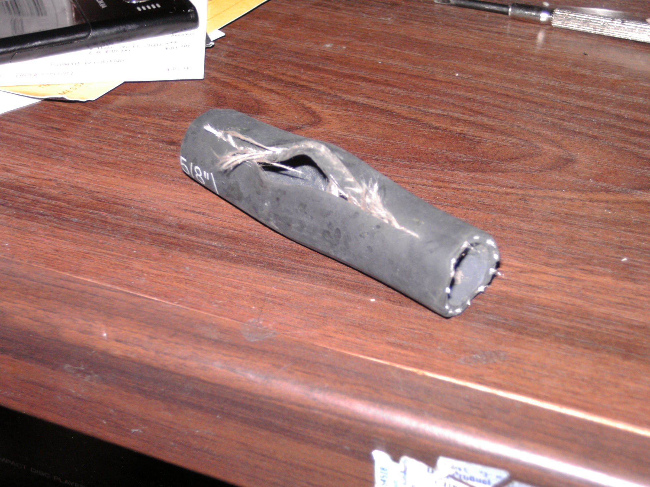

Last weekend while driving out to Beerheads place to see him I was cruising along at 100km/H and BOOM the loudest bang I have ever heard. And all of a sudden the heater in the car went cold OH SHIT. Middle of no where the heater hose blew a hole pumping out all my engine water instantly :( car temp sky rocketed. I was lucky as I was 1 street away from Beerheads place so was near water :blinks:
Did a temp fix on hose at his place with some metal tube and more clamps.
But below is a picture of the section of blown pipe:
This pipe I bought from Supercheap 3 weeks ago to install my heater again. Tube had no nicks, tears, damage etc. But still blew. Brand is Gromet and it is SHIT. Single wall piss weak re enforcing crap. :(
So drove around for the week with the temp fix as well didn't leak etc. And on Friday just gone I decided to buy some better hose. I went to my mates shop he sells hydraulic line for trucks. I got 2 meters worth of hose suitable for hot fluids rated to 20 BAR at 100PSI. Should hold my 1.1Bar the KE15 has.
So this morning I decided what better time to install my new hose. well was I in for a surprise :(
I drained the coolant system and put in new hose clamped it up and then re-filled the coolant system. I noticed the drain bung in the bottom of my radiator had a slow drip leak ok have to fix that. But then I noticed a lot of White smoke coming from the exhaust :(.
So ran got a piece of paper and held it at muffler tip for 1 min. No black particles on paper after 1 min or oil residue or oily smell. But paper was WET AS :( Ten it hit me I blew the head gasket when the motor over heated :( FAIL.
so I went back tot eh engine and opened radiator cap yep every say second or so one small bubble would rise up :(
So pissed as I stopped the car and got stuck into removing the head. I timed my self took me exactly 28 min 4 seconds to remove manifolds, carbies, extractors, ignition leads, spark plugs, rocker cover, and head. Was quite pleased with my self.
To my surprise I found out this 5K I have is SHIT..lol In cylinder 3 just at bottom just above the piston at bottom dead centre like a section of the bore is missing :( But the head warped bad. cylinder 2 was squeaky clean from steam :( and it looked like in the past week after driving water pressure built up and pushed its way into cylinder 4 and would sit there. so it was a bit crap from thsi also :(
So in short I need a new 5K built fast..LOL
But for now I'll just fix cylinder head and re-install.

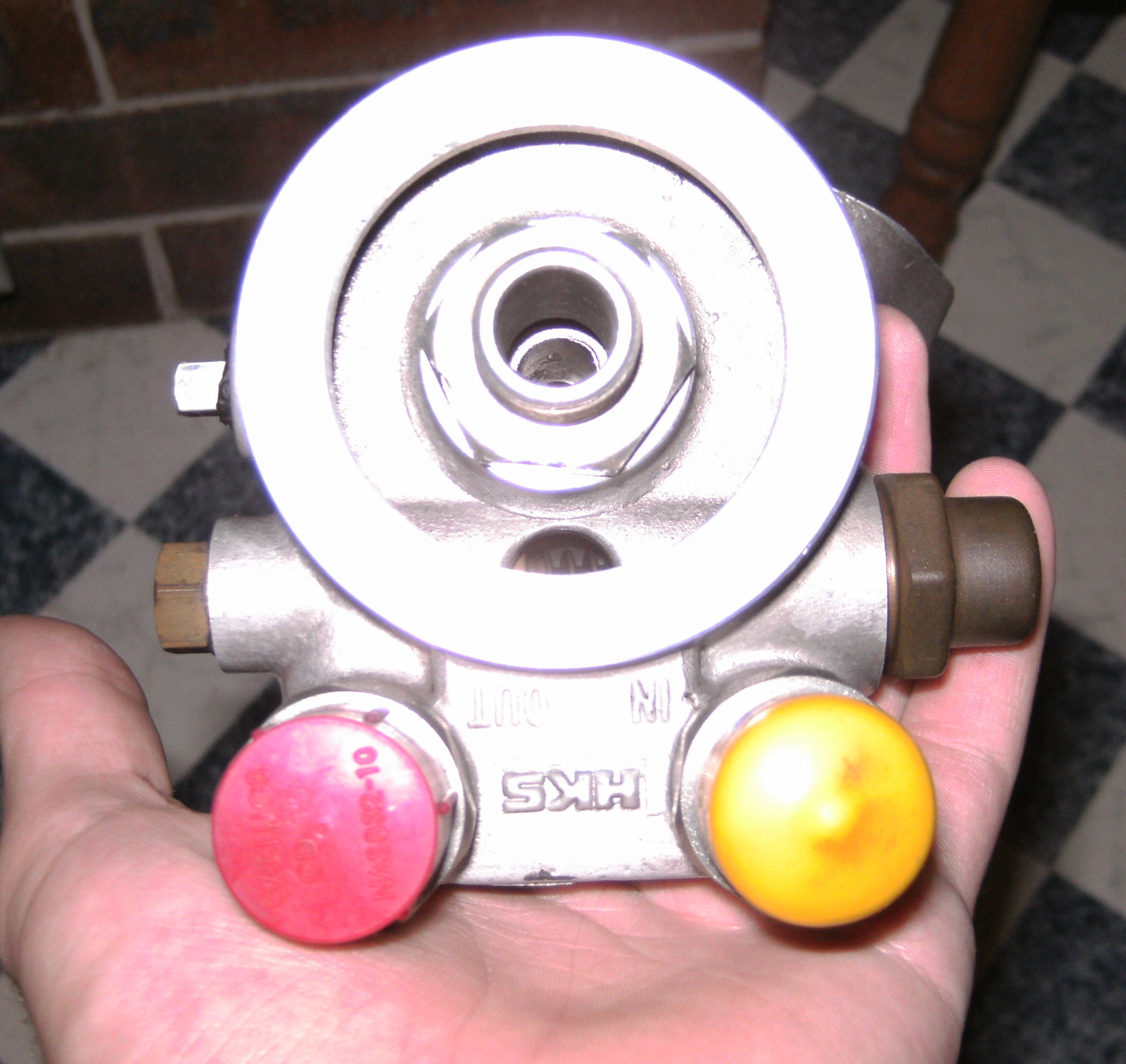

But I also piced up this little beauty.
Yes it is a HKS K motor oil cooler plate thing. WIll need it for the next spiffy 5K I am building for the KE15. Is a thermo controlled one so lets oil warm before cooling think thermo stat is at 74 degrees C atm. But it is variable from a quick look I had. Came off a KP61 starlet in Japan with very low race KM can tell as it is also so clean..LOL
So this will match up well with my oil cooler new in box I got at a swap meet for $20 :laff:. Is a factory ford one NOS like 3 years old some guy had so now just to get rubber hoses but there easy enough to get.

The 4age oil plate is already a thermostatically controlled unit.
But he stills need the various fittings and hose. The fittings can add up surprisingly quickly.
Edit: sorry just realised what you said. My RWD 4AGE never came with a oil take off plate. I did pickup an AE82 bigport Aus fitment one later on though which is banging around in the shed somewhere. Longtime since I looked at it, but I'm as sure as can be without pulling it out that it isn't thermostatically controlled. Perhaps your thinking of smallport ones?? Not familiar with those
yeah i was under the impression that the 4age ones are a pressure based system? so when your reving it hard it flows oil to the oil cooler, then when your driving slow it doesnt?

Well people have said that when you turbo a 4age you have to take the thermostat out of them so the turbo has oil feed from start up, What is the point of have the oil cooler on a pressure system?
It would be open all the time if it was cold or hot.
