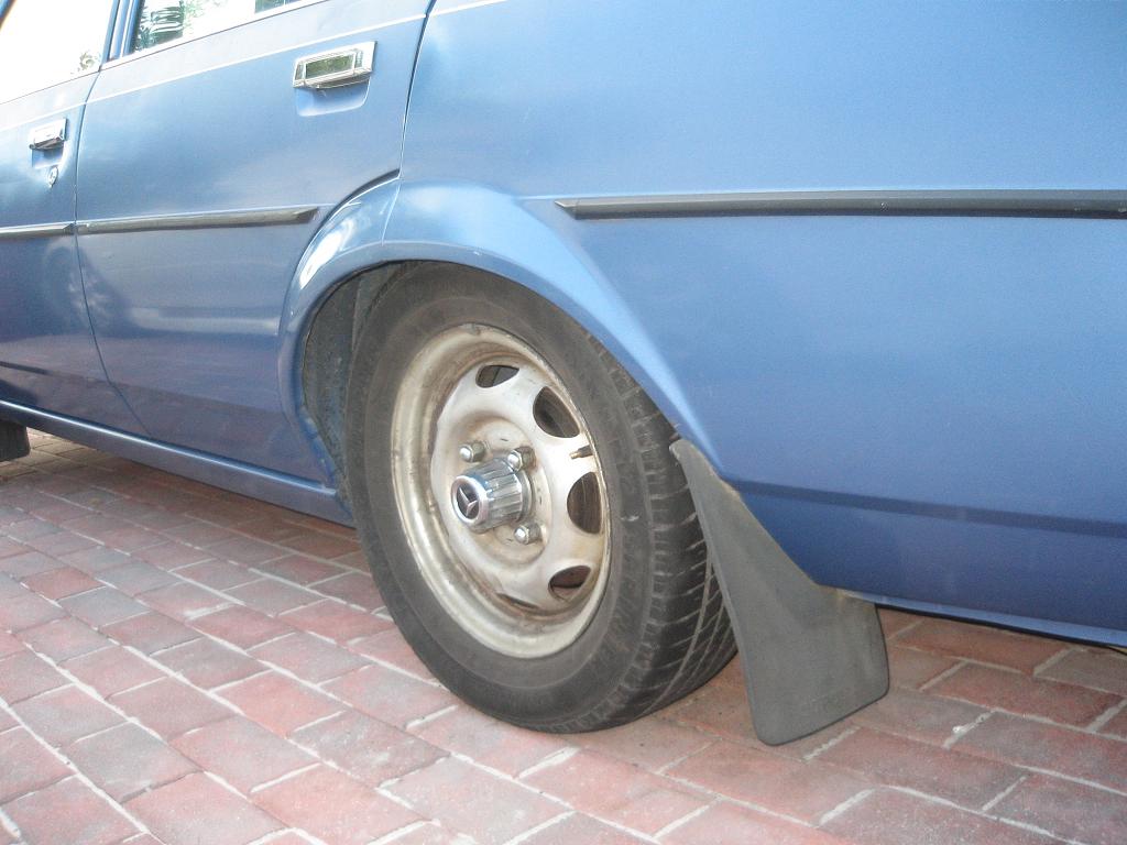

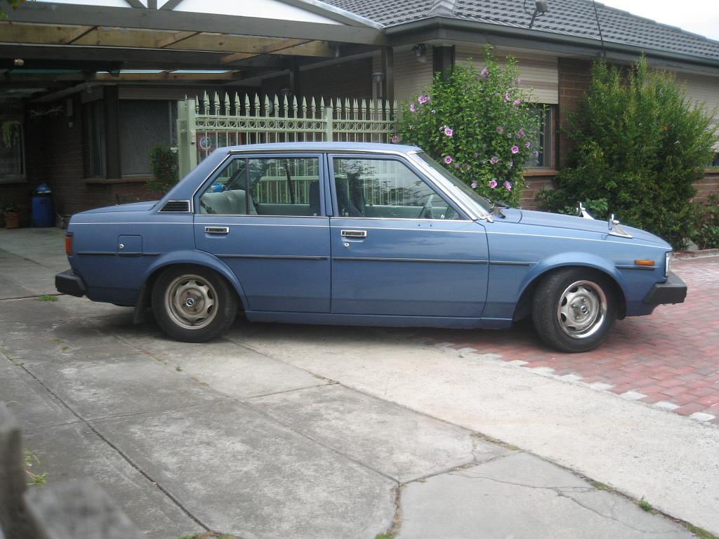

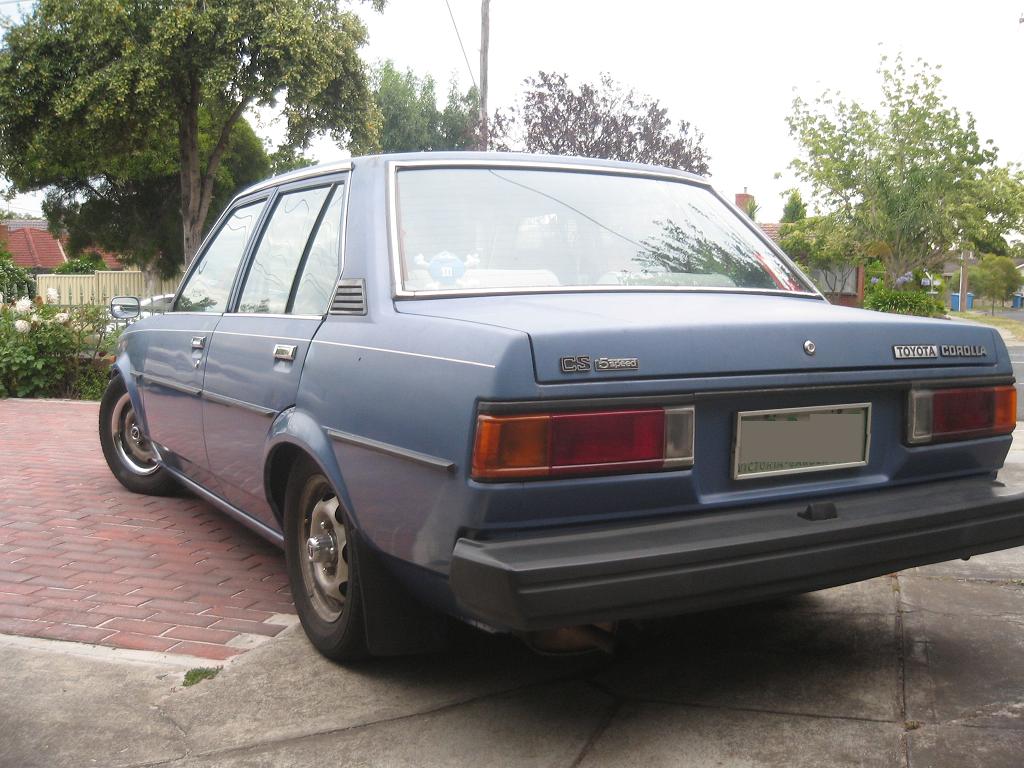

Okay, I finally got the pictures on my computer. These were taken after the rears were only done. I've already got the front ae86 struts in, but haven't had the chance to get the photo's up yet.
The front seems to look higher than stock with just the rears done, but it looks alright now with the front done as well.
post-4793-1201074809_thumb.jpg post-4793-1201074832_thumb.jpg post-4793-1201074851_thumb.jpg post-4793-1201074868_thumb.jpg
Rear suspension are, KYB sierra short stroke shocks with cut AU falcon springs. Springs were 200mm in length free height.

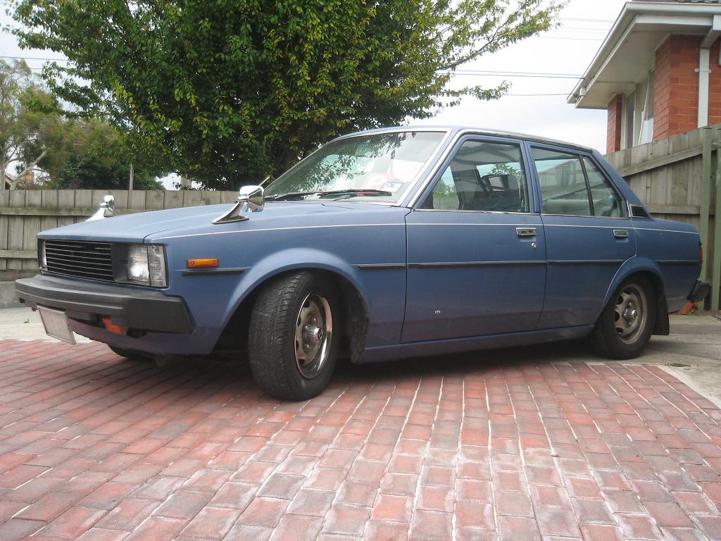

Front suspension are standard in the photo's, but they're now standard ADM AE86 struts, brakes, hubs, blah blah, with king springs which were compressed 100mm. They sit low...

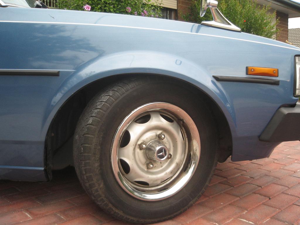

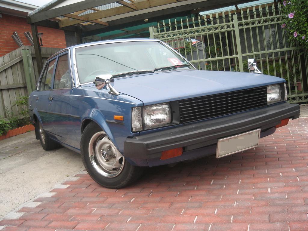

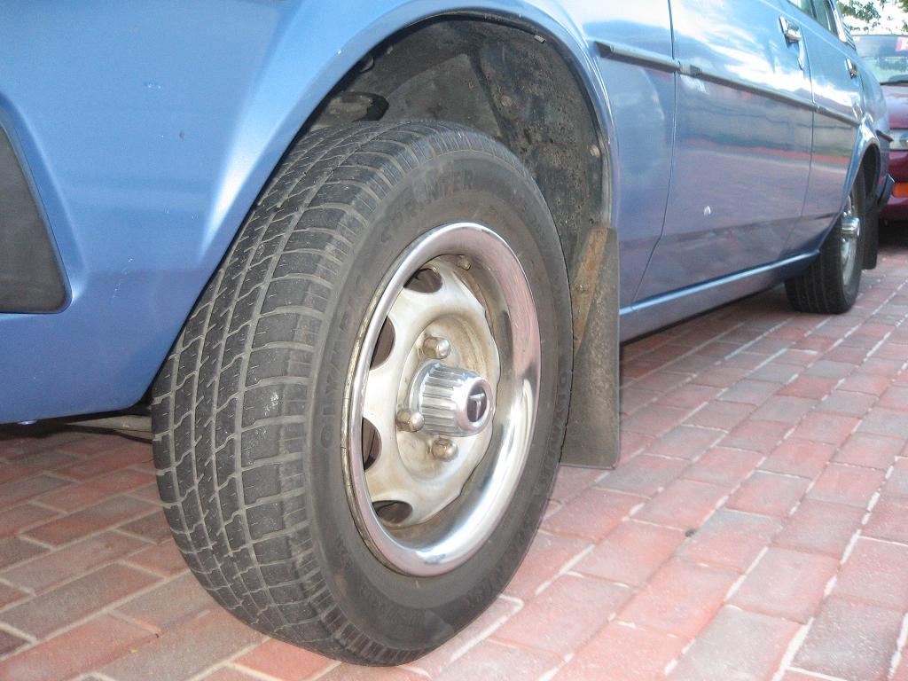

Here are some pictures with the front suspension installed.
post-4793-1201174077_thumb.jpg post-4793-1201174107_thumb.jpg post-4793-1201174128_thumb.jpg post-4793-1201174155_thumb.jpg post-4793-1201174171_thumb.jpg
They're just standard ADM AE86 struts, brakes, shocks and compressed king springs. Soon, they'll have some KYB SW20 shocks in them with 8kg springs.

haha yeah, it sits pretty low, but the rear sierra shocks don't really allow it to go much higher. The fronts should be a little higher once the 8kg springs are in.

hahaha man that sits about as low as mine. i got cuttys all round and it sits 2inchs lower then stock,
the mud guards scrape on everything.

I honestly haven't noticed any rubbing so far. The front springs seem a bit soft at the moment and that would cause the front wheels to rub when going over speed bumps too quick, but that's it. I try not to go over speed bumps quicker than 5kmh. haha

8 inch zero offset will need some decent gaurd mods on a xe7x. I could only just get my 15x7, +1s on the rear with some serious heat gun and hammer action. Yours will be half an inch wider outside the gaurd if you get 8'S in the same offset. They'd fit an ae86 easy enough, but not a ke70. Are you gonna run flares? If you just want to lip the gaurds, Id get 15x8, +12. Should fit under nicely.
I personally found the sierras to be too low and hard for my purpose. Possibly the worst feeling shock Ive tried to use in the rear. I am looking for traction though, if you just want a go kart setup you can drift, then they should be fine.
