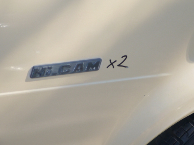

Hi everyone just want to know what HI CAM means when it comes to the ke70 corolla.
Must have something to do with the camshaft in the motor, surely :jamie:
Please can anyone cure my curiosity? :hmm:
Thanks.
