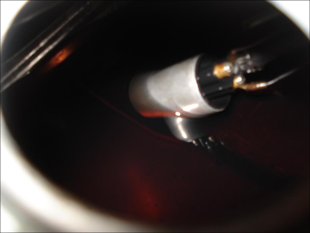

found out my intank fuel pump is working :fuzz: put it back in the tank and still no luck seems that it can't pump the fuel to the surge tank for some reason its funny when i tested it it seem to have good pressure
Try purging it somehow. Easy way is obviously just giving it a suck....but this normally results in a mouthful of fuel. =) 8| Once you've got all the air of of the line you should be right. :P
finally got it :fuzz: had my intank pump wired the wrong way, + to -, - to + so it was pushing air into my tank switched it around and it started sucking and strayed my fuel all over me and my garage (not fun)
here is my pump in the tank, i think it got pretty good pick up as thats under a quarter full
