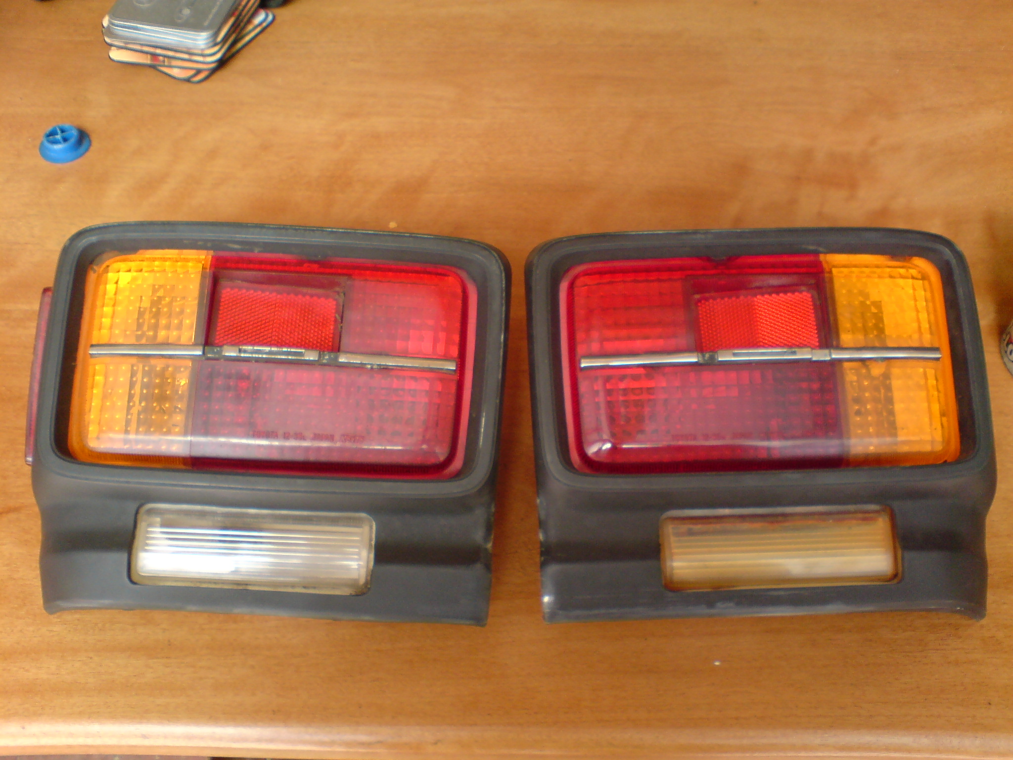

You used VB to Bring a shine to your lights?
:) nah mate, couple of hours of my time and a few selected products makes them come up a treat. i mainly wanted to get rid of the brown/rust colour in one of the reverse lights. They came up better than i thought, pretty havppy with them.

BEFORE:
AFTER:
please do share the secret! shoot me a PM if you don't want to tell anyone but my tail lights are horrid and i am searching for any way to make them better!
