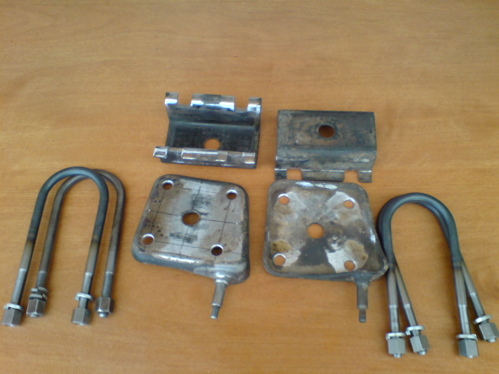

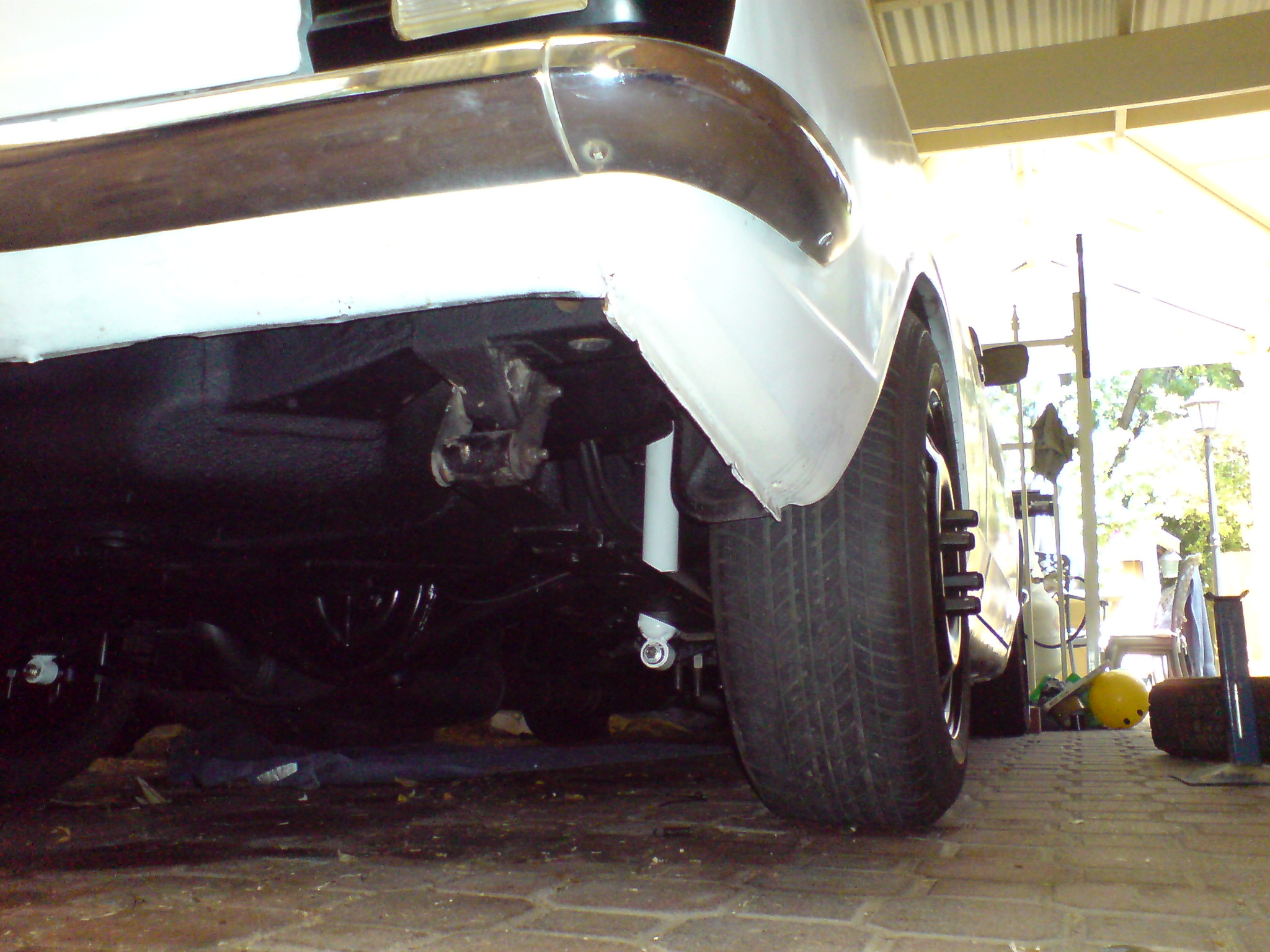

New U bolts, modified bottom plates (old holes welded and new holes redrilled to suit bigger U bolts)

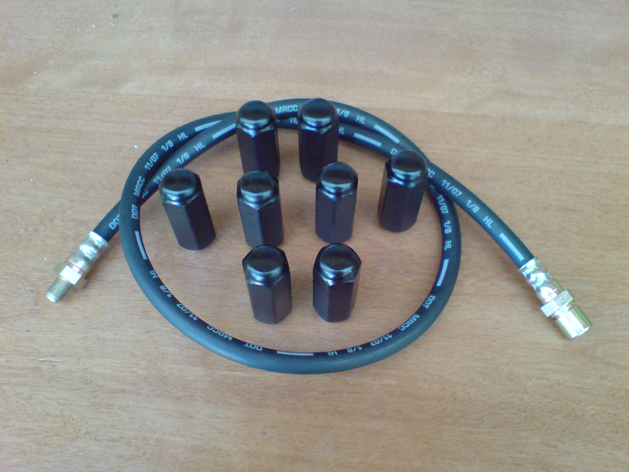

New custom made brake line to suit corolla solid brake line and hilux solid brake line and wheel nuts

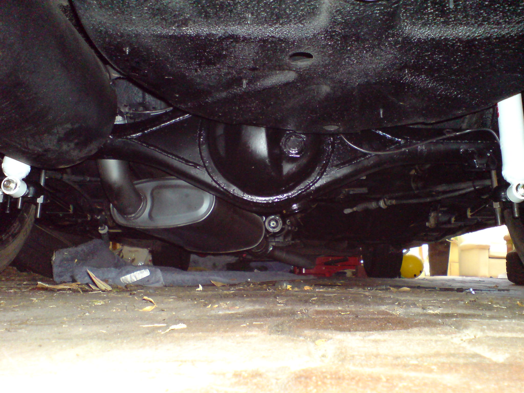

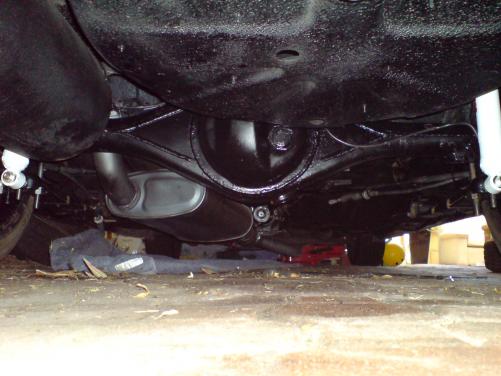

Hilux diff in :P

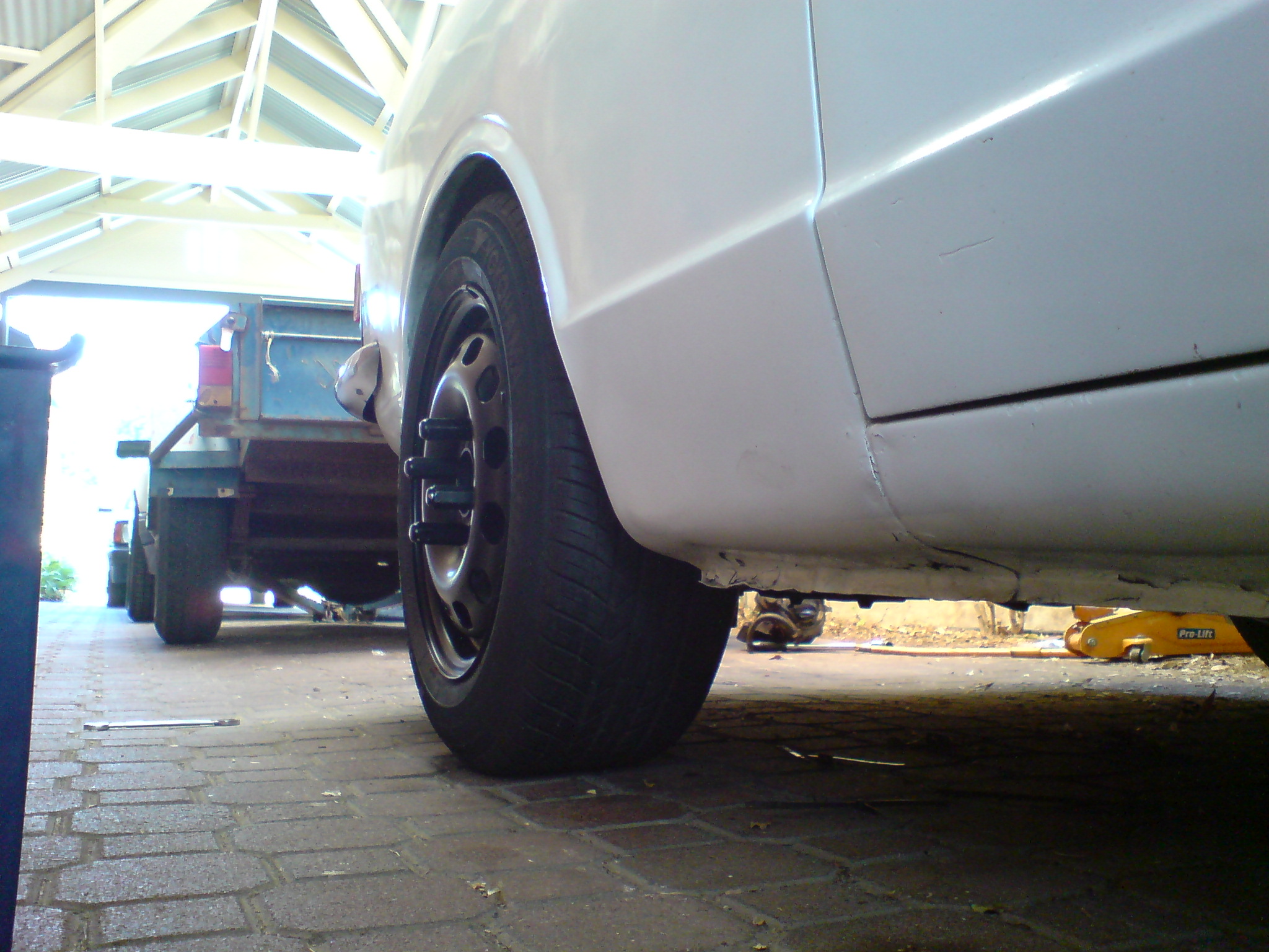

How the wheels/tyres sit, guards need to be rolled before lower leaf springs can go in, new shocks can also be seen.
one more pic
Tailshaft is being pick up tomorow, only needs brakes bled, tailshaft in and gearbox fluid and its driveable again will pretty much be driven striaght to the workshop for the other mods tho.
i have a tool to fold the lip in the guards if you wanna borrow it.
freeeekin sweeet!!! :D
roll ur gaurds, run some stiff leafs and youll be able to drop it at least another 1" without rubbing the gaurds.

getting new leafs made with an extra leaf and a half rebound. guards are getting rolled, ill let ya know if i need the tool but ive got a mate whos a pro at it and will do it for me.
but unfortunately i can't lower the rear end anymore, the diff is only about an inch off the floor as is. Had to take the bump stop out.
