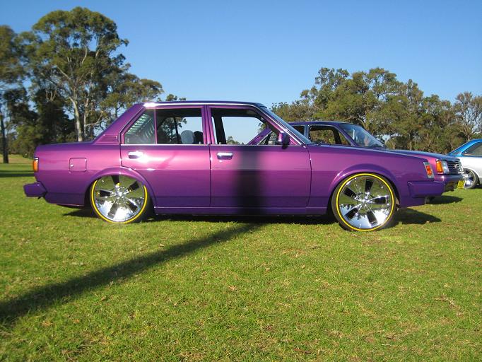

hey there, they will fit if you do a bit of test fitting, 17's will be pretty easy if you get the right offset and low profiles, ive heard some people use spacers on the front to clear strut. rolling gaurds will probly be needed for 18's and up, but i had to roll my guards on my ke70 with 15's, was just too dammed low. i believe this car is running 20's
Thanks guys, the purple corolla has 18'' wheels not 20'' but they do look huge, mostly because its so low.
id like 18's but 17's might be the go.
