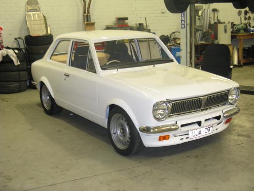

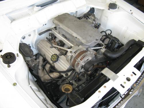

yeah it will be a fun little car especially with the hot motor. i reckon std engine it should see a high 12 and hot motor will see maybe low 11,s. but its not a drag car its a street car that il probly drive every day.i was trying to fit air con but engine mounts get in the way of the pump. ive got a drag skyline which should see in the 8second zone very shortly so this is just a bit of fun. ive put the flares to allow for wider tyre size i can fit around 235s on the rear. and yes the front apron is staying. it will look much better once its all painted one colour. the 290mm rotors I'm using i believe are peugeot but I'm getting custom struts made with a larger diameter wheelbearings to accomadate for the extra weight. the clutch is cable operated so that was easy, but I'm using a vs brake master which has been moved closer to the inner gaurd for more clearence. i was speaking to another guy who does head porting for some speed way cars runing v6 ecotecs and he says its possible to get close to 400hp at around 7000rpm with the right head mods (and other supporting mods). it will fly then, 850kgs with 400hp and massive amounts of torque. hold on.
