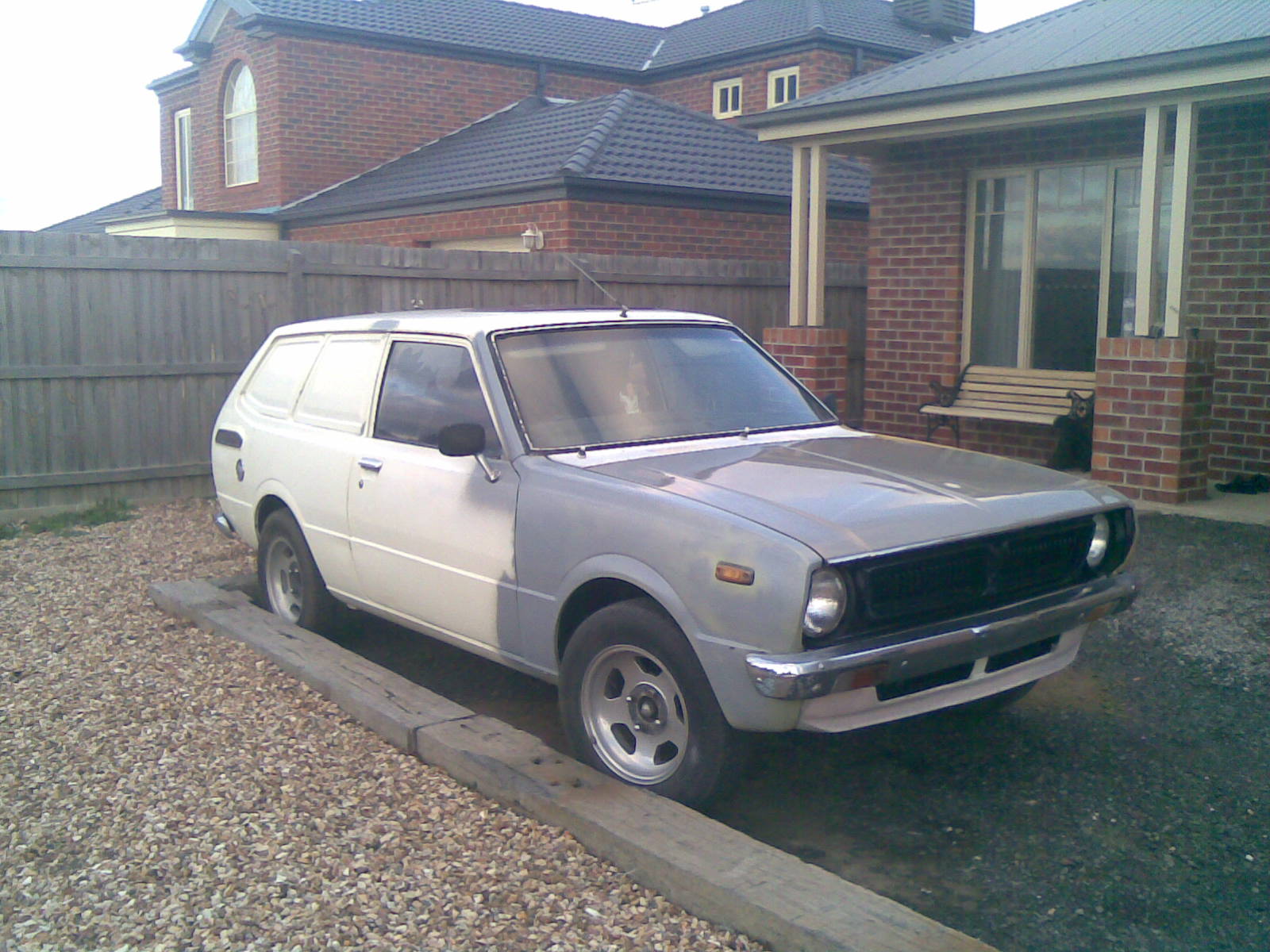

Here's what it's looking like at the moment for now
I haven't seen ONE pic of the rear end of Ollie!

I will post up a picture of the rear later today
Cheers, Josh
