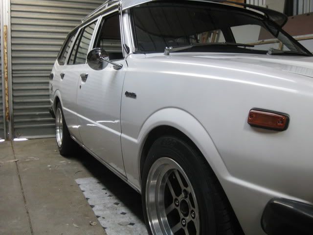

Thanks, I'm very happy with it although its not THAT clean and more will be done to really clean it up in the future. Some body work and fresh paint would really make a big difference..
Chillin- I ended up going with 175/65 all round. No clearance issues so far but I haven't really driven it much yet because its out of rego..
Tonight actually I'm going to get my log book for historic registration. It will be good to drive it again with the new rims :cool:

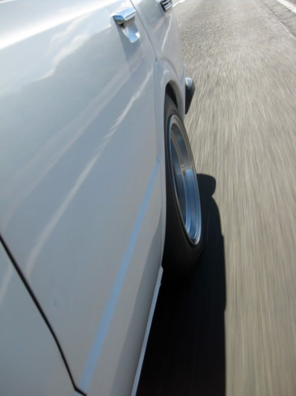

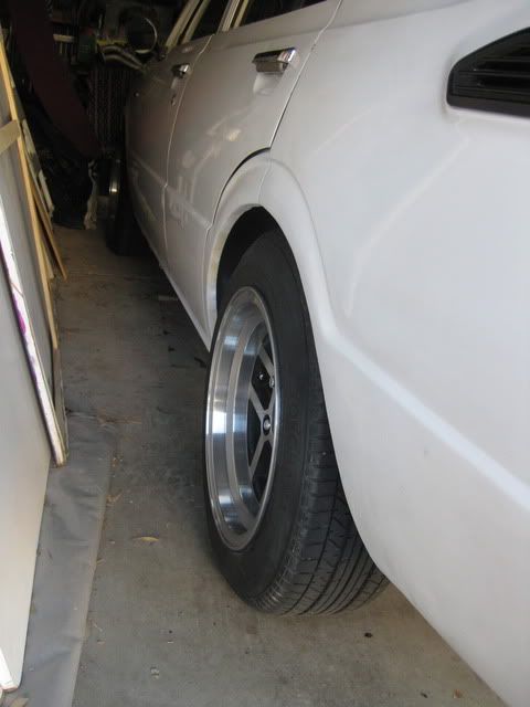

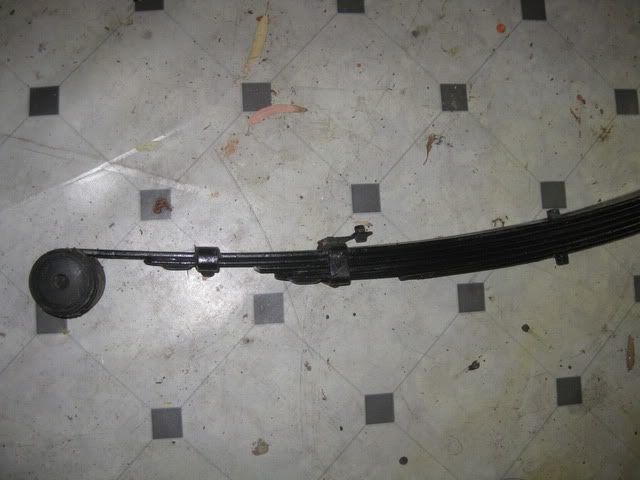

Put my reverse eye leaf packs back in after adding another leaf, theres now 6, the bolts holding the spring pack together were only just long enough. Also put some fresh bushes there... nice and firm now, just right, and now I can actually put stuff in the back and not hit bump stops. With the old shagged standard height ke30 sedan ones in there, with worn bushes, it was a pretty bad. I was hitting bump stops with the weight of a full tank of fuel! Next thing for the rear end has to be shocks because the ones in there now look like they've been there since 1979.. I also picked up a rebuilt 3k carb off jono1986, cheers mate, its now running sweet as. It had idle set really really high though when I first started which I thought was strange but now I have adjusted it it idles super quiet and smooth. Heres a couple of pics...
Dude...I had to pick my jaw up off the floor when I saw the photos of this :laff:
Imagine the mess I'll make (drooling!) when body work/paint happens? Looks awesome mate! :y:
Oh yeah Totally forgot that I increased the idle to keep the 5k going....my bad.....Where's the left hand side photo's? :wink:
Edited by jono1986
looks well nice, sweet sweet rims also
Frothing the latest picture, wheels look awesome cleaned up too, my favourite car on rollaclub by far :y:

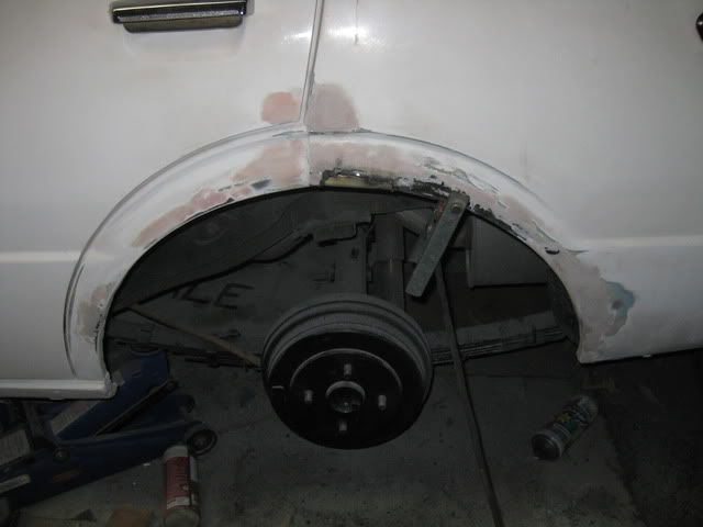

Haha thanks guys! I'm glad you like it as much as I do :yes: The wheels definitely set it off.. But unfortunately it wont be getting painted just yet. I have started doing a few repairs to the body though.. Most recently was the passenger side rear wheel arch. Another few patches welded in.. Doubtfully the last of it either.. :bash: It came out pretty sweet though. Spray can touch up ftw
This was the only process shot i took was already almost done..
Not totally finished but it will do for now..

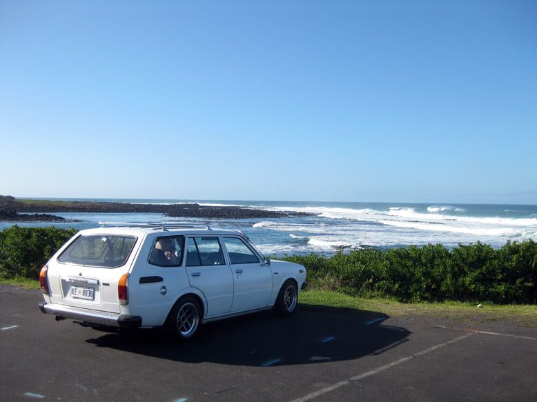

So.. a while back me and the missus decided to do a road trip along the great ocean road to melbourne. We hit the road last monday...
Stopping at various landmarks along the way, we saw some amazing coastline and had an awesome time. This drive is a must do! The old beast purred along and did not miss a beat..
