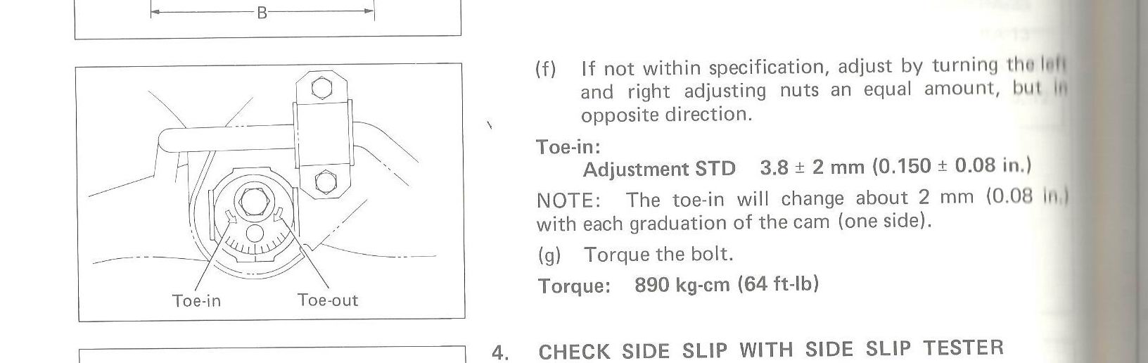

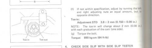

Just thinking about it and the later model corollas use a cam bolt on the rear end
Basically its a washer with an off centre bolt running through it with a "fence" on either side of the washer to force it to rotate in a circle pushing the control out or pulling it in.
Possibility ?
That sounds functional, but getting one thats the right diameter and width is going to be interesting.

I was thinking someone could potentially make something like that in a lathe and use the stock bolt, however the original crossmember would have to have a slot in it and a shouldered section welded on.
Thats about how its done on the fwd corollas with irs
