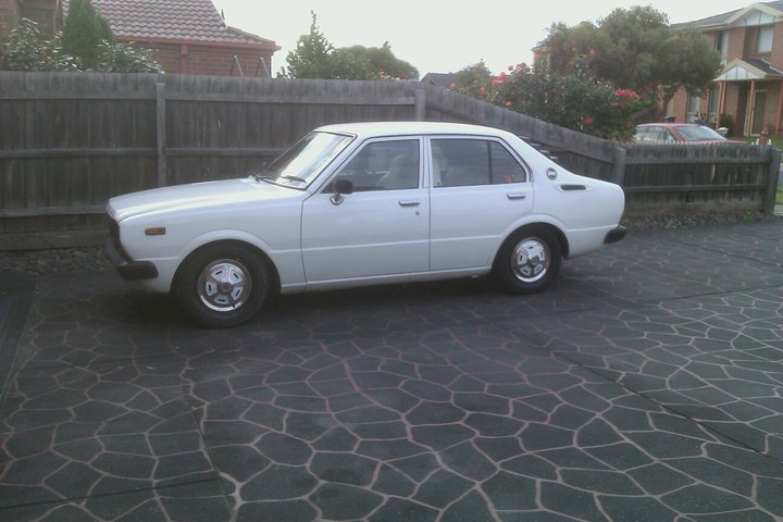

I reckon the white walls are too thick for the hubbies? Need more black in there somewhere to make them stand out more. Use a thinner brush next time you have to repaint your walls? haaa.
White wall is too thick and too far from the rim... car is too white for the look too :)
may as well add my 2 cents haha i wreckon paint the red lip on the rims black... and the hub cap areas which are white paint them black to ... as the cars white and the white wall is thick the black will break it up abit....
ill be washing the rear whitewalls off cause there flaking off and ill take a pic with caps and no whitewall.

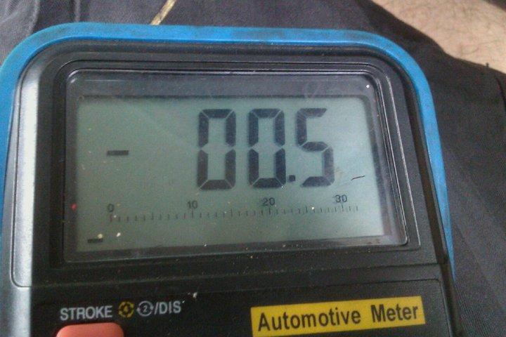

also a/c is in and working. -0.5 degree at a steady 3000 rpm LOL!

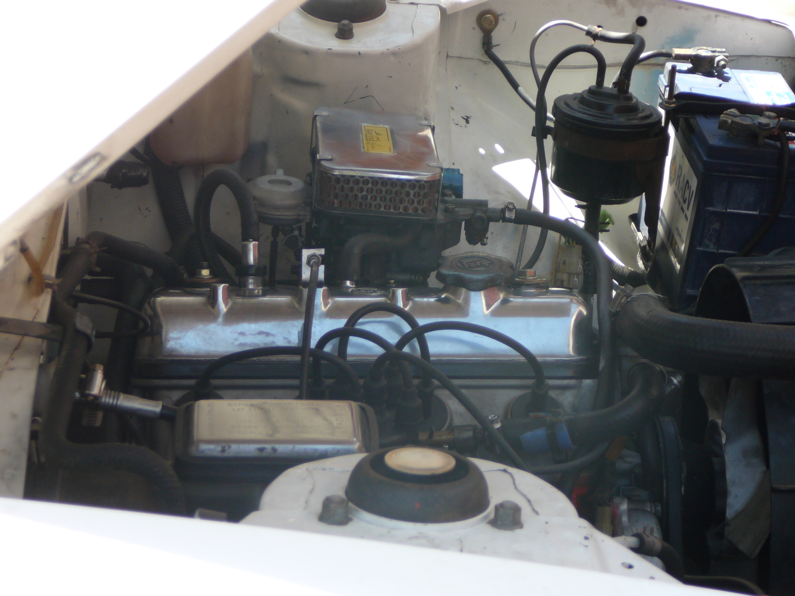

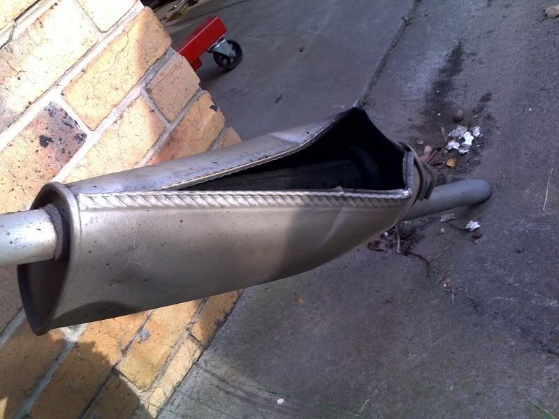

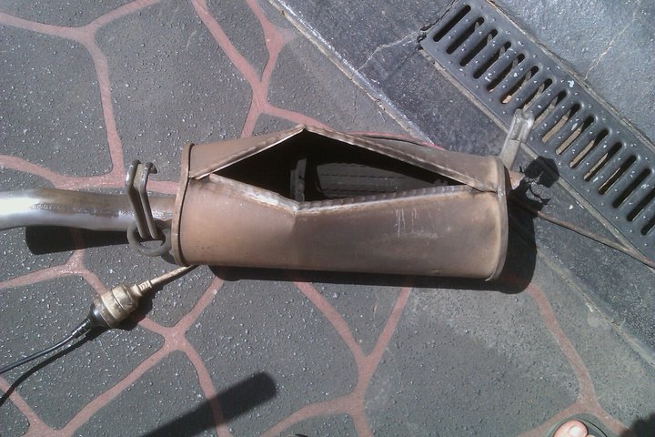

went down to frankston for a cruise last night. saw a bunch of Indian taxi drivers that i wanted to scare the shit out of! done a keybanger and blew another muffler! fml! so i had to drive back to my joint 4 in the morning cops f@$king EVERYWERE and ears almost bleeding!

so went down pick a part and grabbed another vl rear muffler and slapped it on in 2 hours.

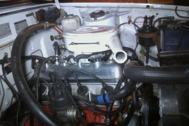

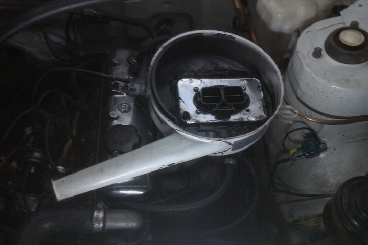

EDIT - i got sick of my weber sticking out like dogs balls. so i modded it so it fit inside the std air box. hack job but looks neat.
Before
During
finished product! what weber officer?
Edited by Evan G
That weber job looks really neat and tidy, Yeah the tiny tack welds on the rims will work, similiar to a "lug" principle.
Your name is Mr Muffler from now on :laff:
Cut some holes in the air cleaner base or around the sides at the back to get better airflow in. Those snorkels are just a restriction.

niice keybang! lol
here was my last effort before i ditched the 4k in my van..
