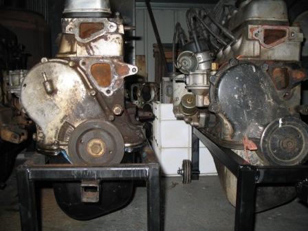

Got a few k series timing chain covers kicking around the shed.
I know the bolt sizes and lengths are different between different K series.
But what is that breather pipe for on some of them and where is it supposed to connect up too ?

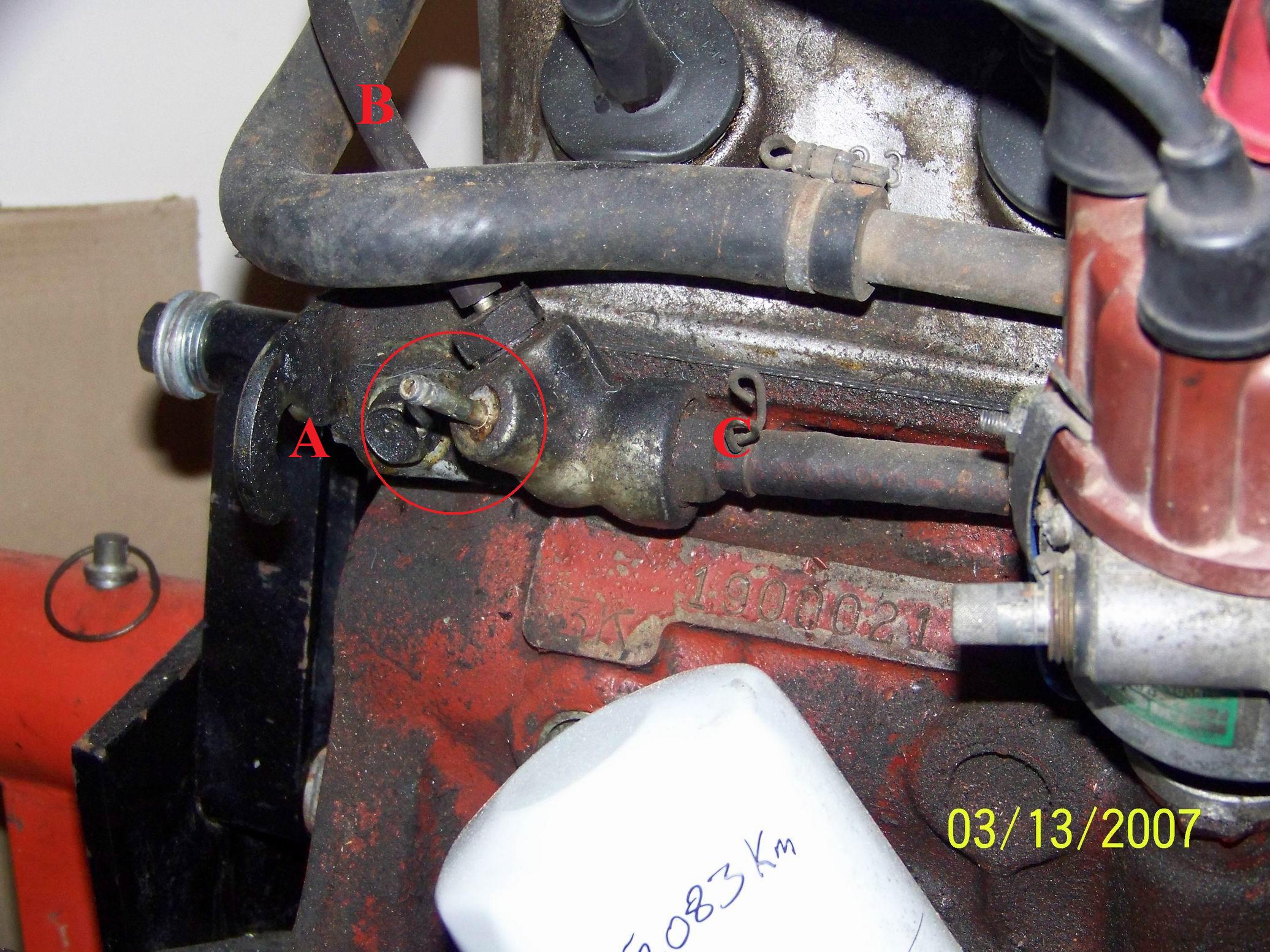

ive seen one on a 1975 ke35 3k 2 speed toyoglide, send a msg to "blktoy" and ask for some pics of it in his engine bay
3K-H
A - goes to the fuel tank evaporation hose, bit like the charcoal box.
B - goes to the top section of the aircleaner box. The cover.
C - goes to the timing chain cover.
My 3k-h had this as well. when replaced with a 5k, which didnt have that hose fitting on the timing cover, the hose was super glued onto the back of the timing cover. Didnt seem to effect the operation of anything so you could say it does two fiths of f@$k all.
