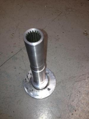

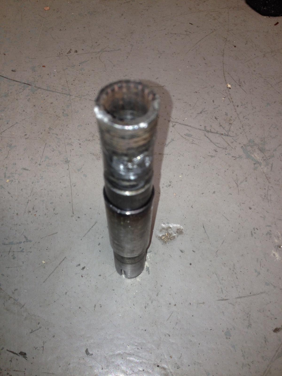

Ok so a couple months ago, on the way home from the classic japan show at como park I had a little traffic light race with a dirty ol dodge v8 ute, that had been weaving in and out of traffic to catch up with us.
With a good launch and smashing through gears we left the dodge for dead only to suddenly loose power just as I was looking for 4th gear. So got it home to assess the problem found I destroyed the blower drive shaft,
Stripped the internal spline out of the shaft. This was originally made as a two piece and welded together and probably not ideal. Oh we'll, you get that.
So I look for someone to get a new shaft made and my first quote was out of control,
I'm told "I need a specific material that's rare and expensive, and then we have to make a 3d image of the spline and a tool to make the new internal spline" blah blah blah blah and that's going to set you back about $4800.
My reaction, as you could imagine, " you've gotta be fu@&!n shittin me" , thanks anyway

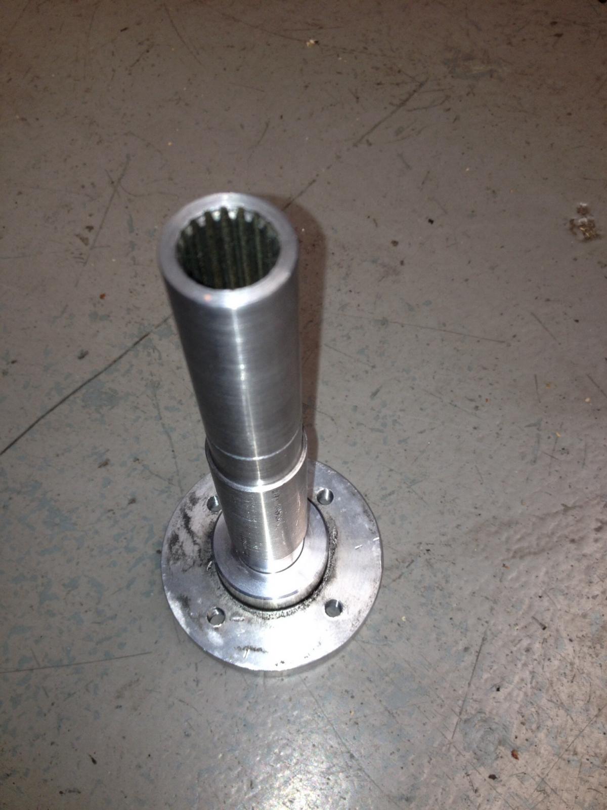

So I find a local tool maker that says leave it with me for a bit, and rings me today with good news.
After two weeks he was able to help me out
Bloody awesome, nice work and a nice bloke all for $700 ,
Now I just have to get it all back together.
