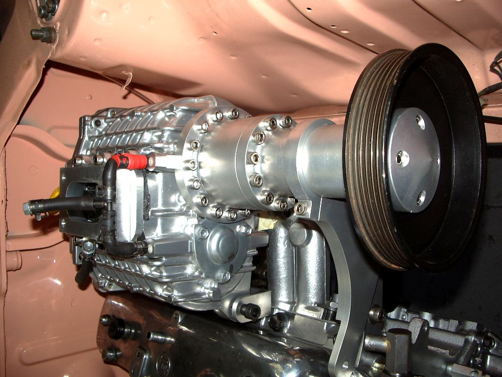

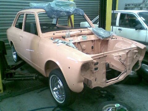

KEI069 Posted August 7, 2010 Report Share Posted August 7, 2010 (edited) Ok so i have been looking around on this site for a while now and i find it quite enjoyable checking out everyone's ride so i thought i would start a thread on this little Ke10 that i have been playing with for the last 3 years. This car is to be my wifes daily driver when its all together. The story started after i sold my last Ke10 that i owned when first met and after selling it we decided that we missed the little bugger, so we went and bought another. unfortanetly i don't have pics when we drove it home but it was white, rust free and 4k, 4 speed powered and that was six years ago. so three years ago we started pulling apart with the intention of a full rebuild. it was taken back to bare metal and had a few small body mods done to clean the look up My wife had the custom colour mixed up and the paint went on there is still a lot to do but it is coming along nicely. The engine choice was an easy one for me and it had to be a K series. my last attempt was a 4K with fuel injection and made 96 rwhp so obviously the next step was to go 5K with a supercharger. This engine work and setup has taken the last 18 months and i can't wait to see how it goes, when i get some more time i will get some more pics up and some more progress reports hope you enjoy and feel free to comment Justin Edited March 30, 2014 by KEI069 Quote Link to comment Share on other sites More sharing options...

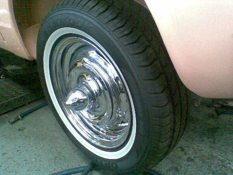

Des Posted August 8, 2010 Report Share Posted August 8, 2010 Looks like fun. What are those hub caps ? Quote Link to comment Share on other sites More sharing options...

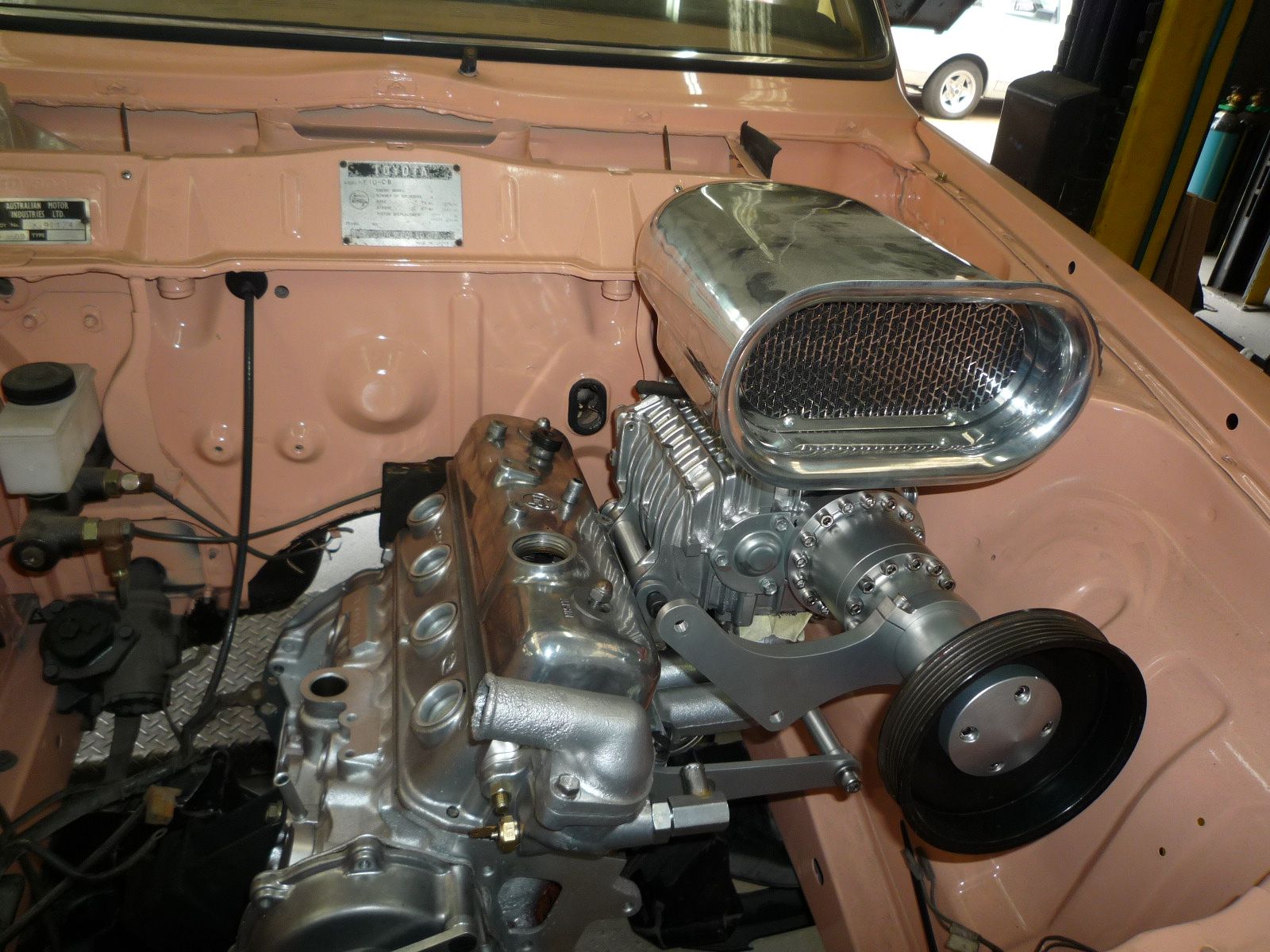

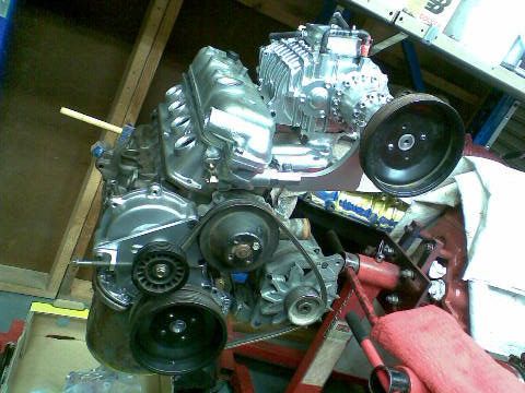

KEI069 Posted August 8, 2010 Author Report Share Posted August 8, 2010 Looks like fun. What are those hub caps ? Thanks for the comments guys. The rims are mazda 13 x 4 on the front and the rears widened to 13 x 6 and then had them chromed. the hubcaps are a hotrod item to fit ford or early chev rims and had to be modified to work on these, their held on with three small stainless bolts And now the engine has been united with Peaches Just gotta get the rest of the driveline in maybe next weekend and make up some new brake lines Quote Link to comment Share on other sites More sharing options...
Evan G Posted August 8, 2010 Report Share Posted August 8, 2010 WTF! I WANT THAT BLOWER! Quote Link to comment Share on other sites More sharing options...

ke70dave Posted August 9, 2010 Report Share Posted August 9, 2010 man thats awesome! great looking colour, and those wheels are cool as. do you have any closer pics of that inlet manifold/charger combo? the ke10 really is a great shape! Quote Link to comment Share on other sites More sharing options...

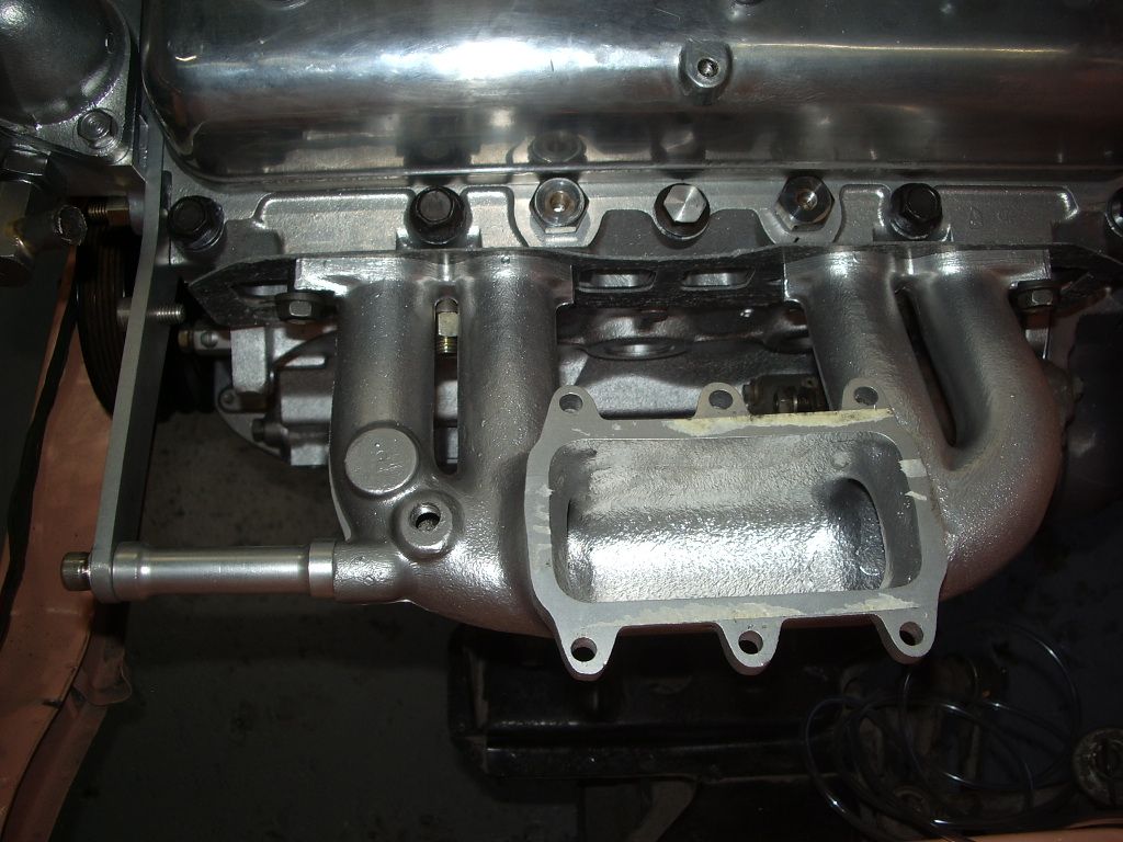

KEI069 Posted August 9, 2010 Author Report Share Posted August 9, 2010 man thats awesome! great looking colour, and those wheels are cool as. do you have any closer pics of that inlet manifold/charger combo? the ke10 really is a great shape! the plan from the start was to go through the bonnet, if youve got a blower show it off i reckon A mate of mine works at a cylinder head reconditioning shop and he did all the machine work which is just awesome. the finish on all alloy parts is aquablasting the only paint is on the engine block and sump. Quote Link to comment Share on other sites More sharing options...
