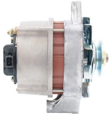

Evan. Will this work with my new Bosch alty from a kingswood (red motor,think the vl's were the blue motor.)
nfi! pull both off. if they look 90% the same then most likey yes.
The front casing is different so you will need to swap the kingswood one for the corolla one, otherwise it wont fit the bracket on the K engine.
Also not all old holdens have the reg unit on the back of the alternator, but I would assume yours does if its new.

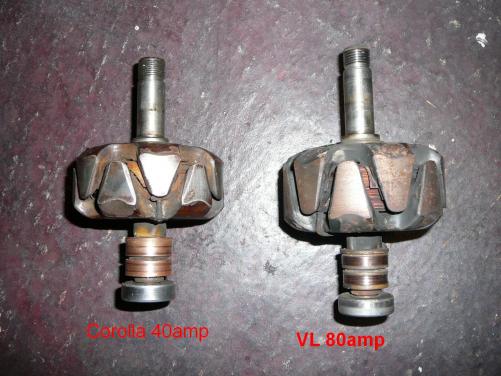

Having a few charging issue lately so seriously looking into this.
So just the clarify E - Are you essentially just putting the corolla front cover on.... and the rest is all VL? Or do you have to swap the VL internals into the corolla rear housing?
Cheers,
Si.
Pretty sure it's the VL internals swapped into your original one, then upgrade the charge wire or something lol
Cheers, Jake.
Cheers,
Si.
correctamondo! corolla front cover, rest vl (stator/field windings rear cover etc etc)
