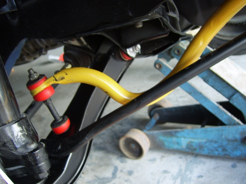

Connected up front sway bar link pin assemblies;

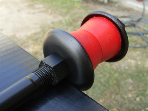

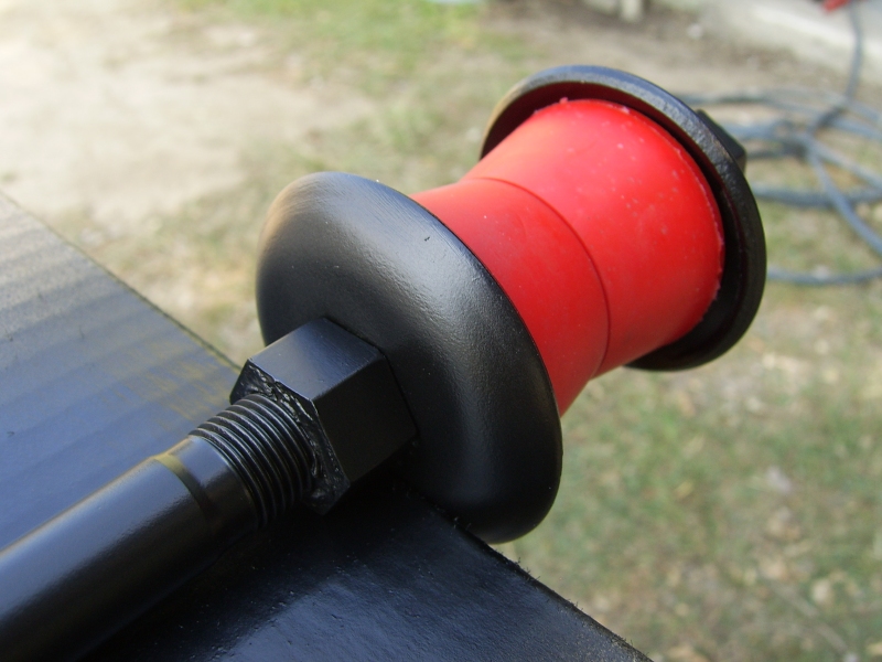

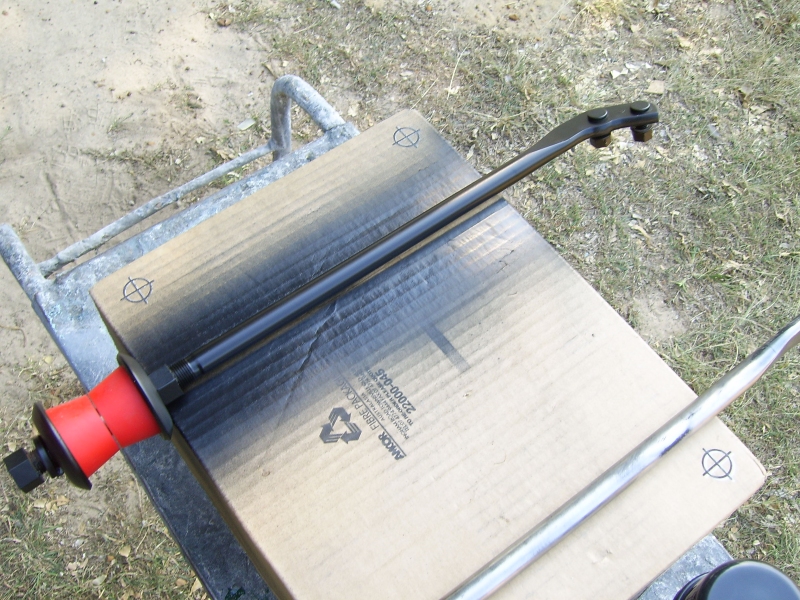

Cleaned up, & installed caster bar's (& new bushes) onto car. Wow, what a mole of a job that was.. right wheel on, jack left ball joint, jack up car in middle, put on nut, reverse process, more load on car, let ball joint down.. ughhh etc. After 2 hours or so, it was all completed. Wow, Suspension work is all _ DoNe !
Also, went outo zee shed and found the Fuel & Brake lines / hoses. Taged & de-assembled all the lines, started to clean them up. All up, theres 4 lines grouped. 1 is the rear break line, other 3 are fuel lines (Main, Return, Breather?). Brake line is getting painted bling bling silver, and other 3 fuel lines are getting done in gold. I'm also painting the 8 mounting clips & the 10mm bolts the same bling red as the red used on the motor / pedal box pedals. Also painted the FR brake junction box black.

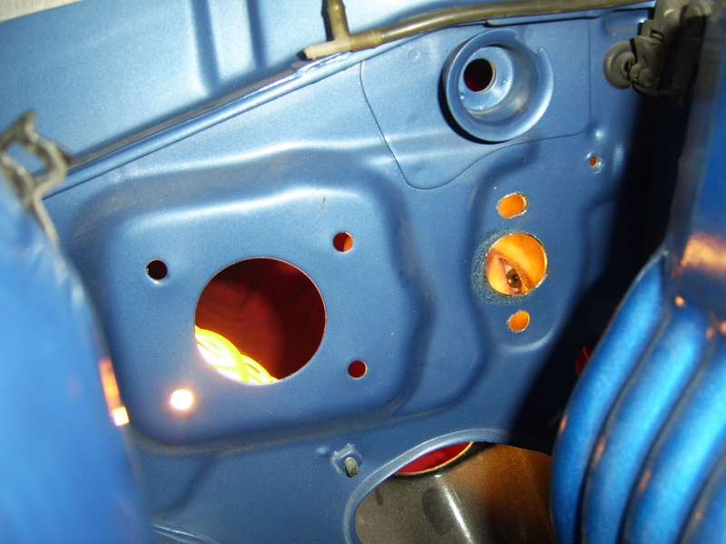

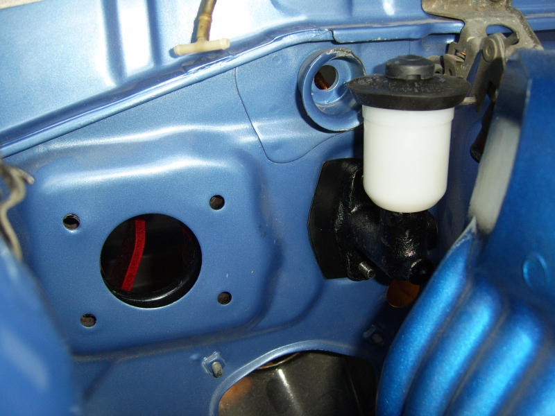

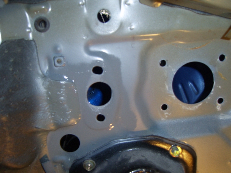

Also, Hole was made in fire wall (thanks J!) for the clutch m/cyl setup.

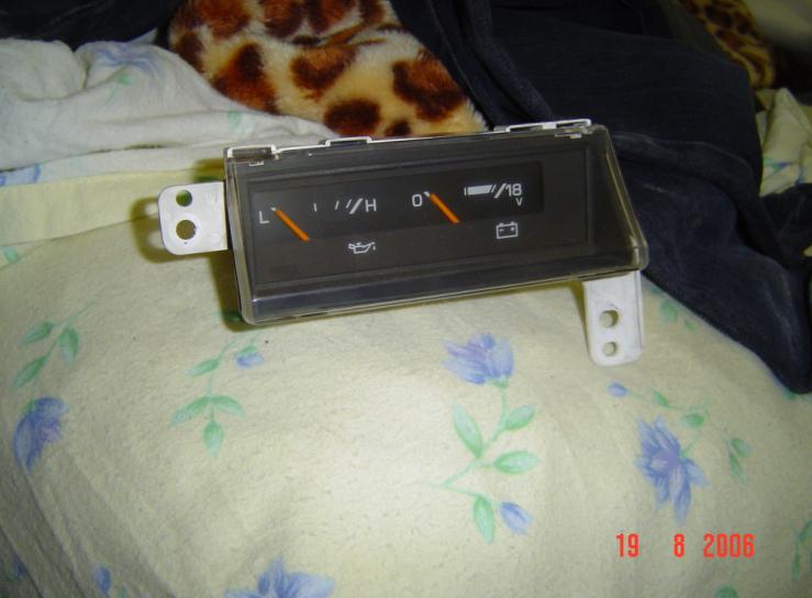

Also, for that pic above ^^ , complments from the boys last night, i scored this cool little assembly from an Ae92 4agze -> using Volt gauge on my dash (yup, you guessed it.. its already striped & being edited ahahaha)
nice work boys keep it up
OOO I LOVE NEW STUFF !!!!!!! hahahha :)

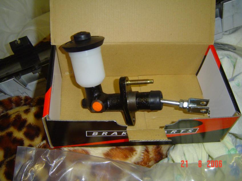

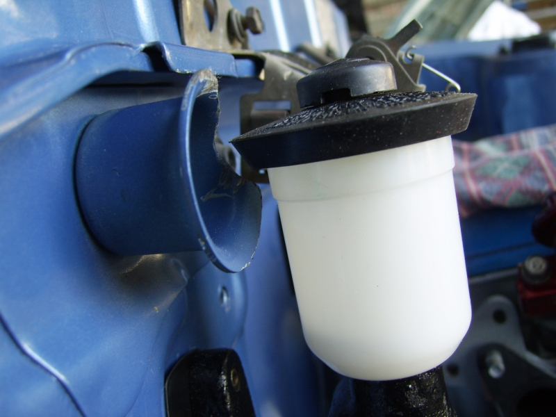

New Clutch M/Cyl :hbang: !

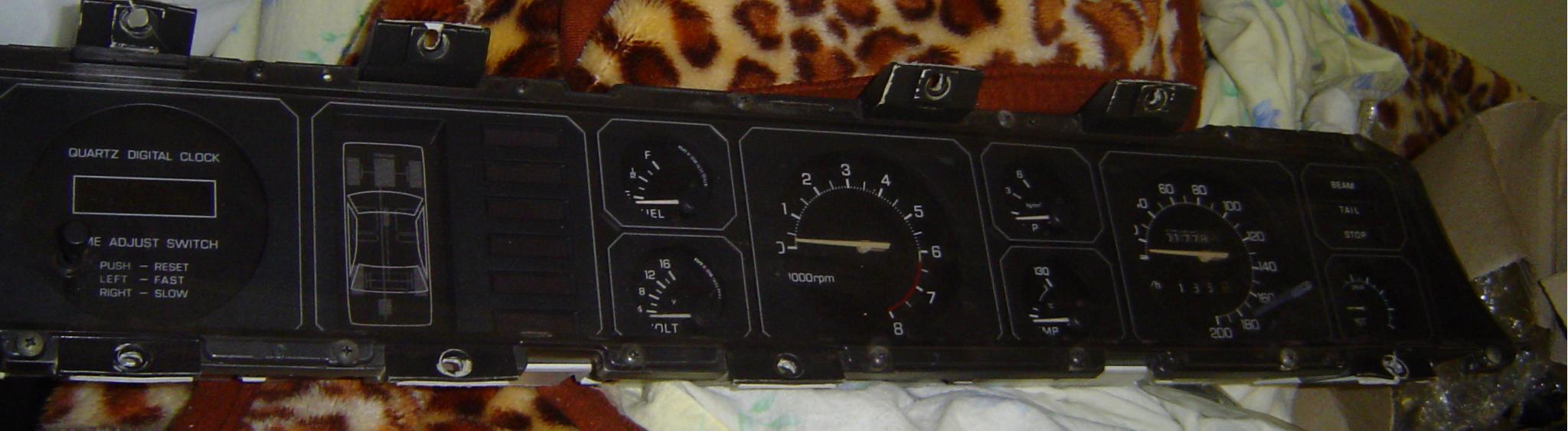

Hahah, that cluster looks awesome.
What is the car outline section used for? Open door warnings, etc?
I had an XD ESP, and they have a grey dash panel, with red dash lights factory (Standard XD's had black dash with green lights) and the red lights looked awesome, they were easier on the eyes than the horrible standard green ones.
Is there a way to change the gauge lighting from green to red on ke models? i noticed the globes are just clear and that the green comes from a transparent sheet within the gauge itself.
are you going to reinforce the clutch master cylinder?
Edited by JC807
I Don't see why it would be necessary when it bolts directly to the pedal box (Will post more pictures later so you can see when it is in properly).

I sanded down another fuel line (taking sooooooo long); weather was getting too cold, so one of the lines we painted (fuel return, gold) started to blush. Will repaint weekend after next (rally next weekend) & by then, theres not much more thats needed for underneath the car!

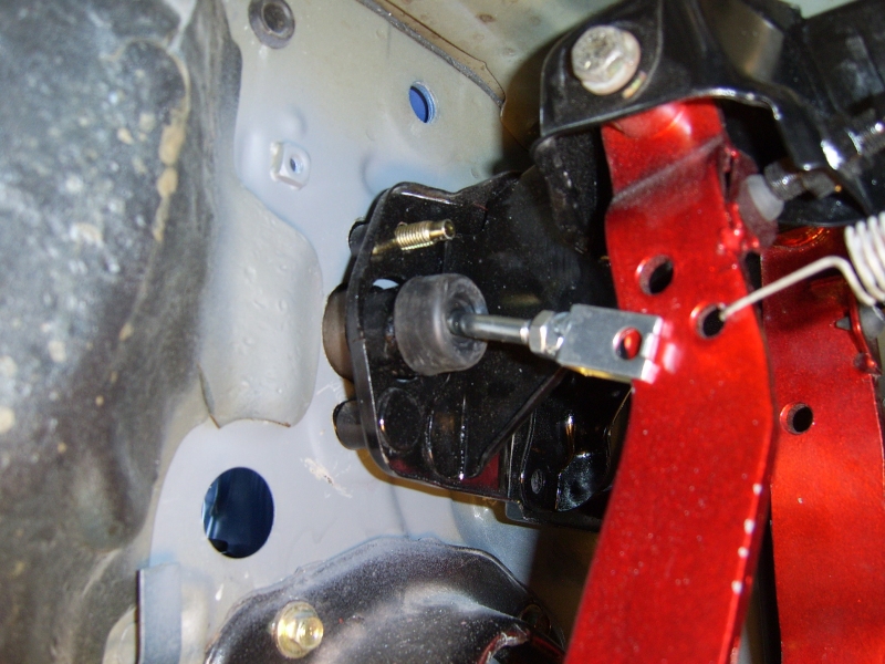

Due to my extreme business last weekend I forgot to post up the latest progress shots. Managed to get the clutch master in the right place at long last! Had to make a little plate to go against the firewall to cover the oversized hole :thumbsup:
