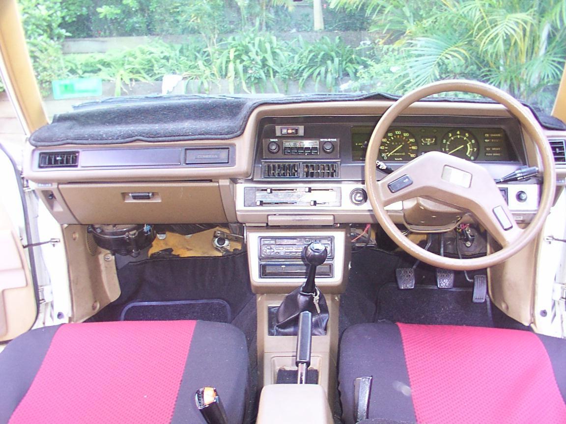

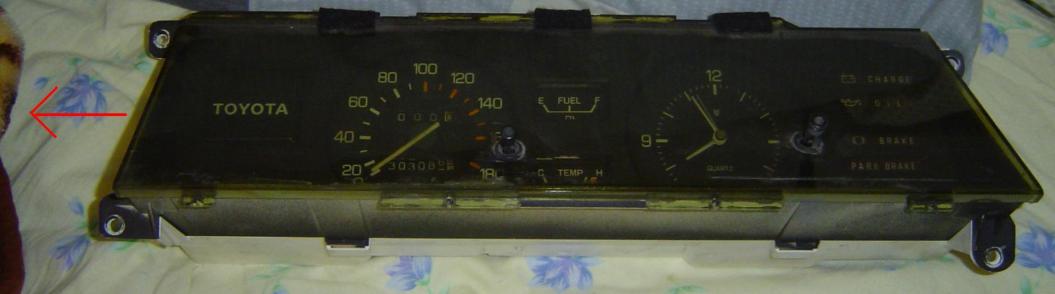

Lets start off with a Stock Ke70 (my white one yeaars ago) - Note the design, spacing and area around the Stock Radio

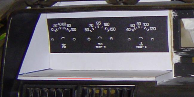

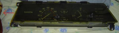

What i want to do, is extend the entire gauge cluster..
All the way to the left of the dashboard assembly - but in such a way that make it look STOCK. Making it look stock requires it to be very non-tacky, and to the finest details.

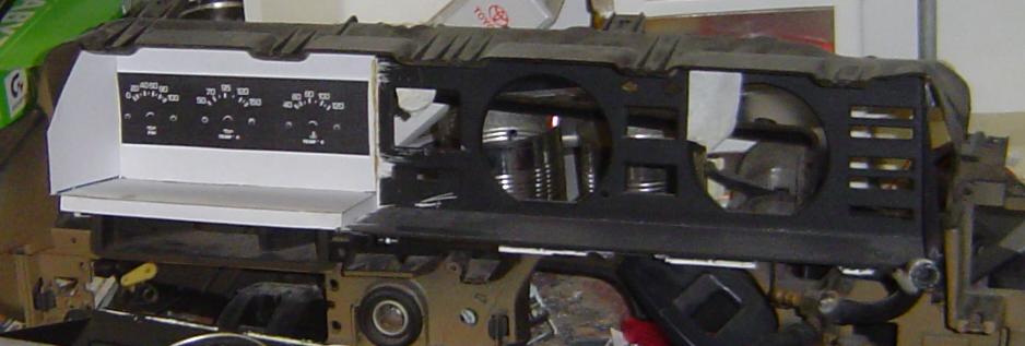

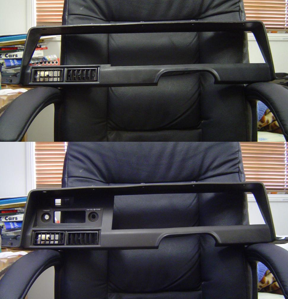

Now that we have that out of the way, Here is a pic of what have done to the surround. For anyone wondering, i didn't use any machines to do it.. was time consuming and fiddly, but not necessarily hard. I used a hacksaw blade (couldn't find the holder assembly, so all by hand :laff:) and some old sand paper dad had in the shed. Not to bad for a first try :P

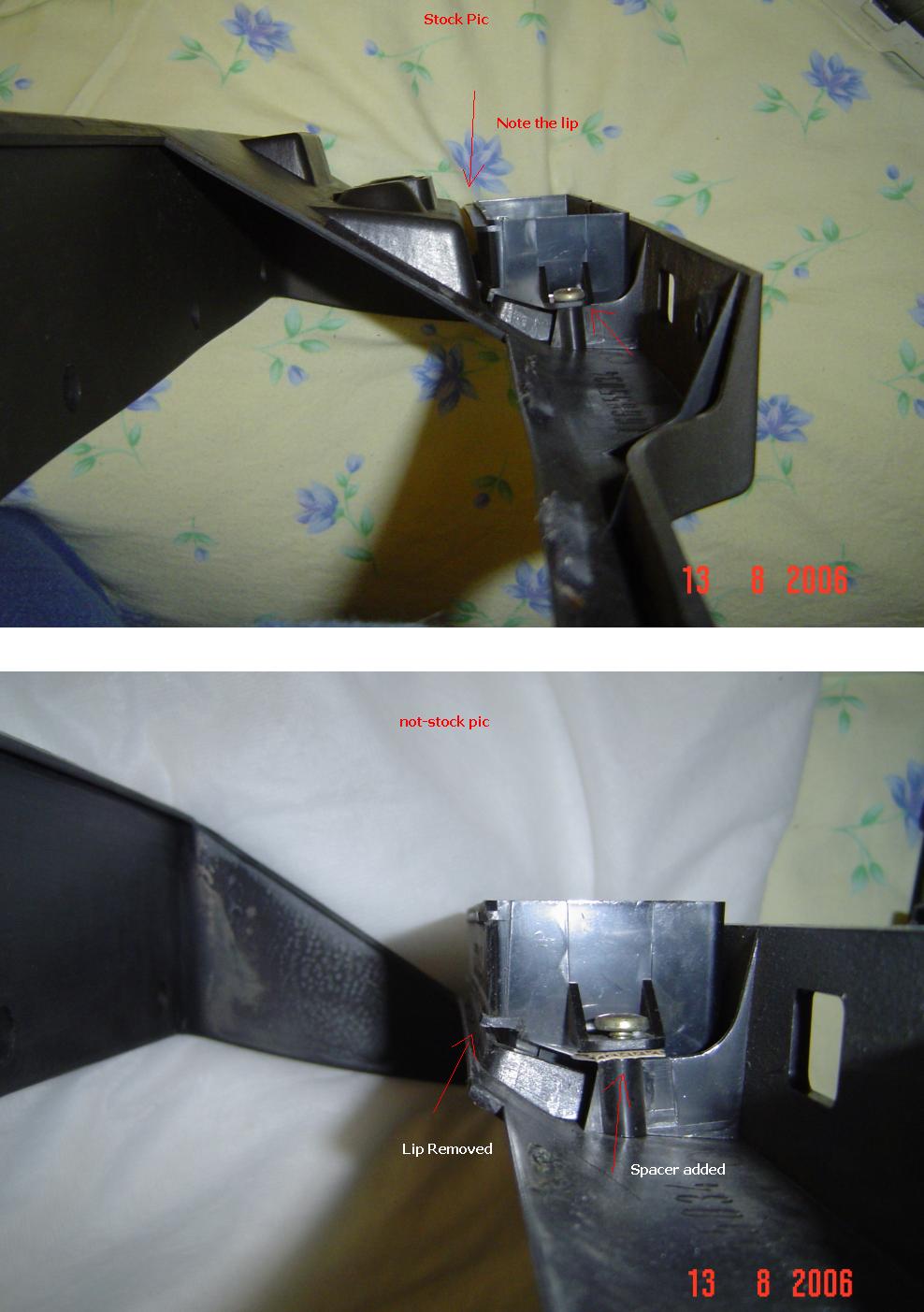

Things i needed to remember, and integrate into the design, was how much space was needed around the extra gauge area for the perspex covering. In the next pic of so, you can see that ive had to remove a lip off the top of the air ducting, and use some spaces to make it sit back 2mm or so, to give more clearance. (ive had it ALL together, including test perspex window, and when i say theres no space left, i really mean.. there is NO space left :P) - The pics !

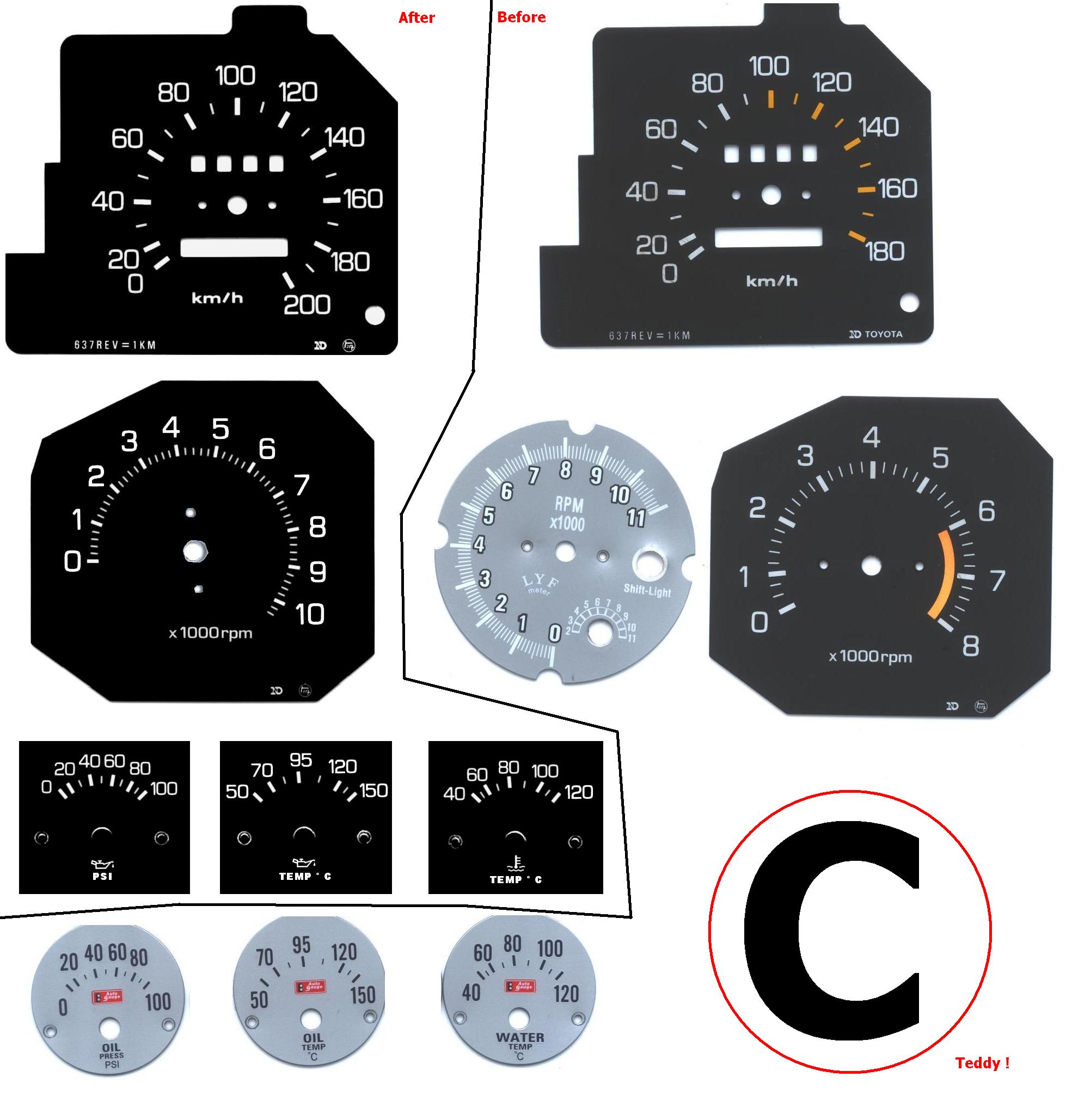

Its at this point i should say i had a gauges thread awhile ago.. in a nutshell, i purchased a 11K tacho, water temp, oil temp, oil press and volt gauges off ebay. They were the cheapest things on the market, and as soon as they got unwrapped, they got pulled apart :P
Remember above, how i said "yada yada 100% Stock?" - well, this means that even the gauge backing must be stock.. = every gauge i purchased got striped down, scanned onto the computer (Add about 15 hours work in here editing them) edited them all, and ended up with these...

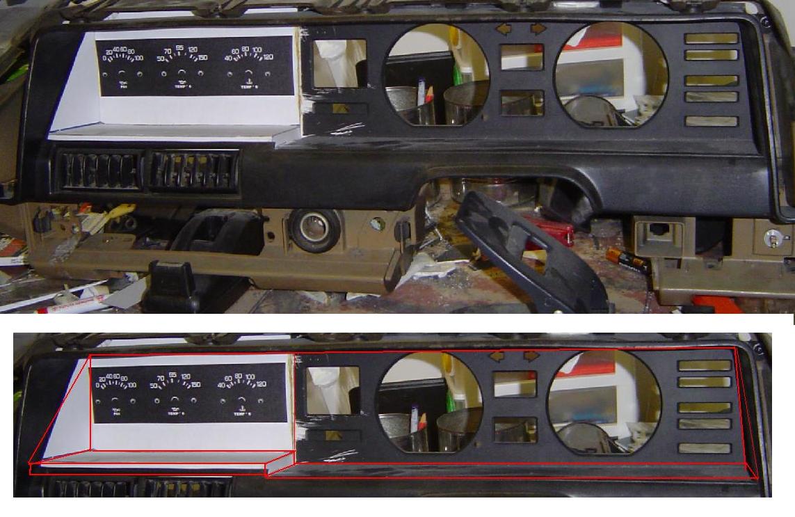

To move things along a bit, i wont bother going into detail on how i made up the left hand side of new gauge cluster design - if you MUST know, its just 2mm cardboard cut & glued accordingly. Its strong, dw ;). Once i made that section, i joined it onto the end of the cluster. Note, i had to remove the left wall of the cluster. Joining these, and keeping them in position was a MOLE of a job. This is what it looks like...
Now, add the cover, and this is what you get...(outlined a carbon copy section in red, so you can see the lines)

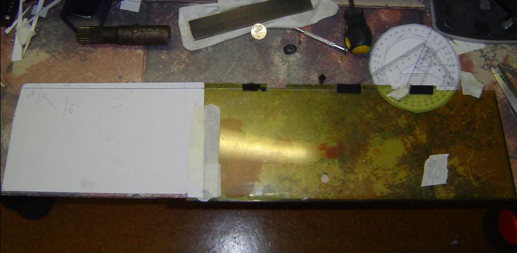

Now, you can't see it, but on the new gauge section, the piece of car board that has the red line on it (see pic below)
fits Flush into with, in front of that air cont duct lip that i hacked down earlier. In the area thats left, which isn't much, thats where the plastic perspex window sits!
Heres a pic of the design of the perspex cover that fits over everything. Note, this is 1/2 the reason why i needed the spacers on that air duct above - the perspex, as well as described above. Ive still got to get a CSX cluster, and do some measurements for the digital clock hole, as well as a few holding tabs... Once thats all sused out, its off to get made by a bloke i know, who does perspec's stuff !

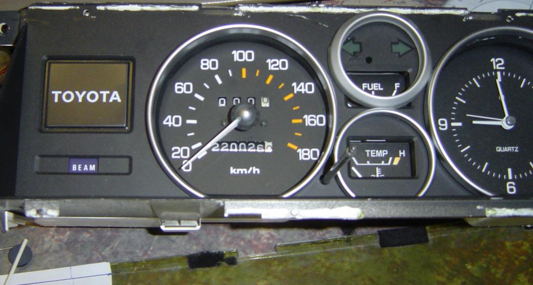

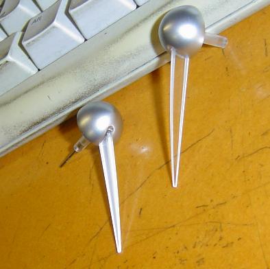

A few more points to add to all of that - I'm using retro needles from a jag XJ90 ? - thanks Volvo friend, X Warranty :laff: - they are so cool !!!... - the ones for the other gauges have like 1/2 size pointers, so its all matching!
Also, I'm getting some chrome rings from the UK to surround the gauges.. they wont be as high as that in the example pic, and will sit in alotmore more flush with the design. What you see here is what i got off the jag console... (just a slap together for an example pic, on a non-tacho (S / SE / CS) cluster) - Let it be noted that the temp gauge (bottom) will be removed, and replaced with a Stock looking Volt meter, and the fuel gauge will be moved up slightly, with the indicators being moved offsett to one another equally. Doing this to keep the sizing and spacement even between the chrome rings. (ooo i can't wait to get my rings :D)

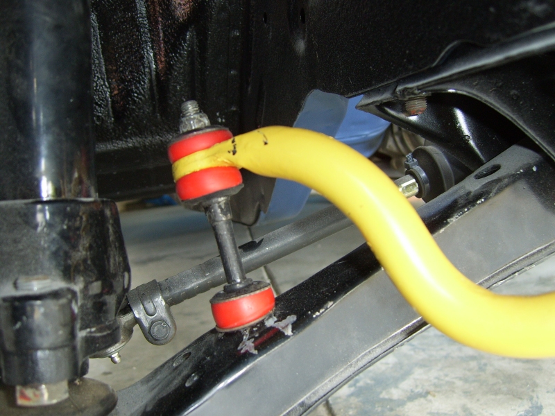

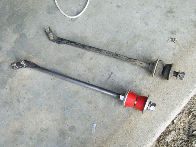

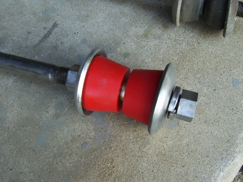

Well, Today was the first day In a while where we got a decent days work in on the KE70 again. Started by getting the Front link pins of the swaybar in to the lower control arms. After that Matt cleaned up the castor bars with a wire wheel so I could paint them black. Once painted the were installed with the new bushes. After that Matt started cleaning up his Fuel and brake lines ready to go back in. While Matt was doing that I was dremeling out the hole for the clutch master, Still a bit off, But I can fix that next weekend when I have some more inspiration...
