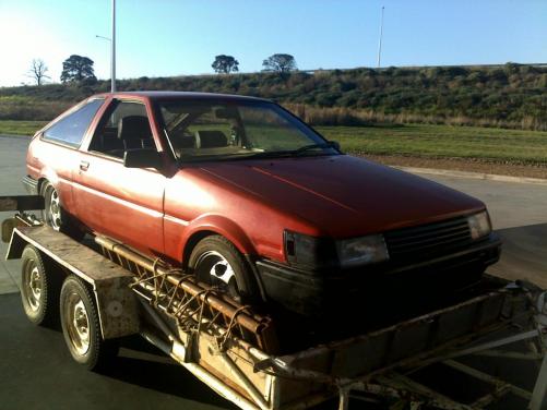

Here she is as I got her. A very tidy example with a few needed rust repairs in the usual places.
It's done a few km's and needed a new diff. Apart from that - spick and span.
Owned by a car-detailer that sold it because he got a AE86. Prior to him it was owned by a Toyota mechanic.

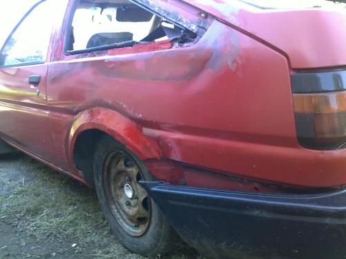

First step for me was to start hacking up the rust.
I stripped it completely and made up some panels to weld into place.
Once I'd done that, I fibre-glass filled the gaps, followed with plenty of sanding and bogging.

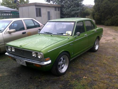

the lights themselves are off an RT104 Corona, which the bases were modified and welded to fit and mount on the rad-support of the corolla.
