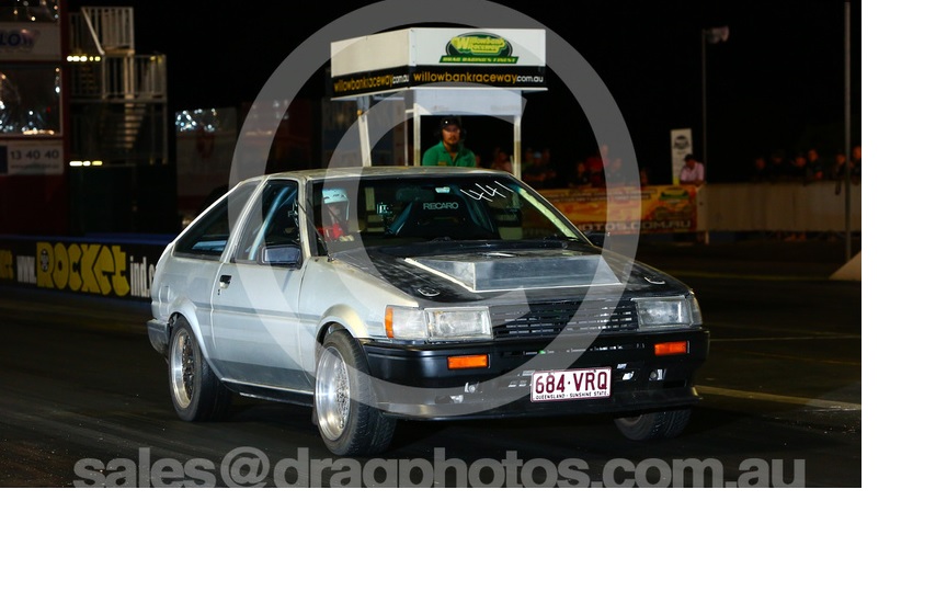

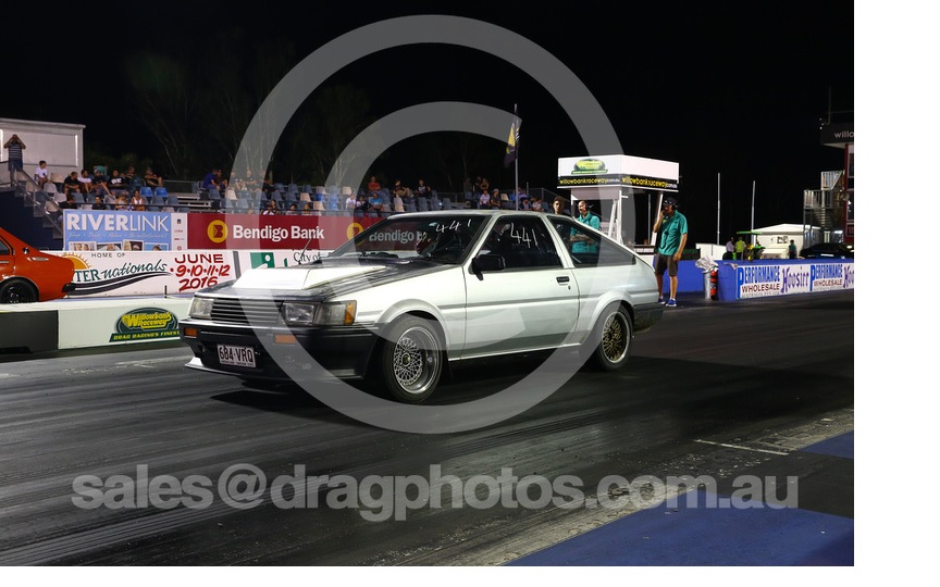

Best of the night was 15.135 with a 2.249 60 foot time. Have to baby it off the line it spins hard if you don't. I'm going to need grippier tyres to better the time I think as it just cannot use all the torque. Also i think if I went to 3.7 rear end it would accellerate as fast but need one less gear change, its geared way short. It leaps up out of corners but sells itself short on the quarter mile.
If you like the current gearing for street use then you could just find yourself a pair grippy tyres that are taller and fix both your drag gripes in one action
