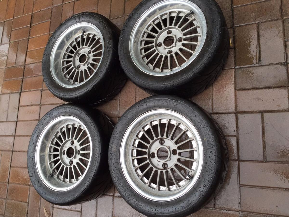

It means a lot that you liked it. I just won this set of 15x7 ssr fins in excellent condition off a guy in Sydney. I should get those next week. 15x7 zero and 15x7 +13. Wanting to run lighter wheels and bigger tyres in the search for some extra grip. Ill probably end up selling my southern ways.
