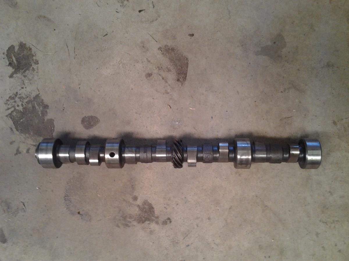

post-17369-0-21595800-1357269722_thumb.jpgBit more work done today in 40 degree heat of melbourne!! Damn can't stay out there for too long, anyway camshaft is out of old motor,
ready to go for a regrind sample , well start on new one when we get all the bits together heres a few pikkies....
post-17369-0-91595400-1357269930_thumb.jpg check out the state of the cam gear after 10 years just sittin round niiice!

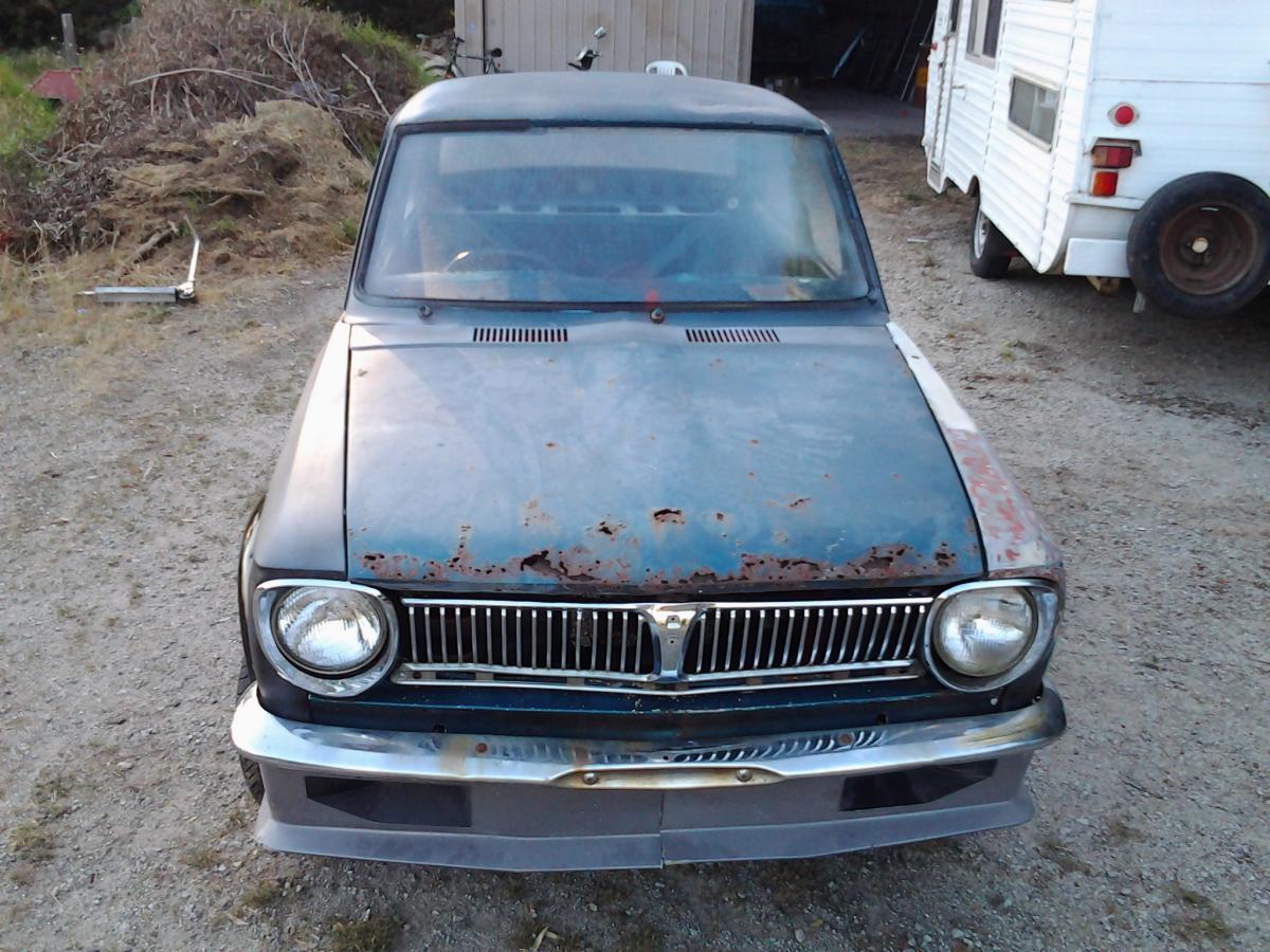

Ok things are comin along swiftly now! fronts back on with a quick test fit of front spoiler setup, for all the purists its just sittin on there not gapped n mounted etc , waddya all think I'm tryin to keep it lookin like a ten but racy at the same time cheers dad ..ps the boy reckons its all good i kinda hoped hed like it , front is a seriously modified TE CORTINA off my mate paulies V8 one yet again LEFTOVERS!!! remember its a racecar folks......
ps PLEASE SEE STATE OF BONNET!!! Help me out rollaboyz in melbourne don't make me fix it I'm gettin tired cheers DAD!!

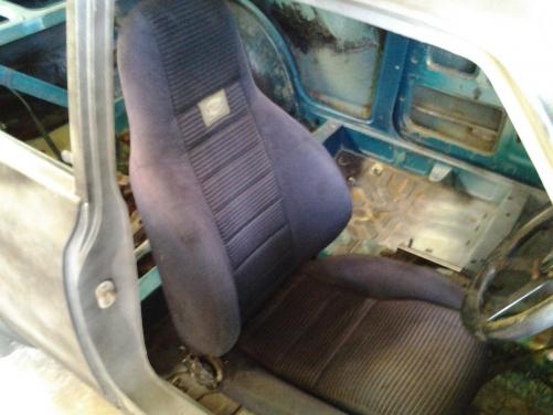

Mounted the old skool race seat today, after many hours rewelding and staightening the seat mounts after previous owner
( well call him" discoboy" from now on) had taken a large bashing device and hammered them down int the tunnel and,
floorpan to fit those ghastly 80s seats in! any way nearly ready for color inside...
