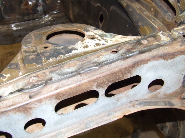

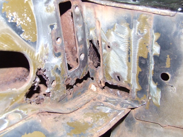

Got some seam welding and rust repairs done today before the storm knocked out the power for 7 hours.

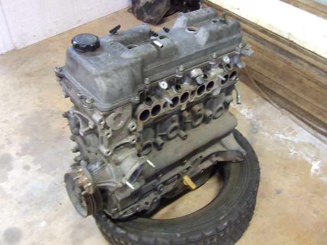

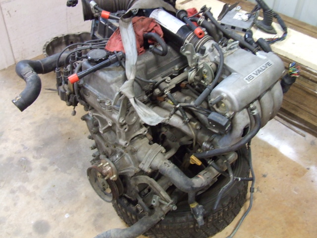

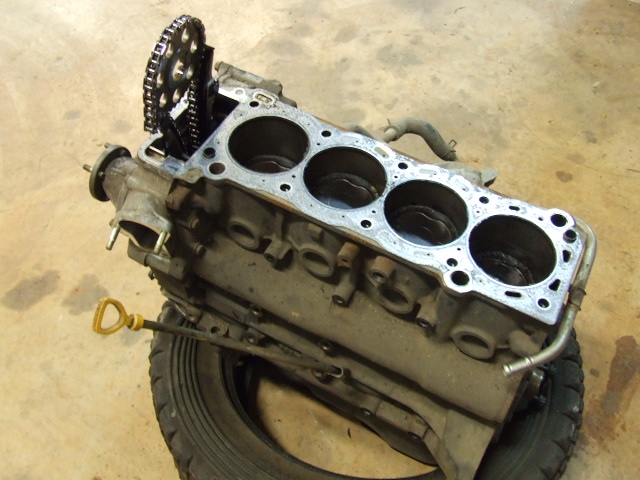

This will be the race motor for the new car. Photo is showing a complete 2.7 3rz motor, but just using the head.
This is going on a 2.4 2rz bottom end.
The 2.4 has a 86mm stroke "same as a 3sge that Mr Bates is using in his RA40 Celica" which will rev better than the 96mm stroke in the 3rz.
I was still not happy with the standard stroke ratio in the 2.4.

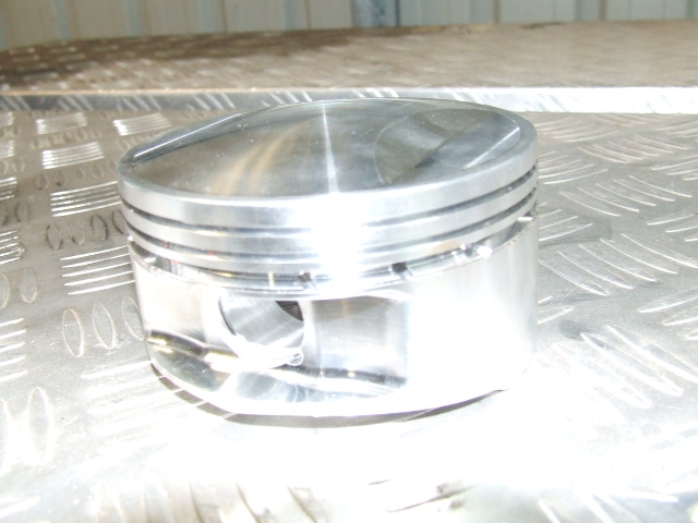

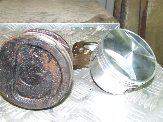

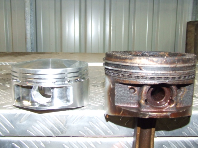

This is fixed by using 2jz Supra rods a Suzuki 1400 pistons.
Suzuki 1400 pistons?
Tell me more.

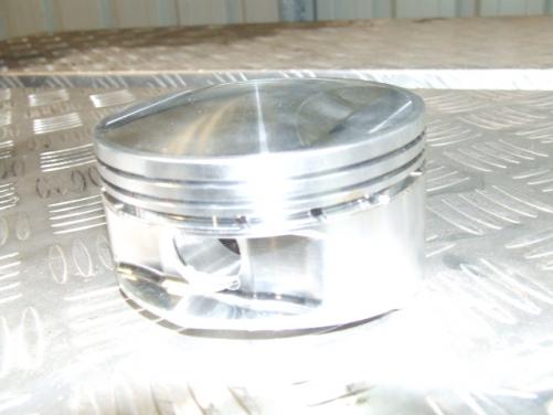

Hi Chris, These motors have quite a low comp ratio, 8.7 or 9.1. as standard.
Most of the forgies that are on the market are made for low comp turbo use for the 3rz.
The bores are huge for a 4 cyl engine, so trying to find 96mm flat tops or dome tops to raise comp was not easy.
To get a set custom made would cost over $1000,
I found these by JE Pistons to suit a 1400 V twin Suzuki. 10.5 comp with a higher pin to suit the longer 2jz rods.
$500 for a set of 4 forgies . 96mm and much lighter than standard.

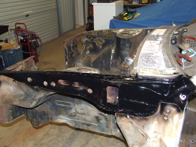

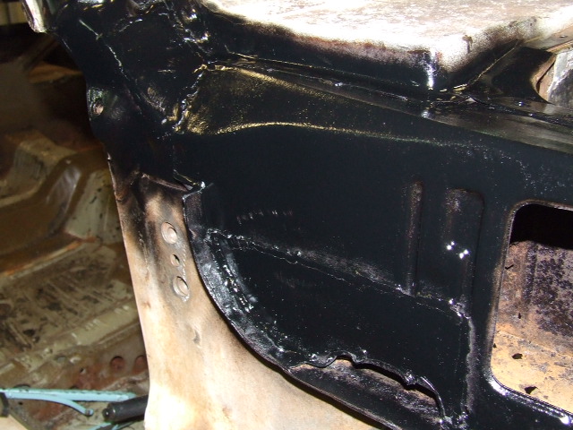

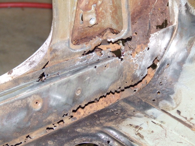

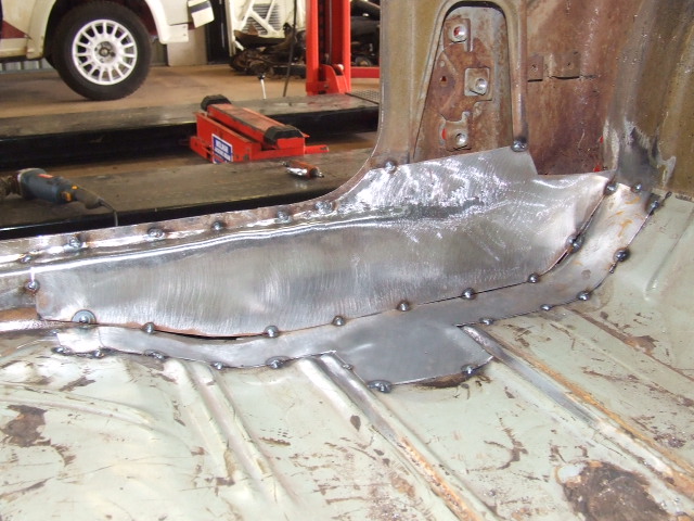

Some more rust repairs today.

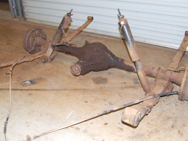

Also going cheap ke30 diff and leaf springs.
Make an offer if anyone can use it.
Pinion gear turns easy and smooth, but condition unknown as its just come from the wrecker.

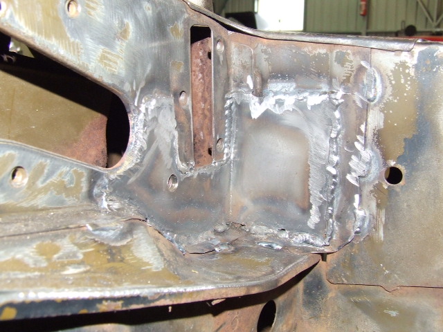

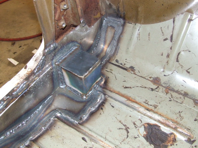

Hi Justin, Only the new sills left to go on and the rust is done.
Got the cage mounts in as well.
