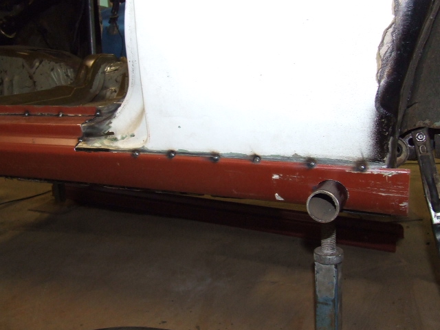

Both sills are on and welded.
Ill finish off the plates for the stand mounts when it gets flipped over for final touches and paint.

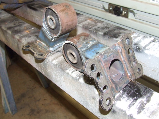

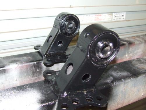

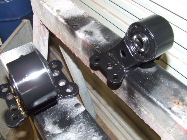

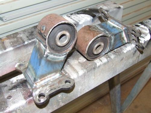

Custom race engine mounts with Landcruiser suspension bushes.
50% lighter than standard and 100% tear apart proof.

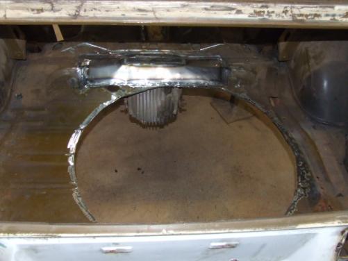

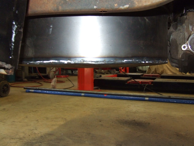

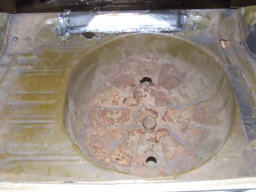

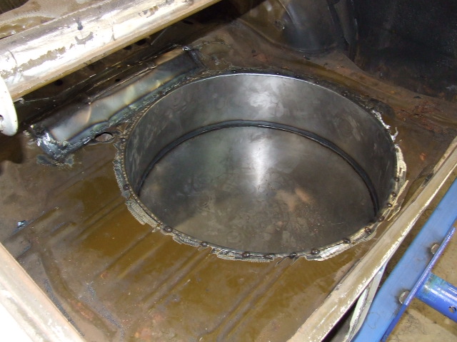

Diff mount is in and replaced the small rusted wheel well with a new one big enough to take the 15" gravel rally wheel and tyre.

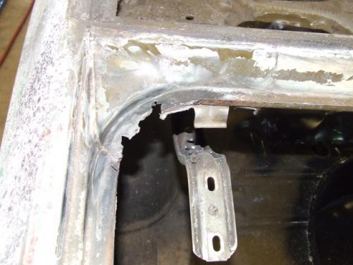

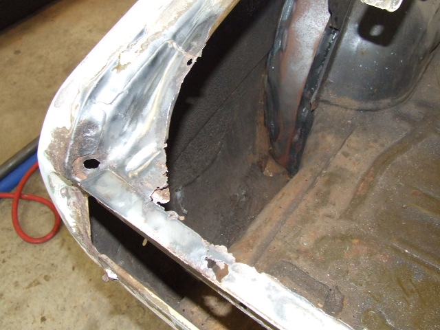

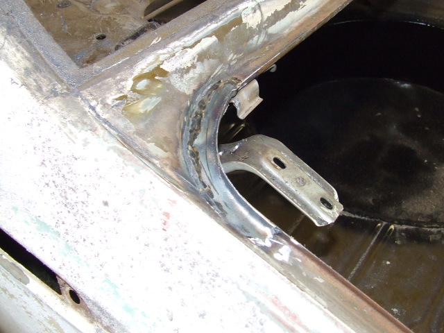

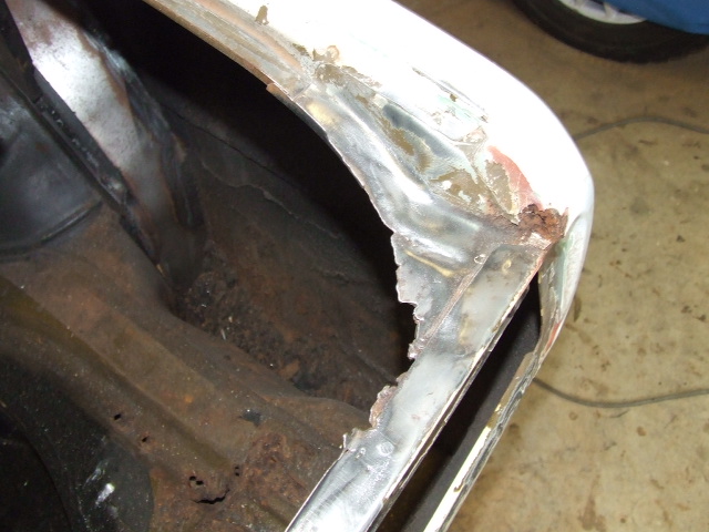

Repairs to the boot seal.

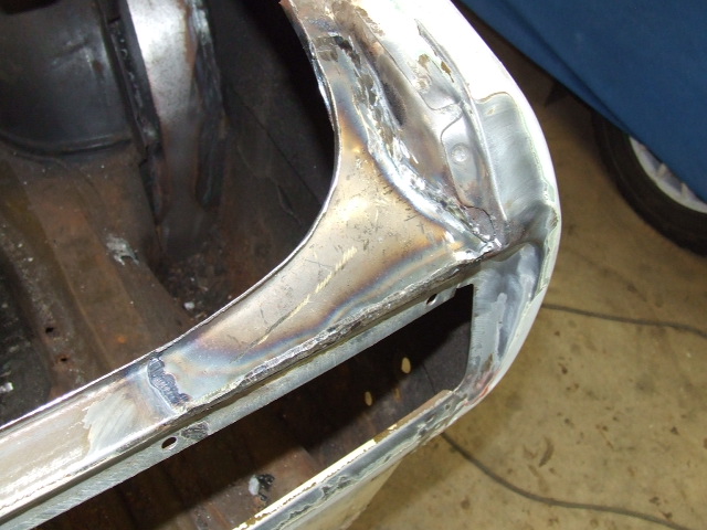

Finished boot seal repair.

Made from new 1mm plate.
