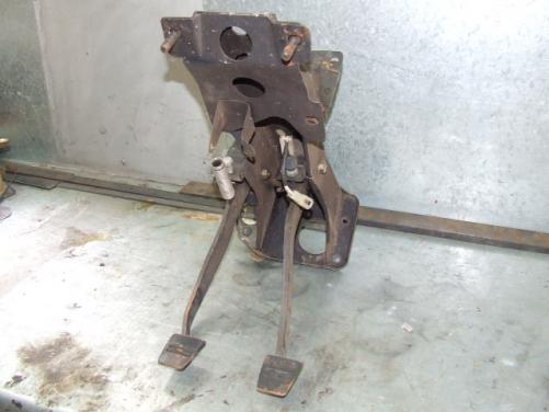

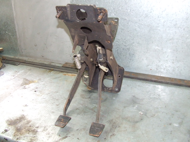

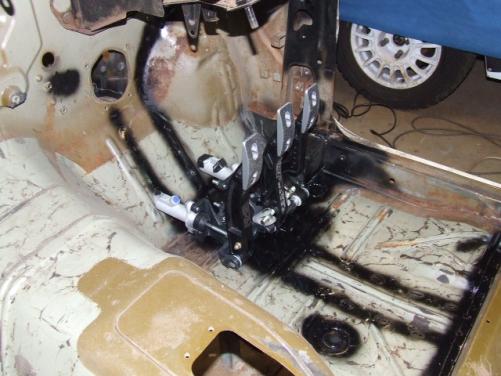

  • Iam amazed at the new aftermarket parts you can get for these old Corollas. The new guards and bonnet turned up today, as well as the Tilton pedal box. Iam building the car to run in AMSAG and the 2

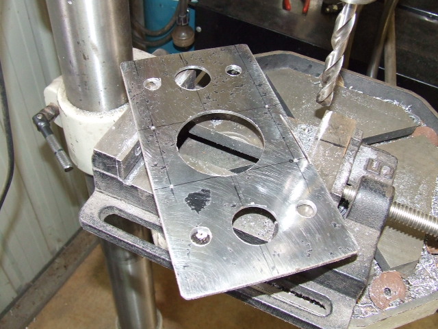

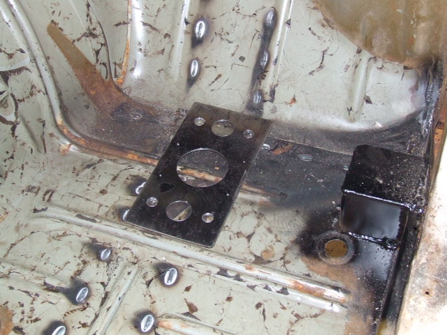

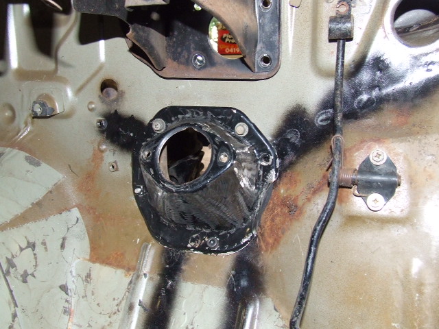

Made a mount plate for the Tilton pedal box.
The holes in the plate take some weight out and allow it to be welded to the body rail under the floor to reduce flex under hard pedal presure.

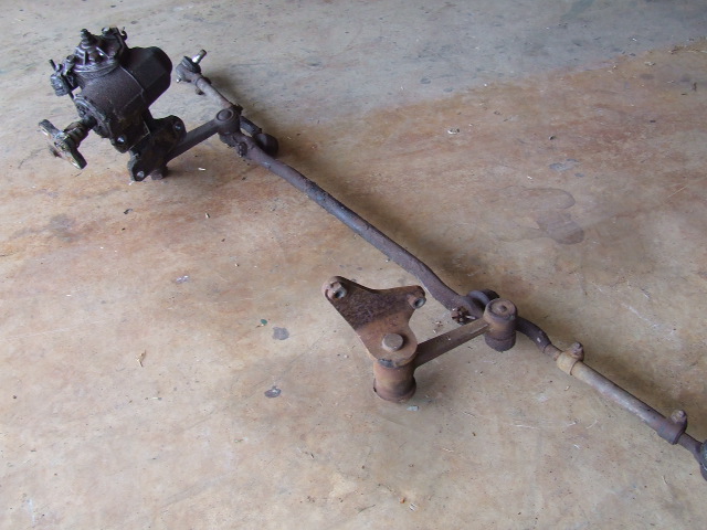

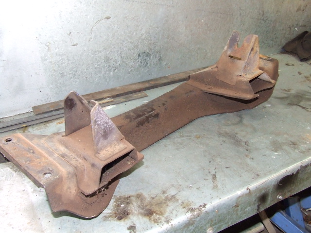

A few more ke30 parts to go that I wont be useing.

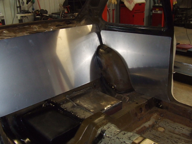

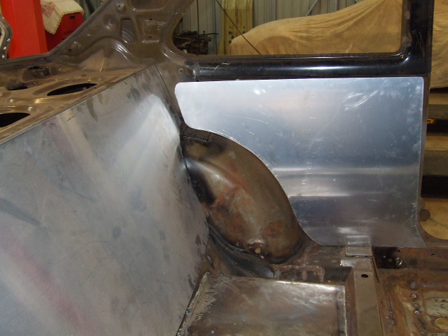

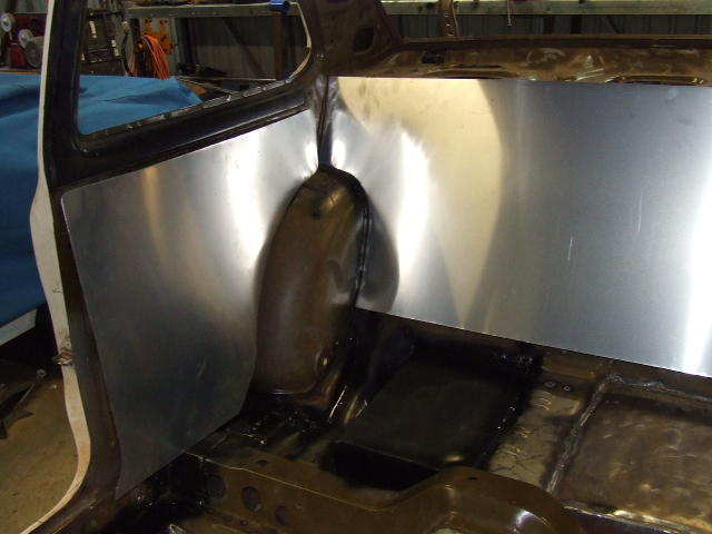

Started on the alloy cover and firewall plates.

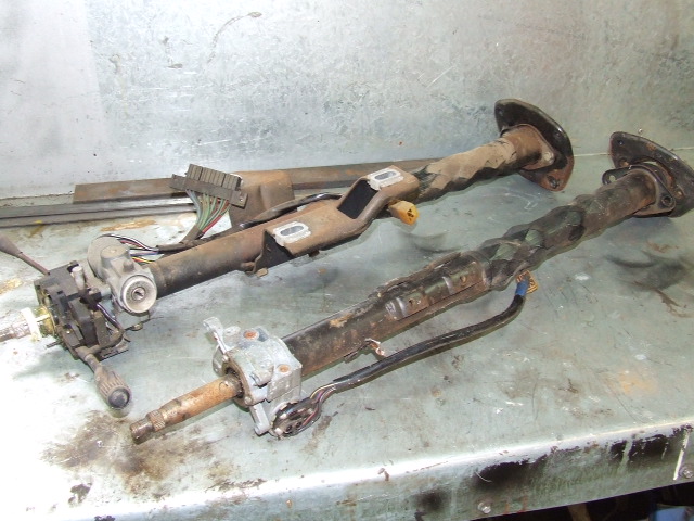

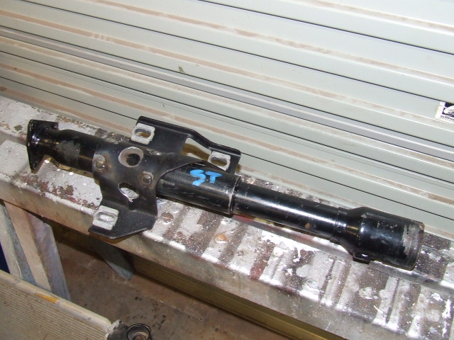

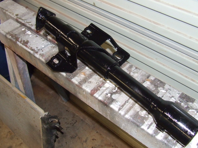

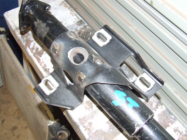

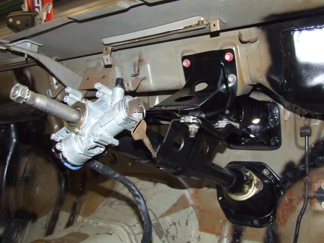

A Celica steering column attached to the Corolla mount.

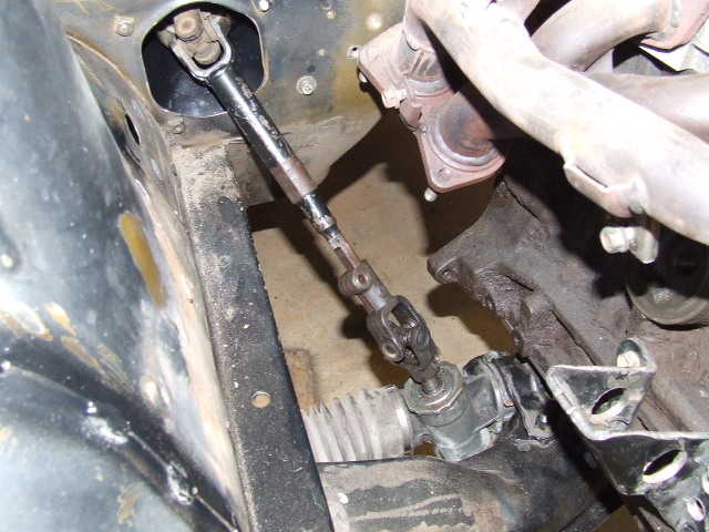

Steering column is in and all connected up and working.

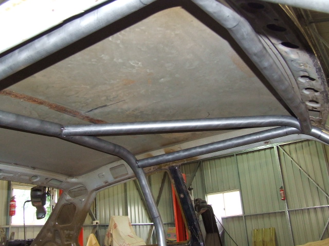

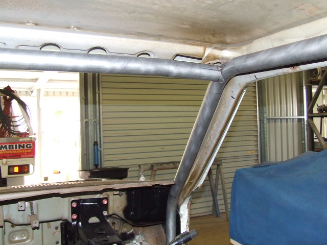

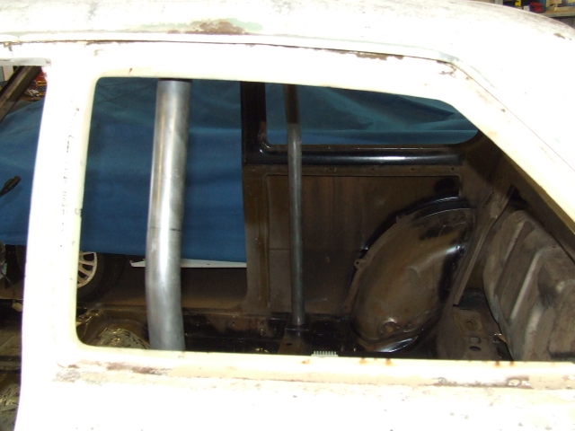

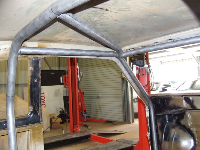

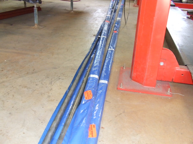

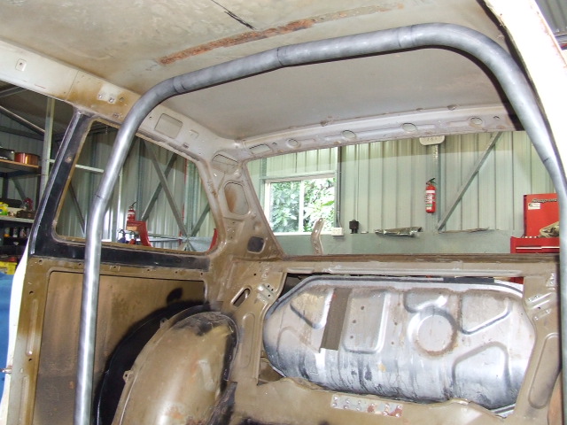

Also the roll cage steel turned up.
Its CDS, cold drawn seamless from Performance Metals. They now import the stuff from Germany.
Just had a big weekend on the pipe bender.
Got all the bendy bits finished.
awesome work mate , can't wait to see it finished :)

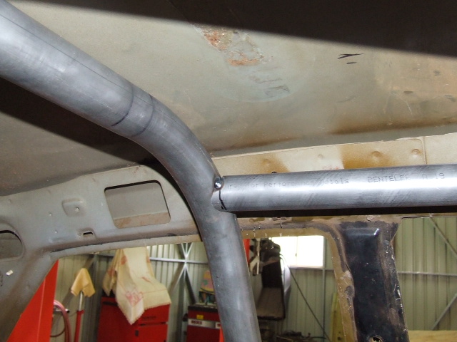

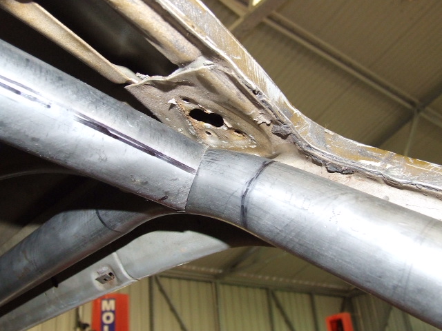

The bender is a Speedwerks product as is the tube notcher.
Any one can buy them, but not cheap unless you plan to do a lot of work.
The bender will produce a almost mandel bend. 100% better than an exhaust bend.
The tube notcher cuts a perfect joint to weld.
Ive built a few cages now, but working out the bend and cut angles to get a nice even close fitting cage still gives me a huge headache.

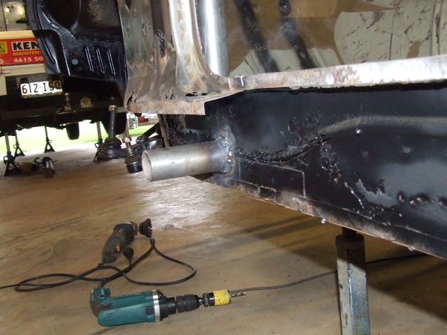

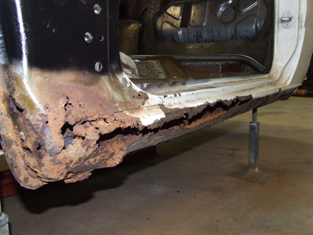

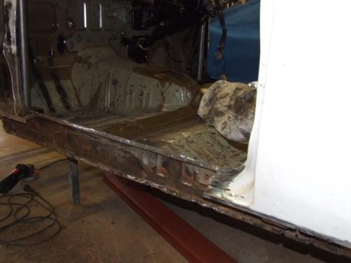

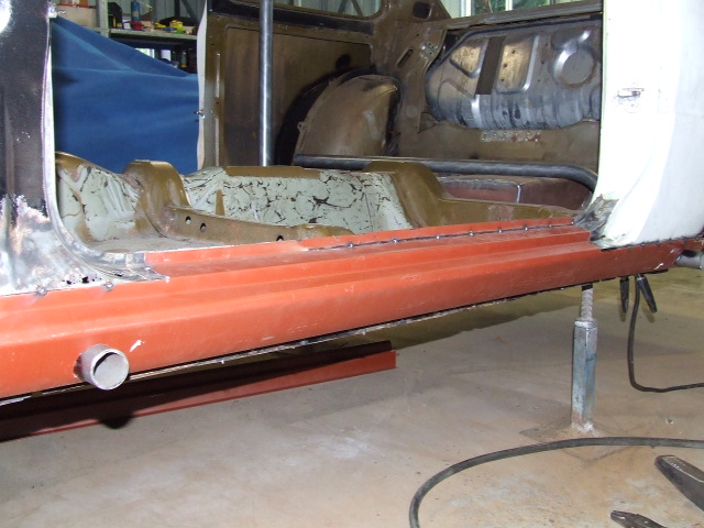

Left sill on the mend.

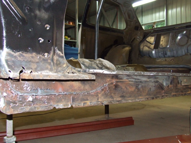

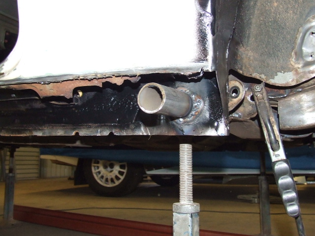

New sill in place with stand mounts.
