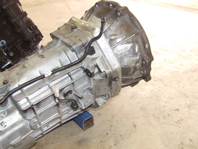

Its out of a 3sge IS200, http://www.ebay.com....=item27cd2bf096

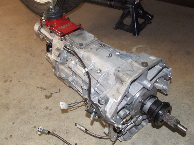

Its what iam putting in the rolla, just need to change the first two gear ratio's. 1.1 - 5th
Edited by trd
Thanks Tony.

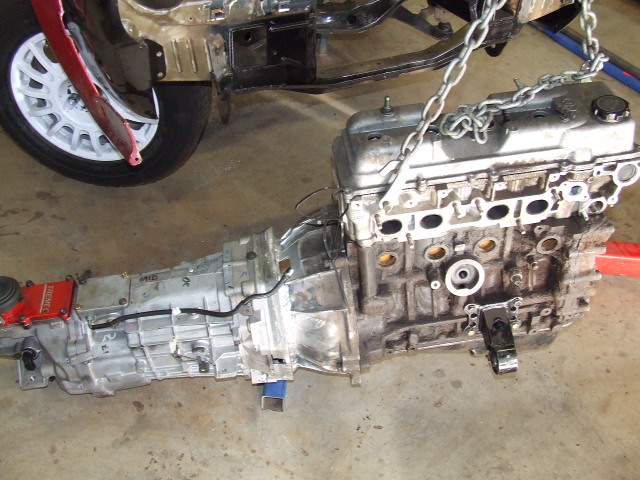

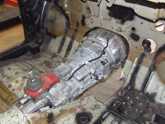

One reason I used the tremec, It is close ratio with 2.66 1st as standard so no custom gears have to be made.
It has 4 different gear leaver positions, cable or elec speedo sender, special sincros that allow fast changes above 7000rpm.
Has lots of options and is very strong.
All for $4000 brand new. Only fabrication is the bell houseing and gearbox mount.
I think the toyota box with adapter and custom ratios will end up more expensive.

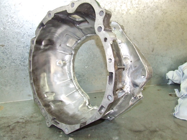

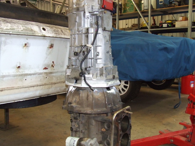

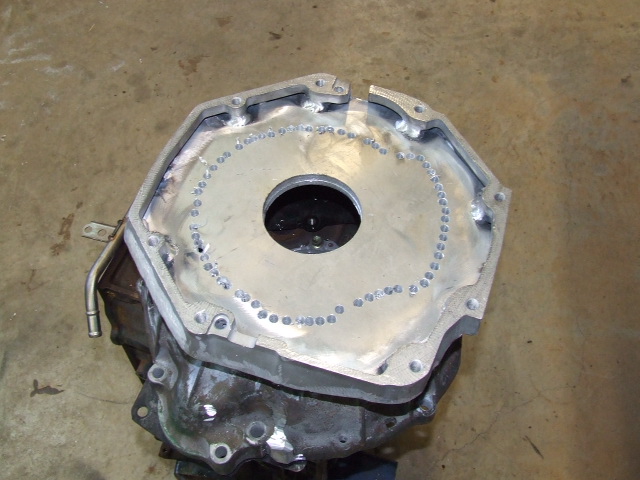

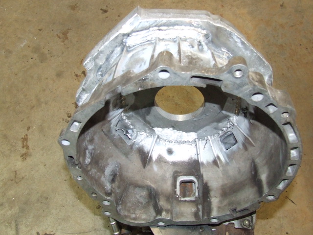

A bit more progress on the adapter plate.

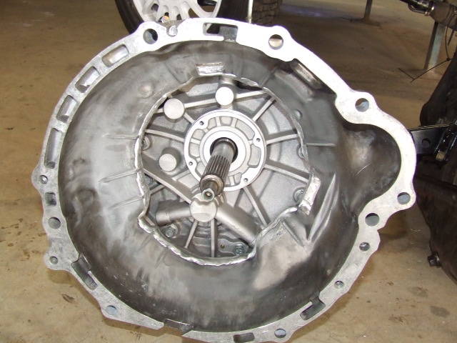

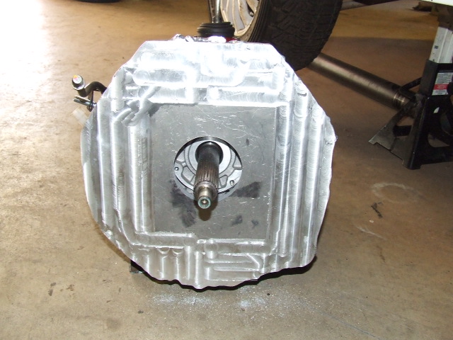

Two halfs going together.
Housing is done.

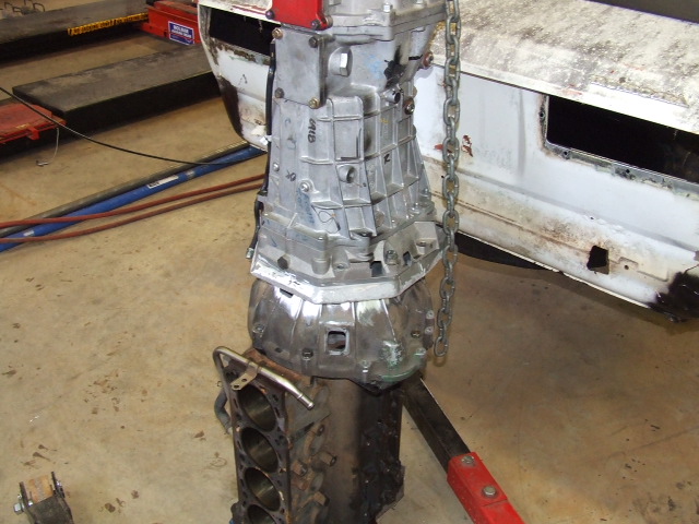

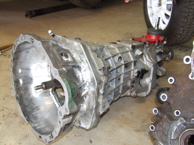

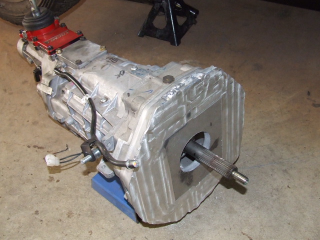

Deburred the housing and fitted to gearbox.
Tremec Magnum is massive! Unreal build mate. Probably the most visited build i've ever... visited!
Thanks, The tremec is a bit bigger but not much longer than a w55.
It does weight about 20kg more than an alloy w55 supra box which is not good, but the weight is down low and almost central in the car to minimise its effect.

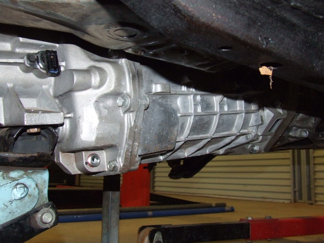

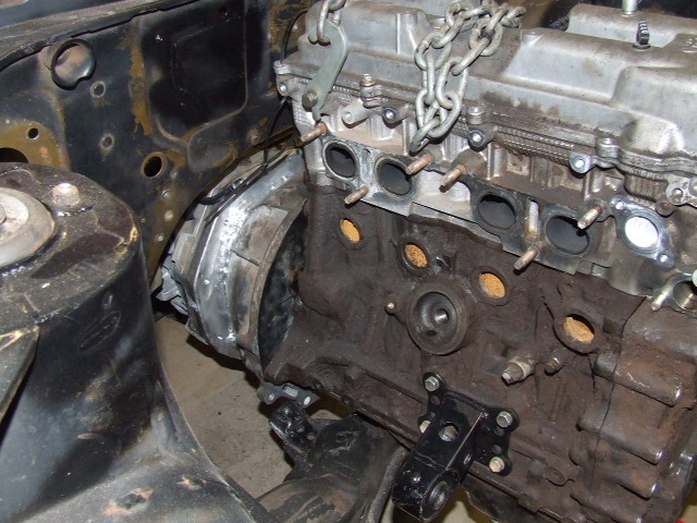

Its in the car now, Just have to line everything up and make some mounts.

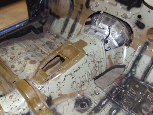

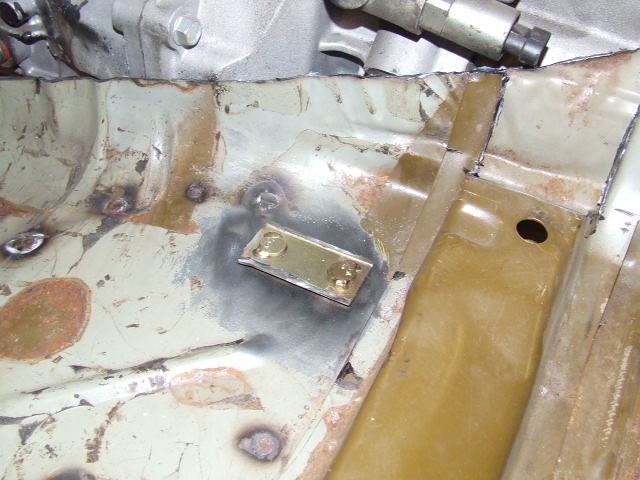

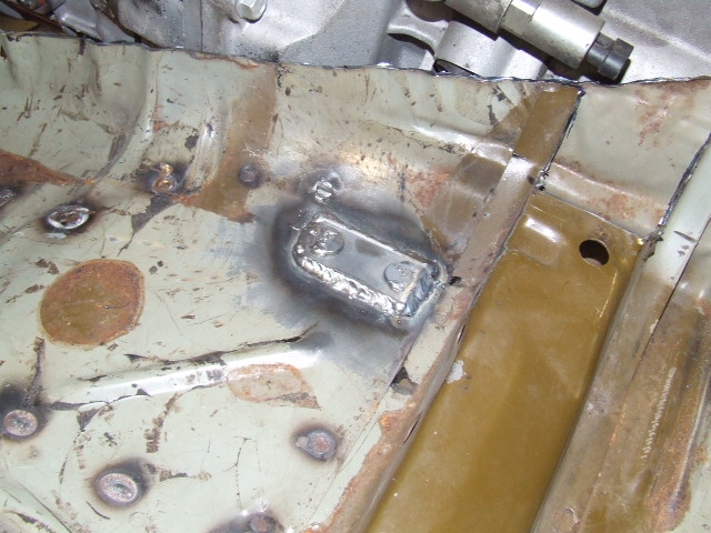

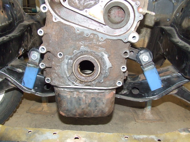

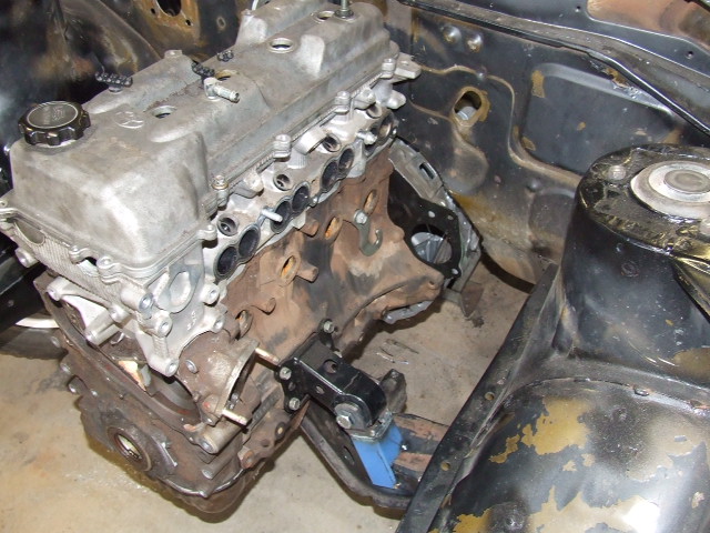

Engine mounts are tacked in position and started on a new trans tunnel for the gear box.

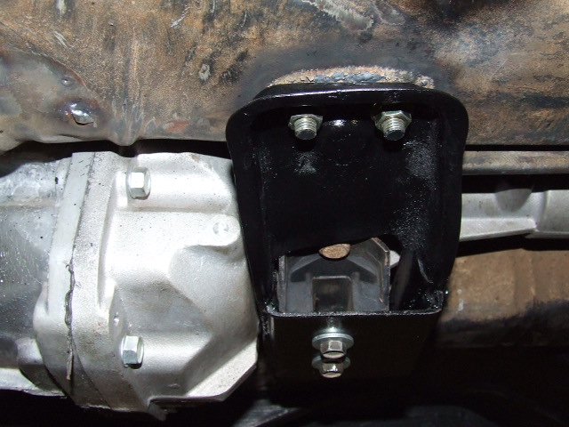

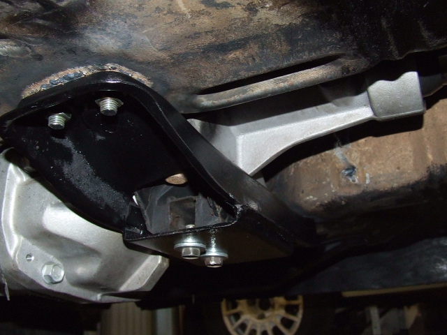

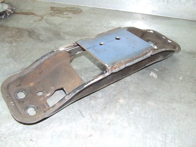

Iam using old cut down top control arm mounts from a falcon as gear box mounts.
Found they fit the celica bracket perfect.

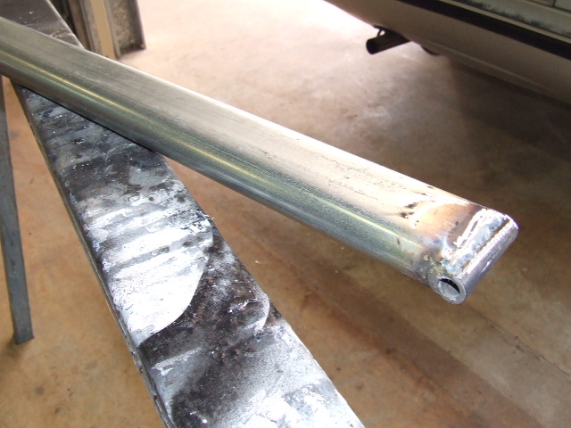

New gearbox x member finished.

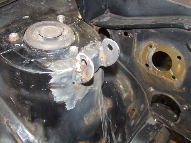

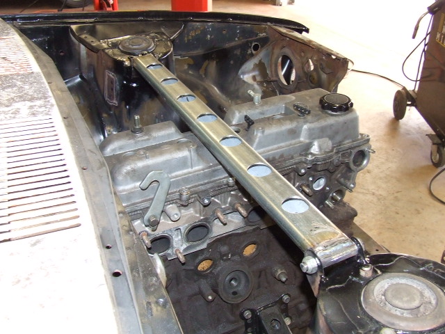

Strut brace made and fitted.
