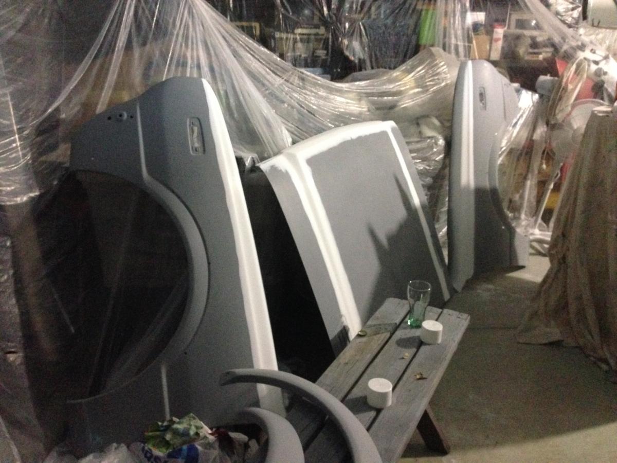

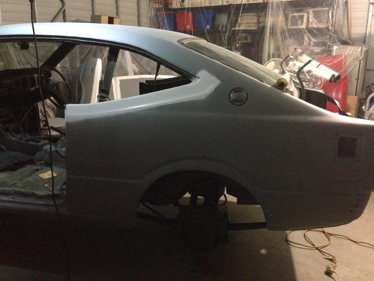

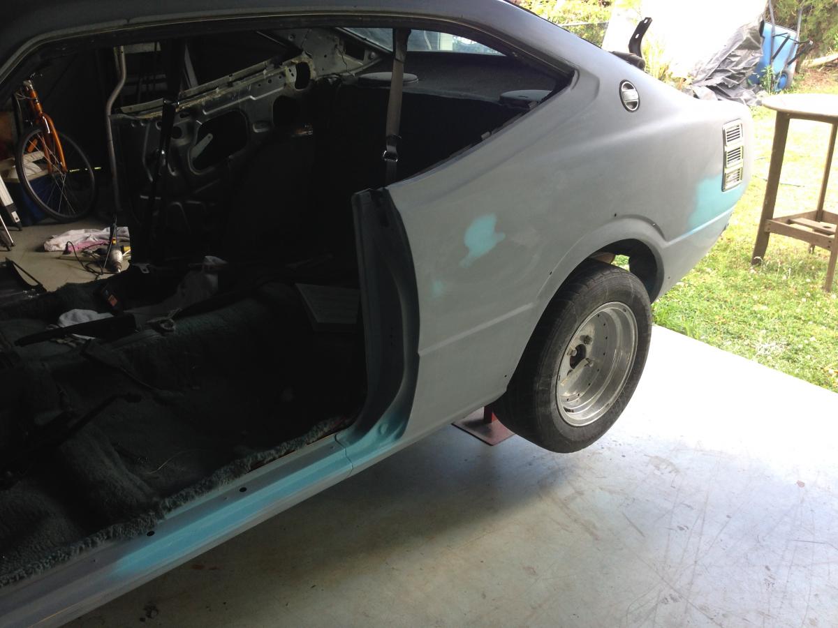

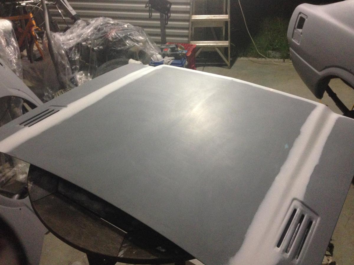

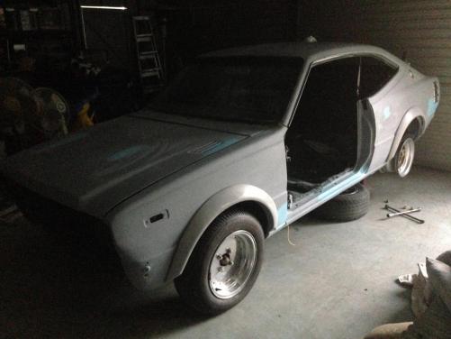

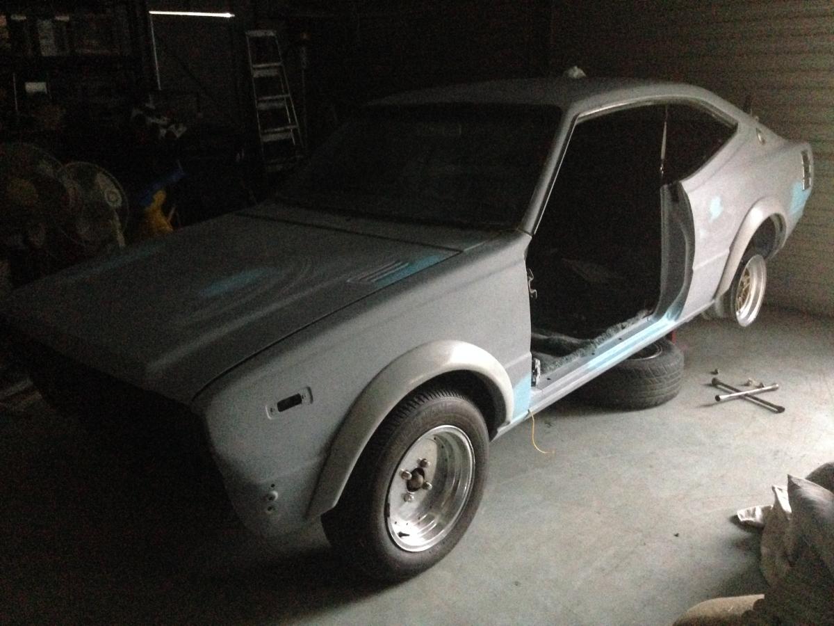

Here's a [don't look no different] post. Over the past couple of months I've knocked down several beers looking over the dozen or so dimples and dents that spray putty didn't fill.
Then more recently I finally stumped the cash and purchased some colour and clear!

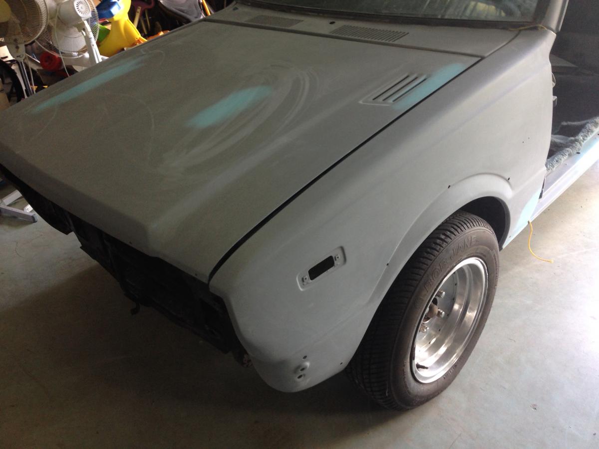

This gave me the impetus to get out into the shed on week nights and attack the dimpled dozen with gusto and rub the whole lot over with 400 grit wet and dry..

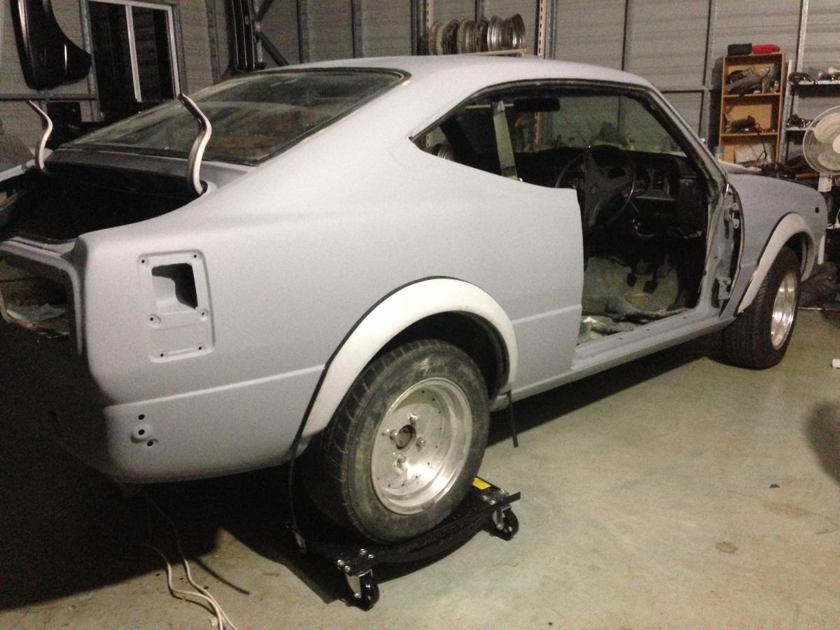

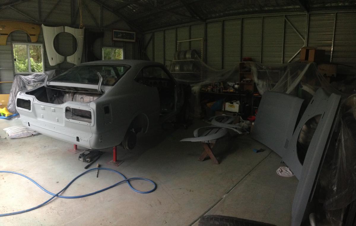

I suppose in any project there's a point where you can no longer be bothered to chase the last 1% of divets and dimples, and I figured if paint won't cover them, some last minute blade putty will. So on the weekend I wrapped the contents of the shed in plastic and hit everything with the last (I hope) primer coat.
Turns out acrylic primer is more forgiving than my eyes and though I'd considered giving the whole lot another 400 rub back before priming, turns out it wasn't necessary.

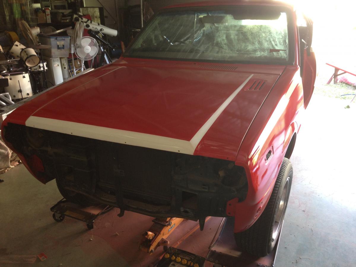

Not without a couple of mishaps - my timber bench seat collapsed while I was doing the roof. And my gun was either a jet or a fan - no in between - so I got a run(s) in the clear. Nothing some 1200 won't fix.
But the gloss coat worked out well. Hopefully it keeps this lustre as it dries.

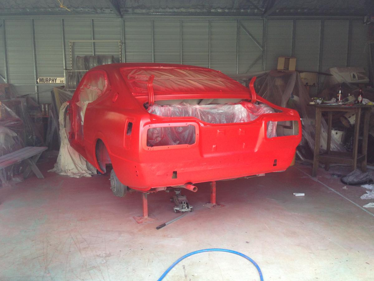

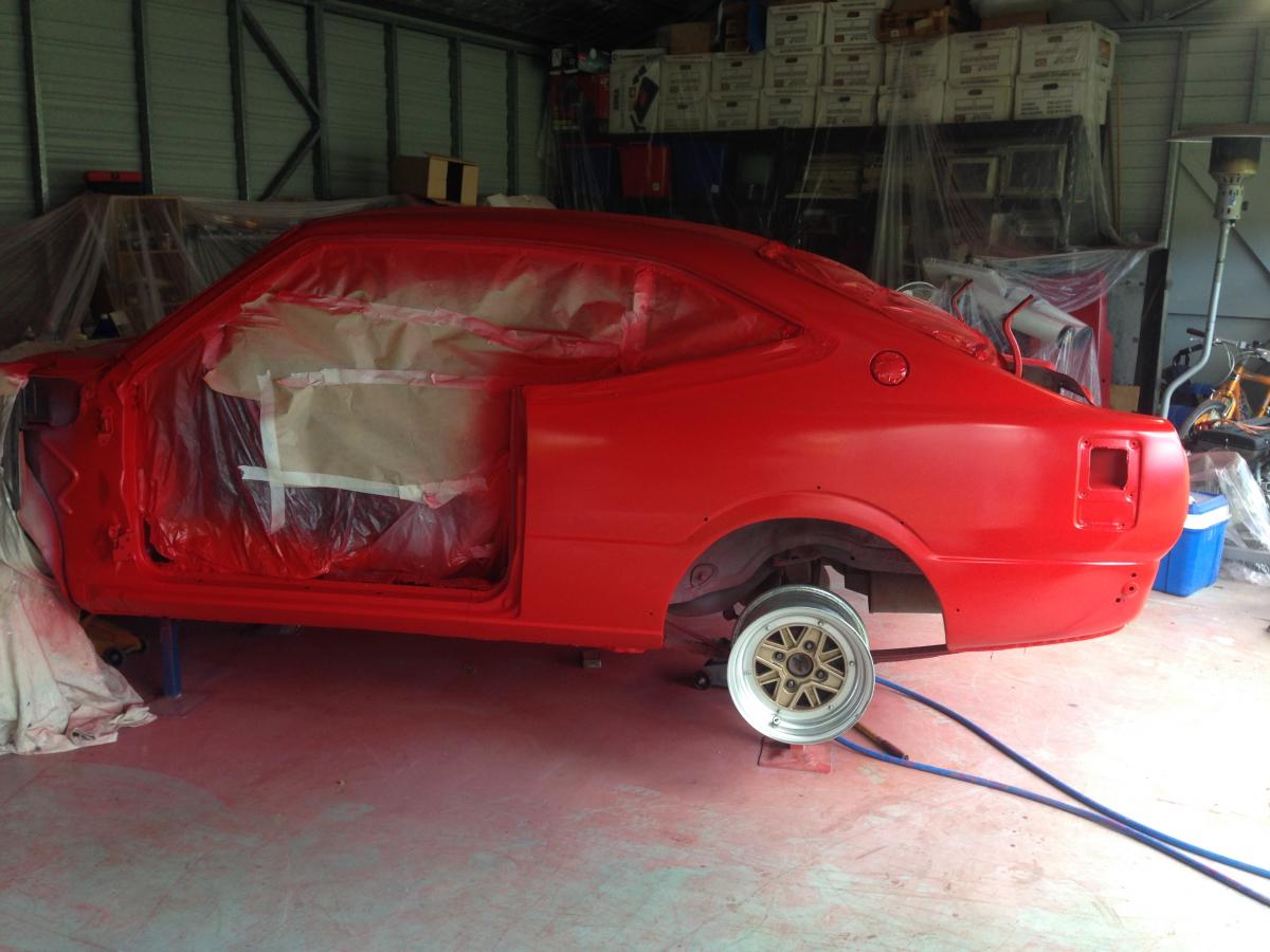

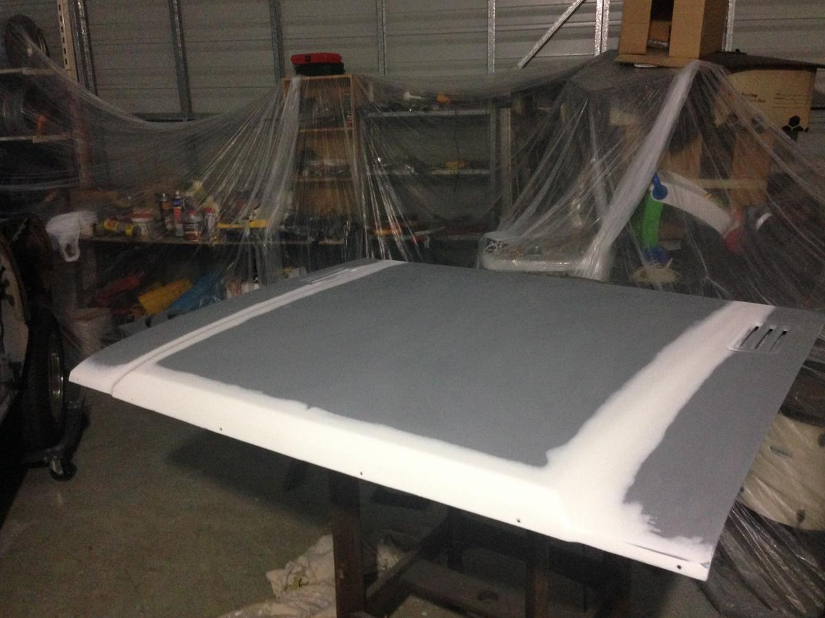

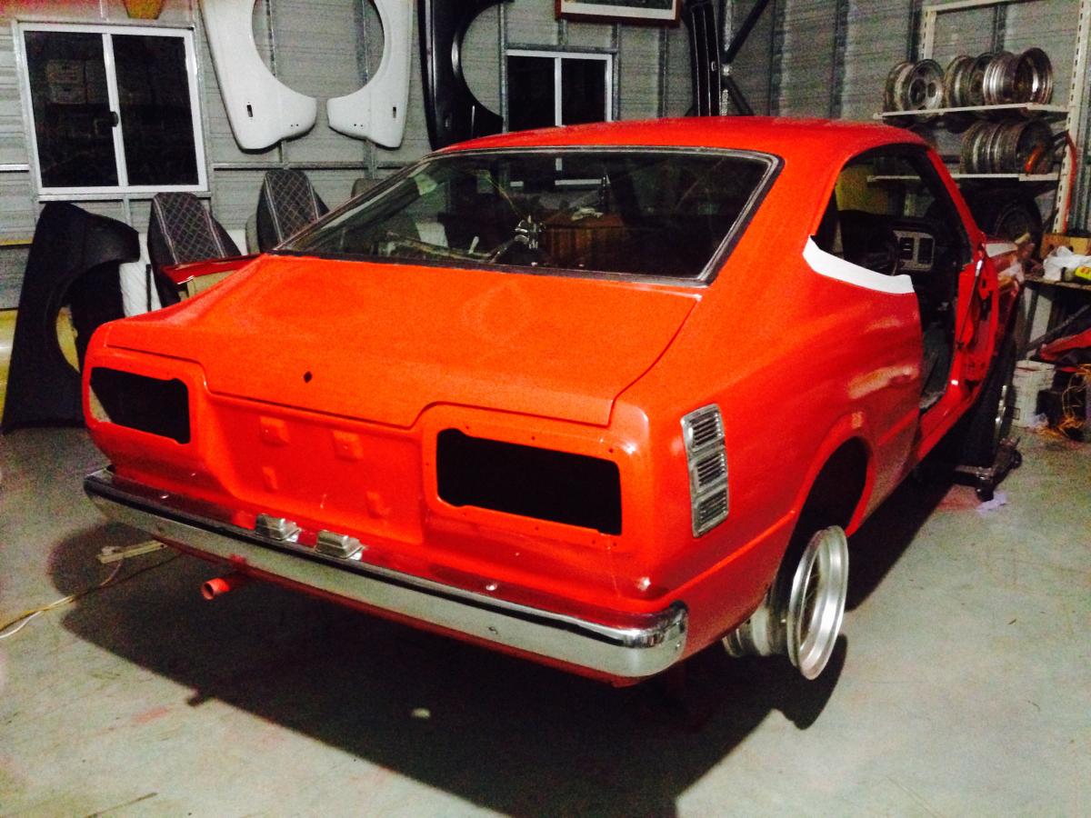

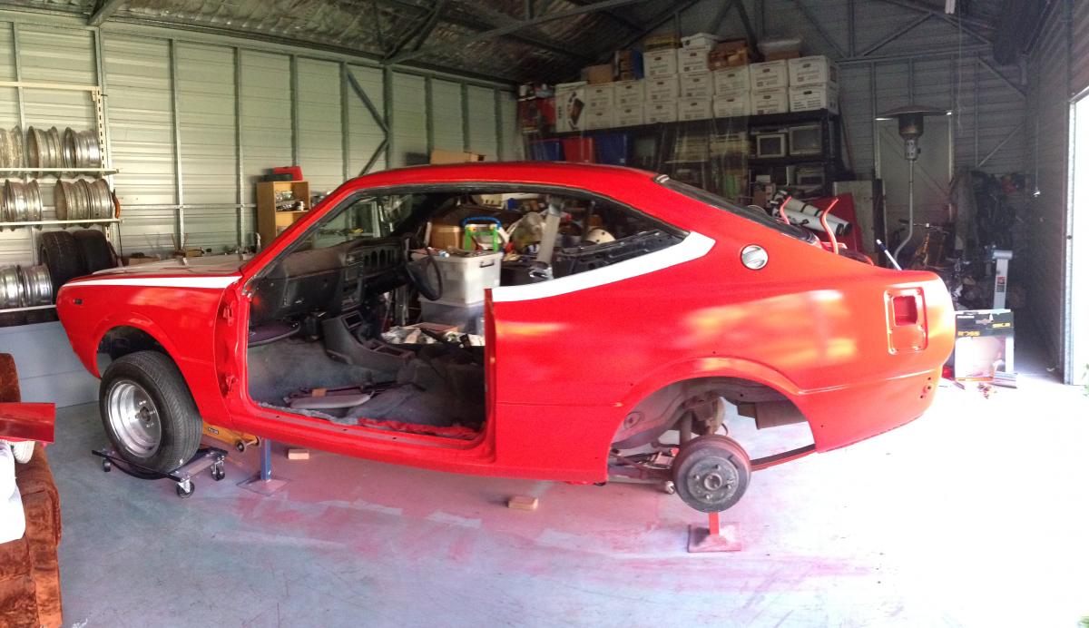

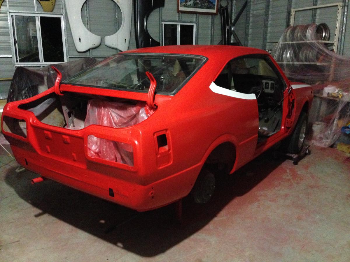

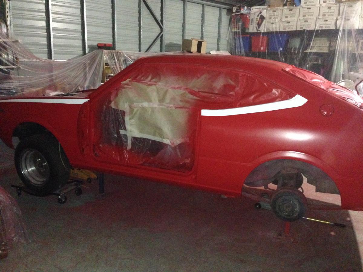

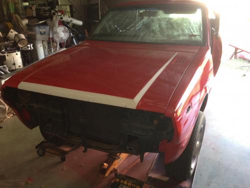

Ok well.. I didn't want to post too many shots of my junquey shed but what the heck - this is how it went down.

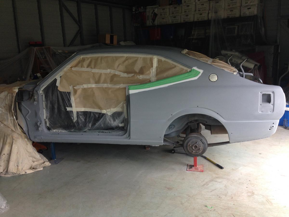

Last week I spent every night rubbing panels, setting up the white stripes and then rubbing them again in 800 grit;
Then Saturday morning I felt I'd done enough and started masking up;
When I had full coverage, had a beer and reflected on my progress;
Thought I'd see if the wheels matched the colour;

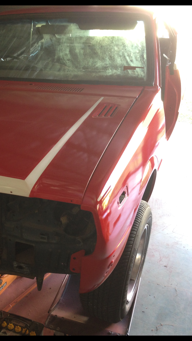

Later that evening, after washing half a kilogram of red dust down the shower, I ventured back out with the day's final beer and peeled off the masking to have a look;
Then on Sunday I backed it up with a quick rub down with 1200 over the rough bits, then hit it with the clear coat;

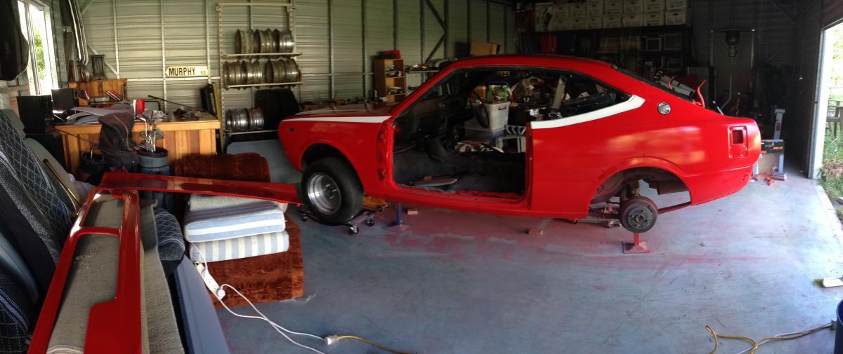

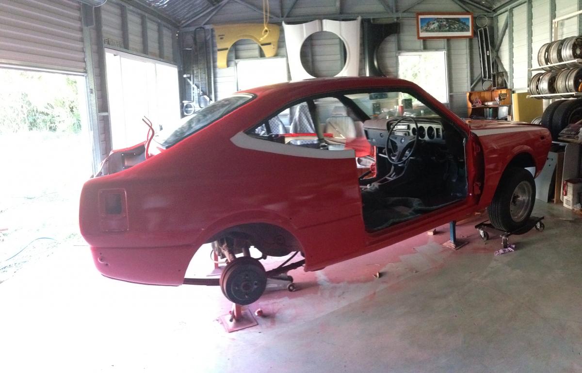

It's very tempting to bolt it all back together now! I'll start putting the rear of the car back together but I'll leave the front end off for now until I swap the engine in so I don't get hand prints and lean all over it. Must finish doors and fender flares first anyway before the front can go back as guards need to be off to fit the front flares.
I'm fingered today! Too much like hard work.
Edited by Mechanical Sympathy
