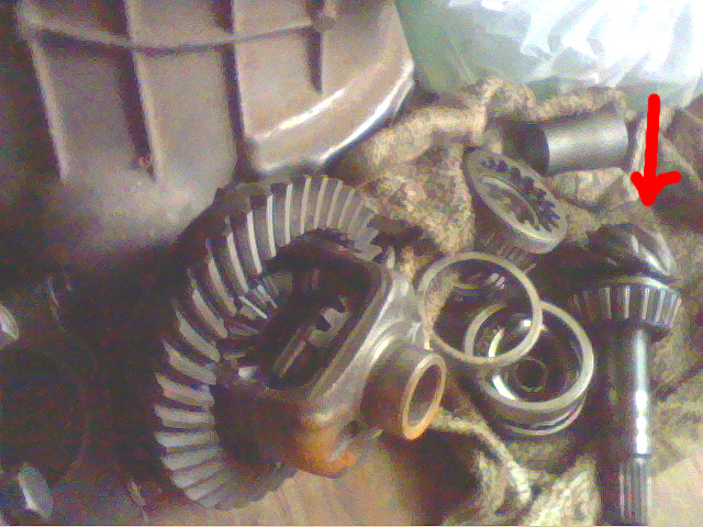

CorollaNut68 Posted September 8, 2015 Report Posted September 8, 2015 (edited) Its a lovely dream, but sadly I usually find whines come from worn bearings or teeth. An LSD should be just as silent as a stock one. Jack up one wheel and see if it spins, or just drop the clutch on some gravel. Good luck! So if I always leave 2 black stripes when I smoke the tires it's limited slip right? I'm getting a scream at certain speeds less if under load that I can't tell where it's from, diff or trans...put new bearings in diff no change. Some guts from a previous one...note the broken tooth on the pinion. Edited September 8, 2015 by CorollaNut68 Quote
