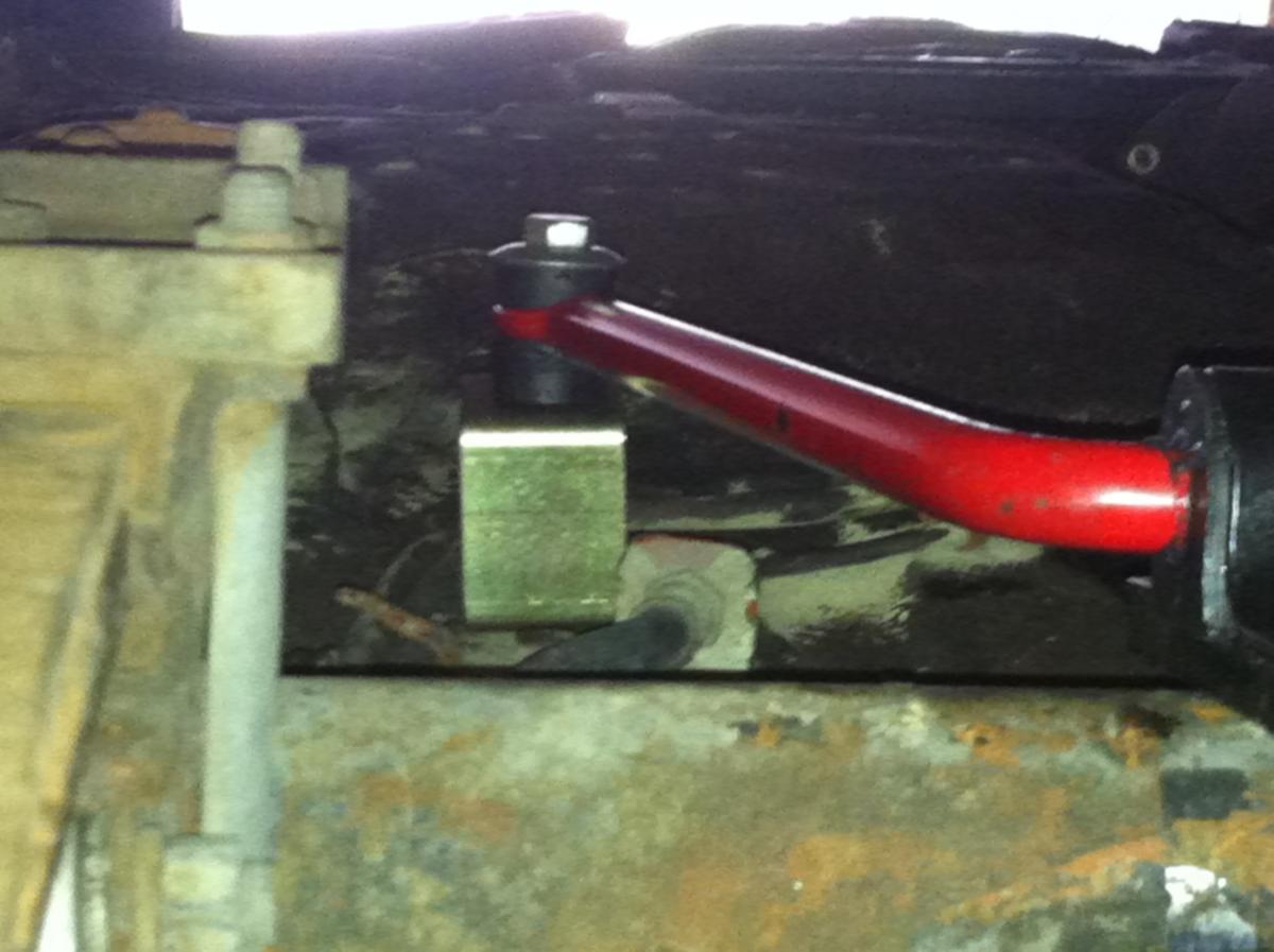

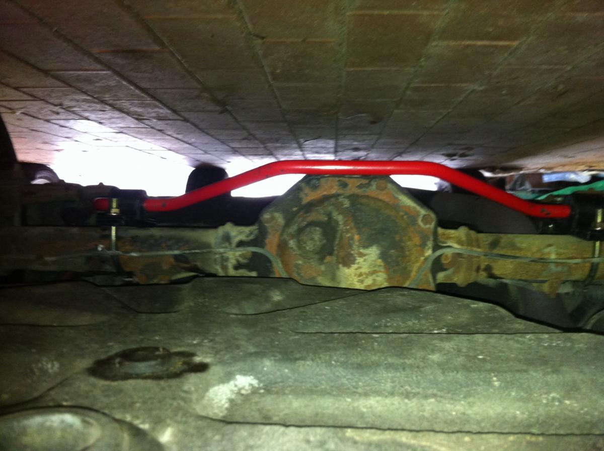

Pretty much have the handling sorted now feels pretty flat through corners now. The rear swaybar was like the front one well worth it in the end. Tweaked the "kit" bar in the cold press and changed the link pin mounts to better suit the floor. Looks like this.
And how the link pin mount looks.

What's the rear bar from? Is it and aftermarket KE11 one or something else modified to fit?
Hey Stu,
It's an aftermarket one that I modded/tweaked to fit a bit better. Signiature sways bars made both of them. Now I have measurements I'm happy with I'm going to get a group buy price for the ke-1x's. Pretty sure they'll have them for the 20's too.

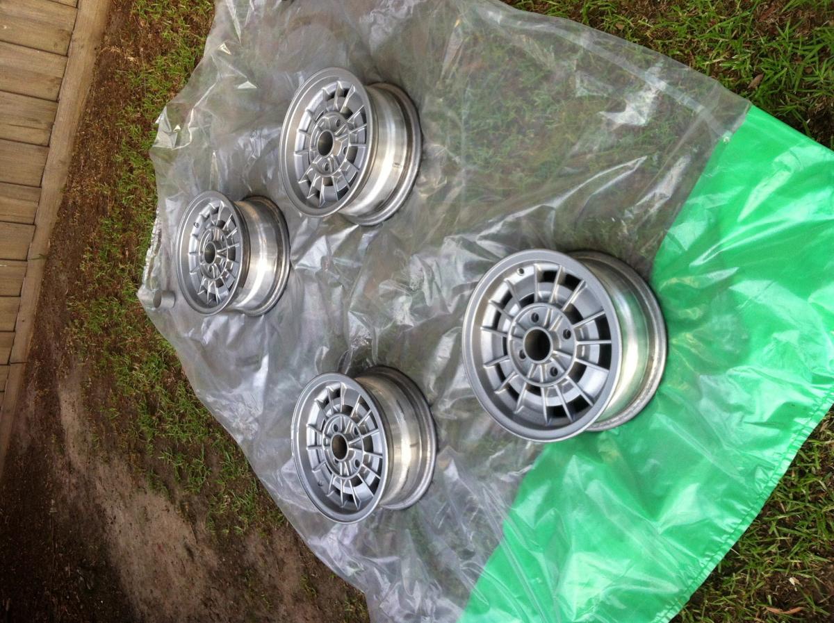

The paint on the wheels hasn't turned out the absolute best, but didn't want them perfect to begin with.
