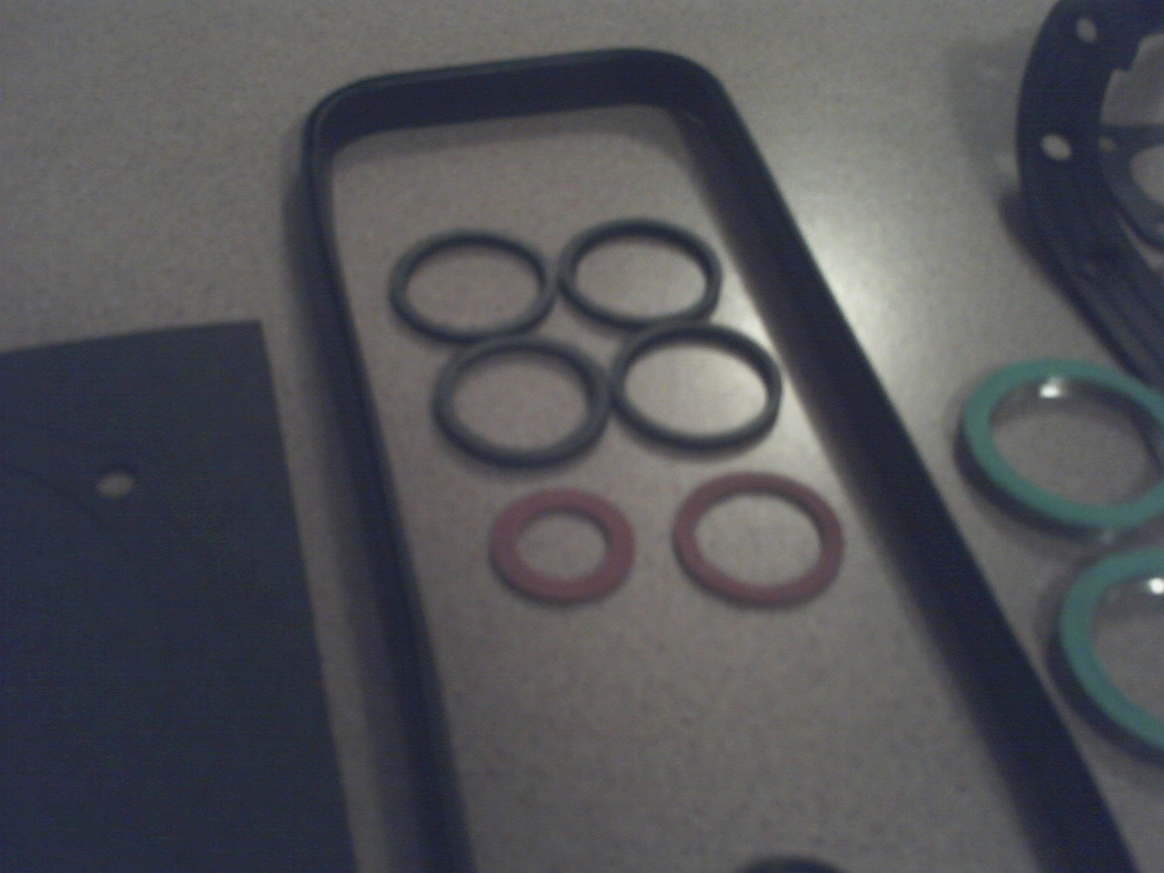

  2. According to my digital vernier calipers the dimensions are as follows Small fibre washer ID= 18.00mm OD= 28.00mm Large fibre washer ID= 25.38mm or 0.998 " OD= 33.43mm or 1.316"

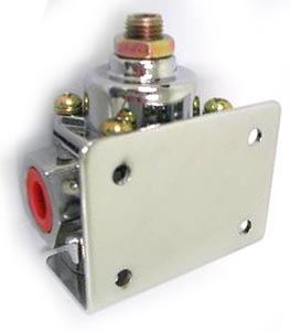

  3. Yea found out what they were for from Trav 555. thanks anyway. I was thinkin bout the fibre ones being for the fuel system but the size seems a bit whack for that, will check them out. Wont be needing them i don't think ( different carb and no mech fuel pump).

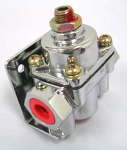

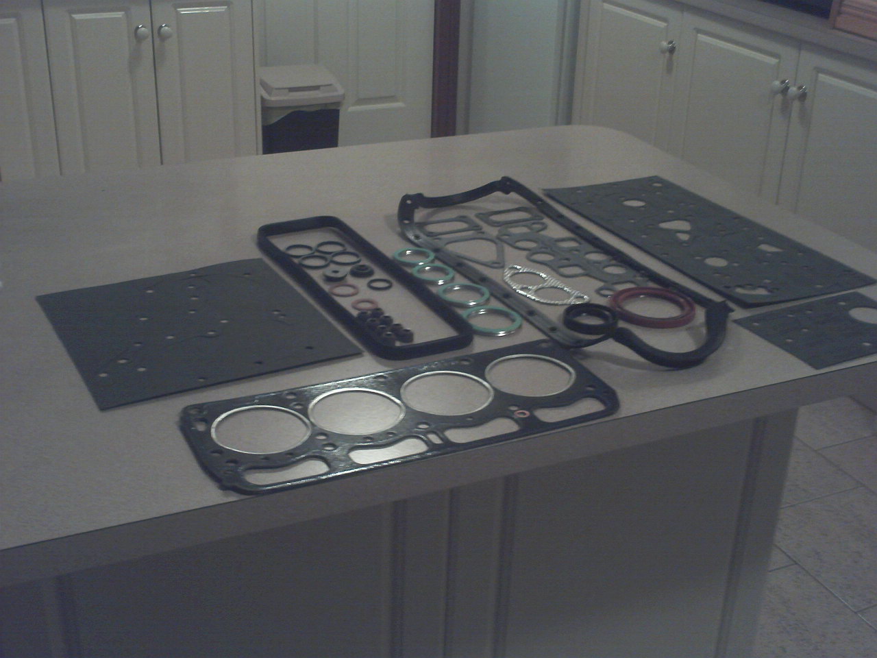

  6. Fuel reg came in on tuesday and so did the gasket set. Picked up the gasket kit tonight and woweee, it comes with everything you can think of, and some i don't even know what they're for haha. Should hopefully get a new master cylinder tomorrow. Me wants it going by saturday arvo at the latest. ZOMG. Lotsa gaskets :D WHat are these 4 rubber seals and 2 fibre washers for?

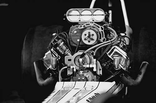

  8. I guess with an SC the size you go would be limited by the engine and the boost you want as it doesnt have boost lag like a turbo. Basically an SC has two "rotors" with fins or lobes that intermesh with each other (much like gears) while spinning air is trapped between these fins or lobes and compressed before exiting under pressure (boost). All it really is, is an air compressor. As long as you have enough power to turn the thing and mount/ plumb it i can't see any restrictions on how big you could go. There would be a point where it could be so big for the application that its stupid big. Some of the SC's used in drag racing soak up more power than the average HEMI V8 produces!!! Try that sucker on ya 4k :D

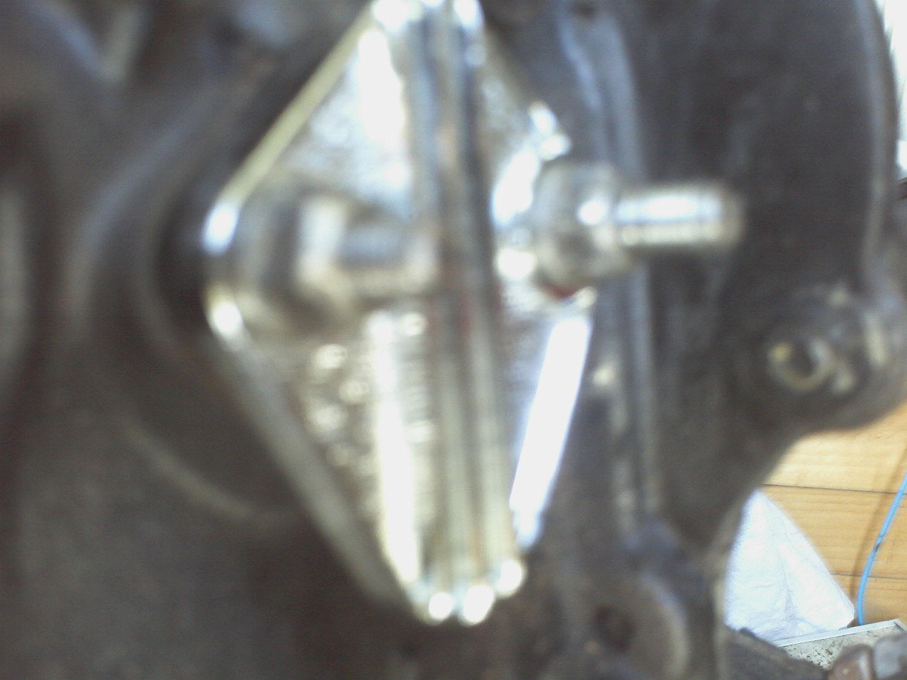

  14. The Rolla Collection begins :P Pics of said ke30?

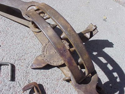

  17. Soap on the floor = trap > Bear trap

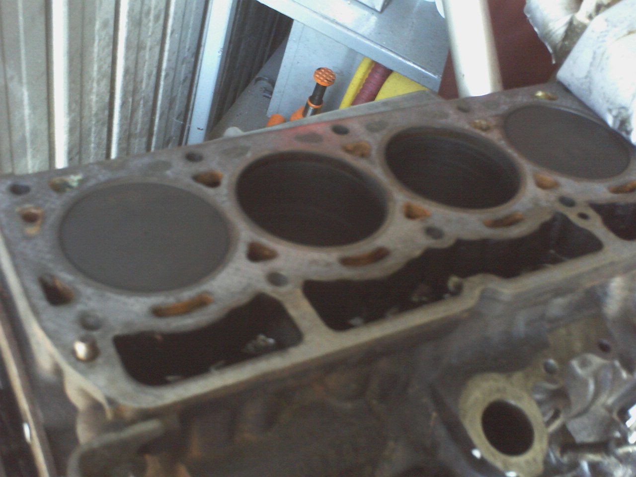

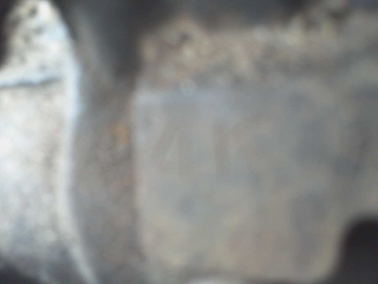

  19. NEW 4K :P Fuel pump block off plate Pulled the head off ready for the gasket kit to come in, found it suprisingly clean inside (minimal carbon build up) What can i use to remove engine oil sludge? everything seems to be covered in a thin covering of sludge like oil Edit: Sludge is prolly not the right word to use, hopefully you get what i mean tho.
