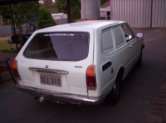

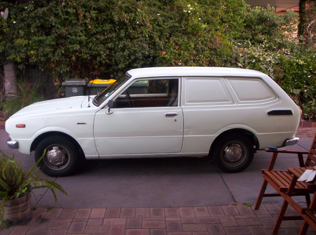

  2. And now for the pics.....

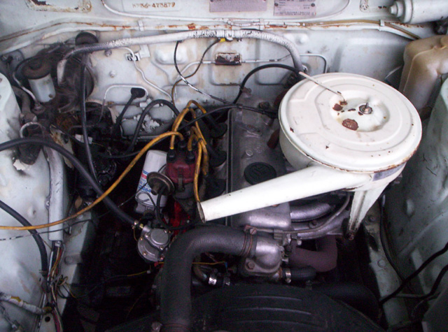

  3. Update *1* Ok, i've got the car home. I managed to get it started and drive it onto the trailer so no winching required and it started first pop when i took it off the trailer, running on 2 and sometimes 3 cylinders. Anyway, i drive it into the driveway and pop the bonnet. Check all the leads and distributor cap and notice cylinders 3 & 4 arent firing and that the dizzy contact points are corroded and the rotor button is dirty. So i clean up the rotor button. So, i start it up and it starts running on 3, so i pull the choke out and it sounds like its running on 3 all the time so i give it a rev and voila, its running on all 4. I check the radiator, No oil in the water. Check the oil cap, its not milky. Go around to a mates shed and degrease the engine and pull the leads off the dizzy. Number 4 lead is stuck in the dizzy. So i pull it out and its corroded heaps in there. So yes Valandor, it was an electrical problem. It needs a tune and tappets adjusted but other than that its all sweet. Pics will be up later tonight.

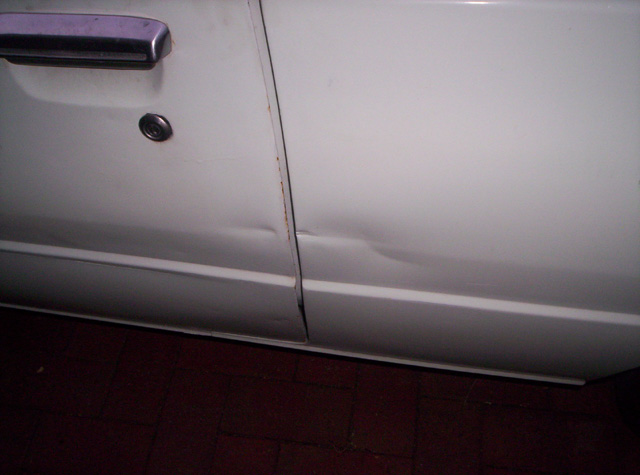

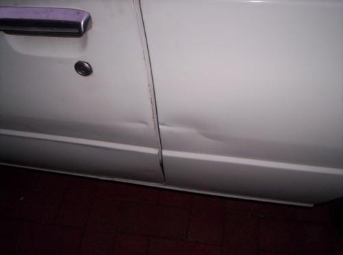

  17. What needs to be done: * Engine Swap * Roof lining has collapsed at the rear * Dented Passenger door * Both front guards have dents/ripples * Hinges dropped on both front doors Oh......I pick it up on Saturday but I already mentioned that.... So who from Adelaide wants to give me a hand to swap the engine? Cheers Mick
