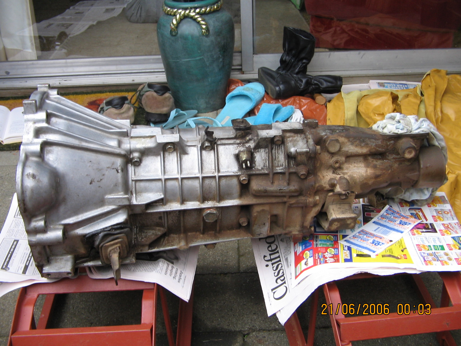

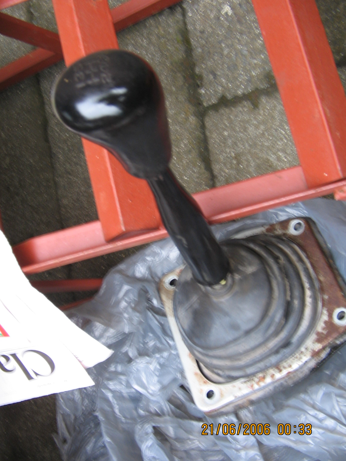

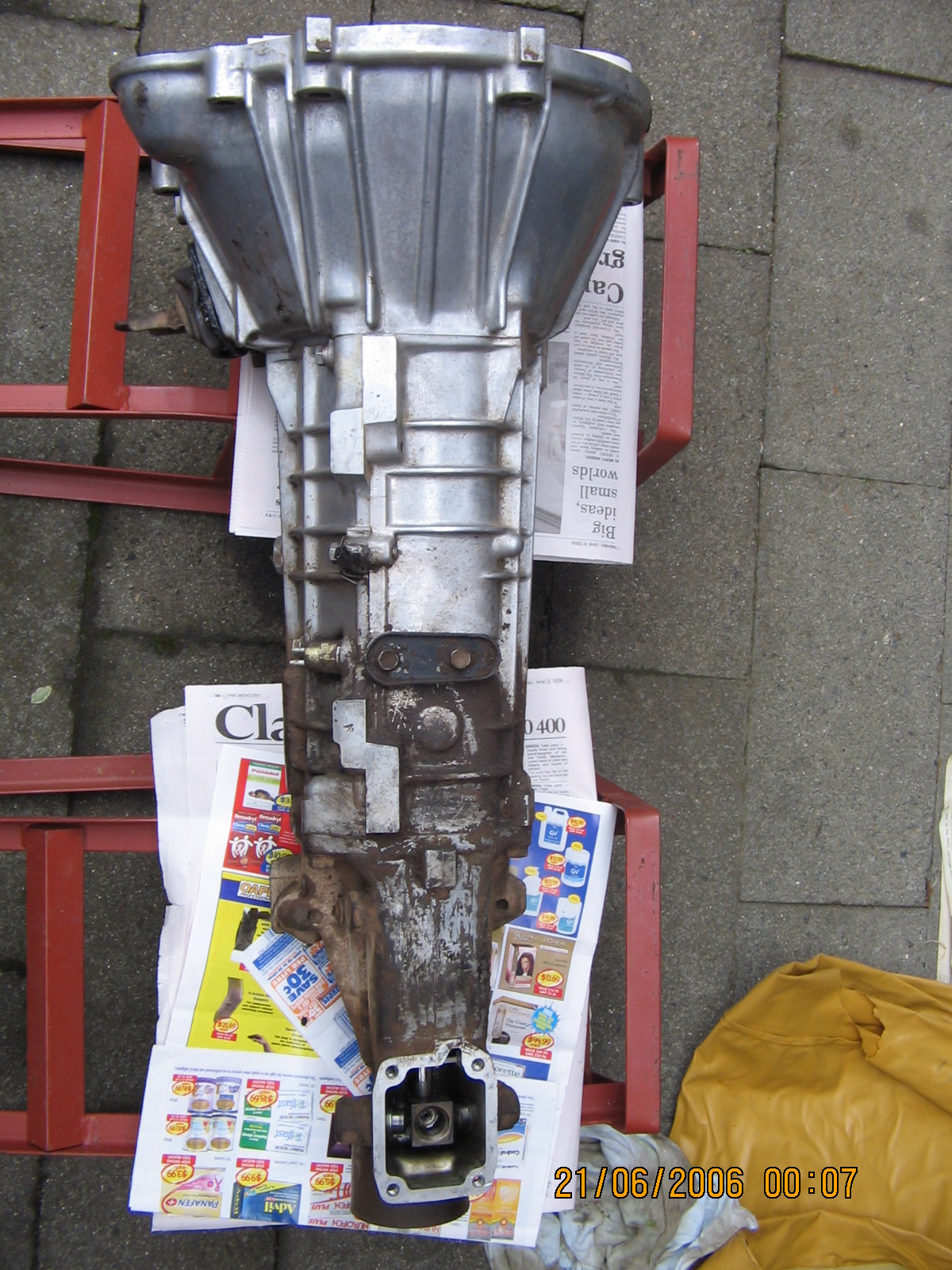

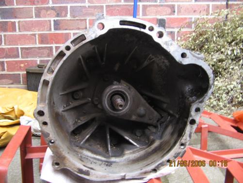

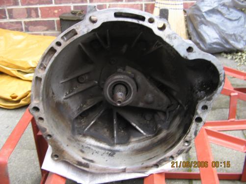

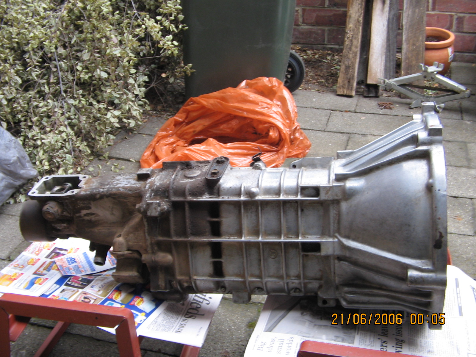

A bloke gave me this gear box. He reckoned he got it out of a KE55 (1980 model I think). I wanted to get a 5 speed gear box (K50) for my 4K engine. But I'm a bit confused. It looks like a T50 gear box. The clutch fork is on the passenger side (starter motor side), and it doesn't have a return spring on it. It must be a hydraulic clutch. And the drain plug is not direcetly underneath like on my K40 gear box. The bell housing has got '3A' on the top of it. And the bolt pattern looks a bit different to my K40. He gave me the drive shaft, since the front yoke was smaller in diameter than my KE30, so I can swap it over. I counted the splines, and I think its 22. Well, I reckon its a T50 gear box, but he saids its off a K series engine. He said it was out of a corolla shaped like mine, except it was a 4 door sedan (KE55). Looks pretty similar to the T50 gear box: http://www.rollaclub.com/faq/index.php?tit...eries/Gearboxes I reckon the KE55 would of had its engine converted to an A series engine. Well Here are the photos: anyone recognize the gear shifter? This has to be a T50 doesn't it? And the bell housing definitely wouldn't fit a 4K Bruce
