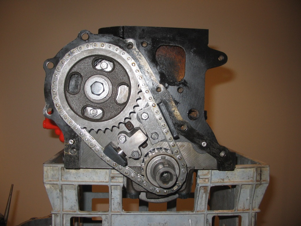

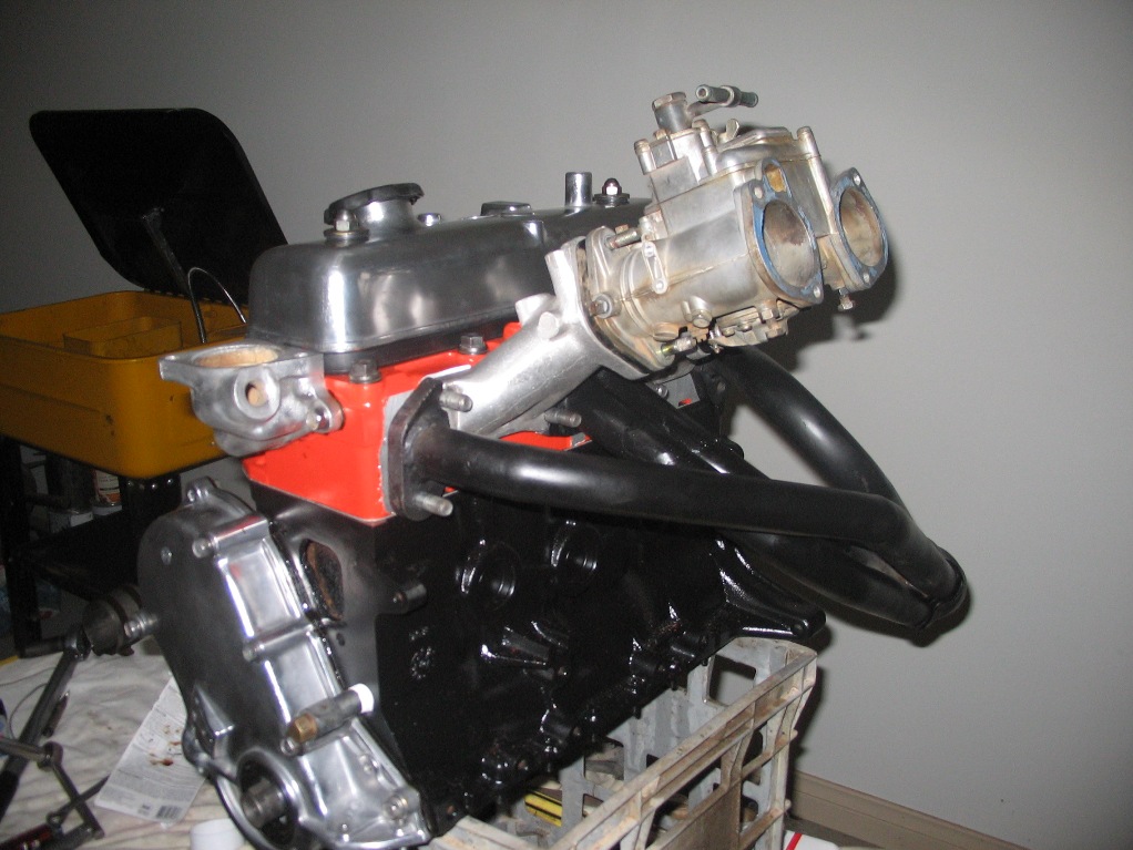

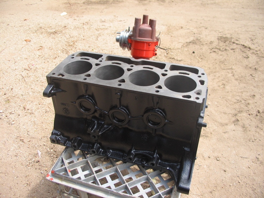

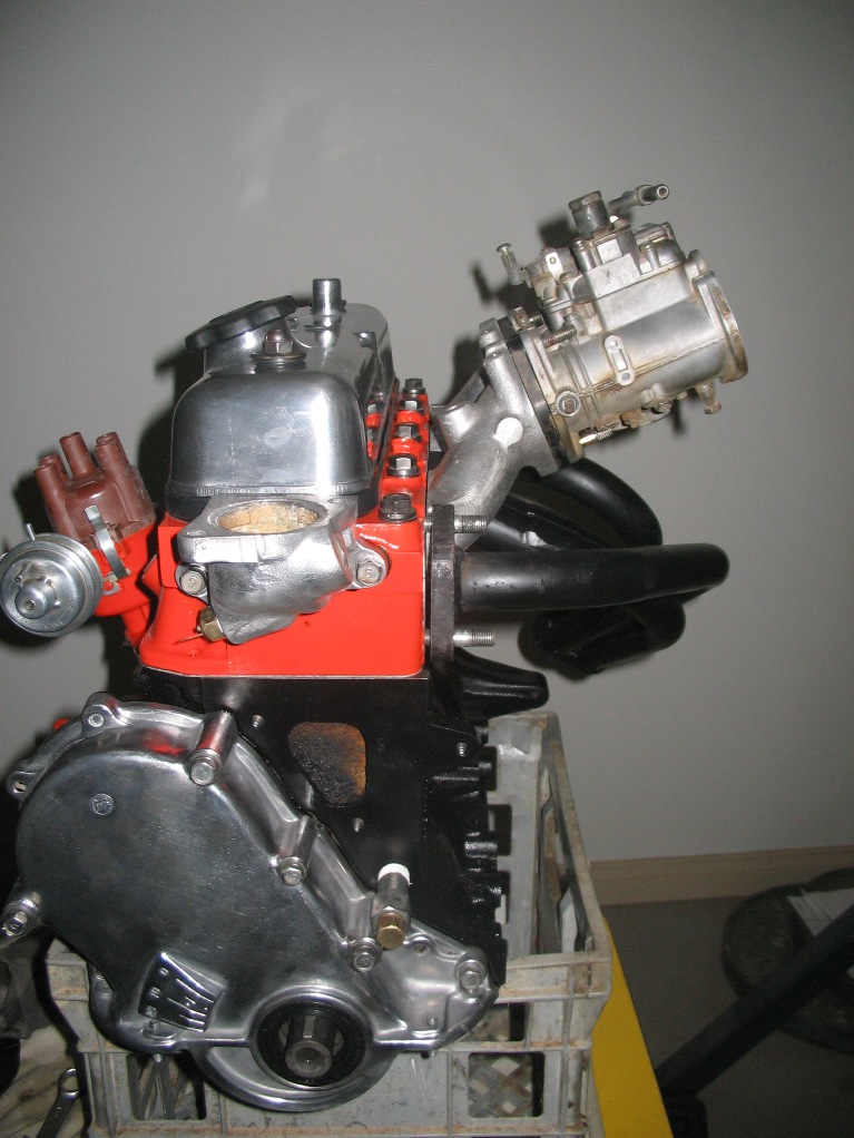

Here are a few pics of the motor being assembled.
THINGS THAT HAVE BEEN DONE:
crank has been nightrided and balanced.
pistons and conrods have all ben balanced
flywheel lightened(7kg) and balanced with crank and front pully.

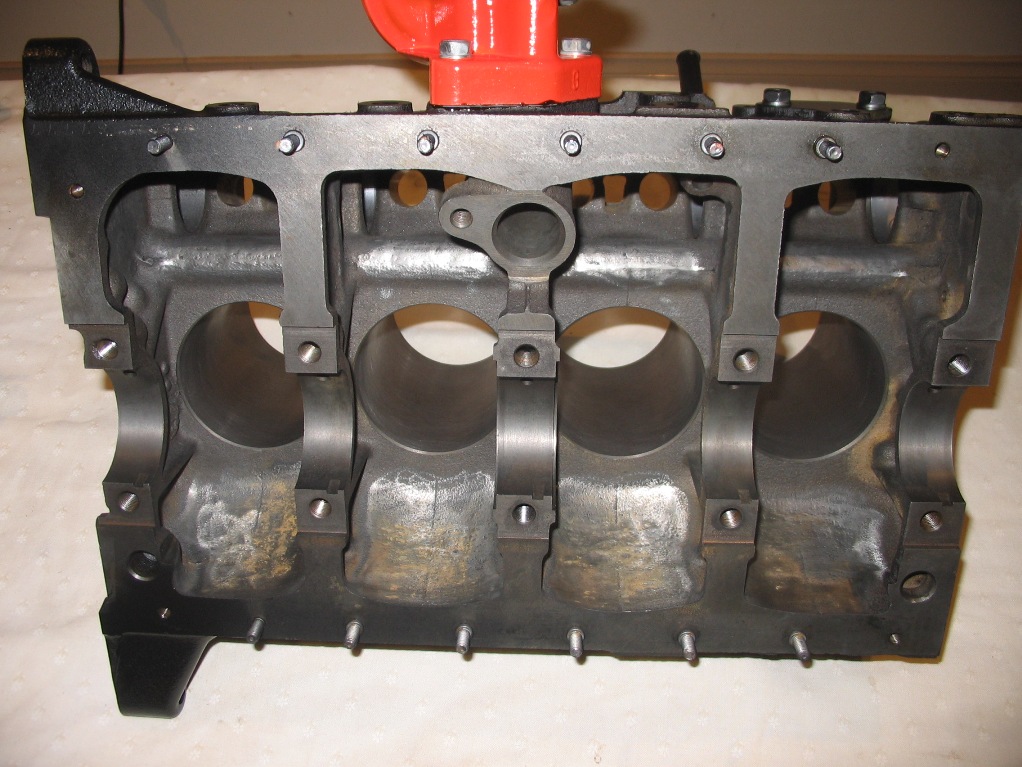

block has been bored 40 thou / decked 15 thou and had all mold castings ground and polished on the inside.
cam has been reground by wade camshafts to the profile of 169x

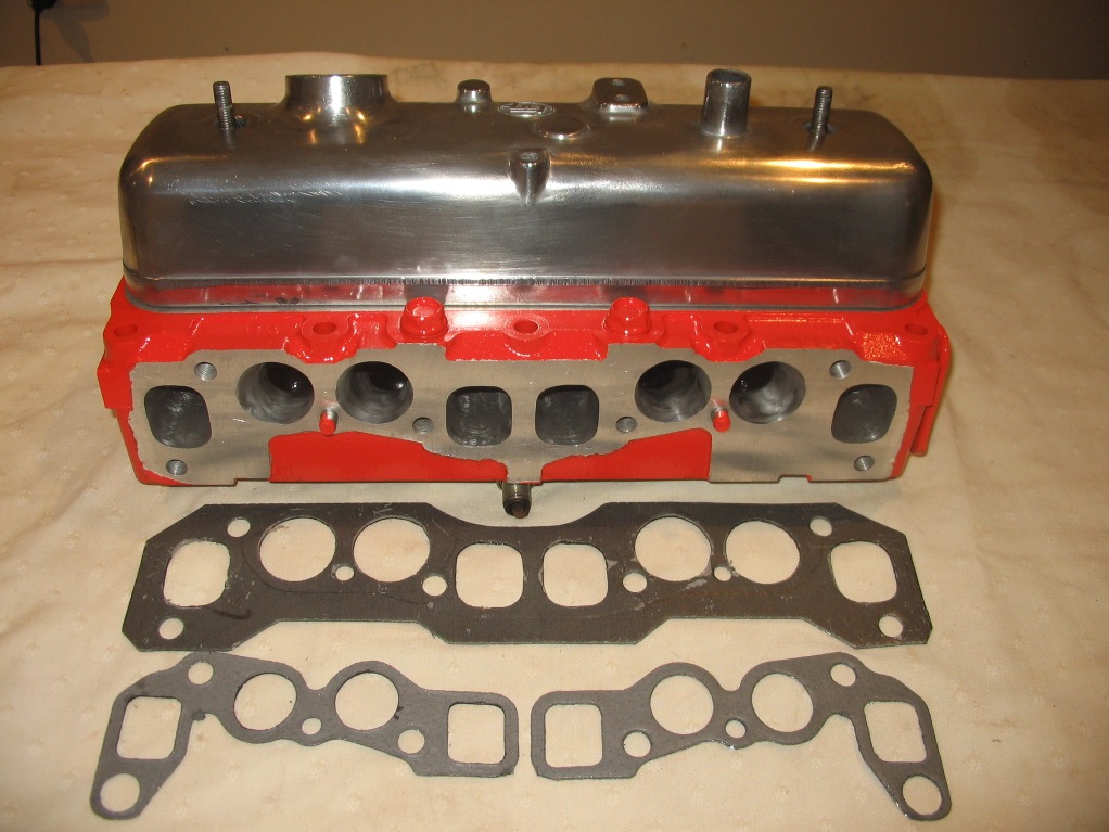

head, has been shaved 10 thou bigger inlet valves out of datsun, twin valve springs, valve's and valve seats have all been tripple cut.

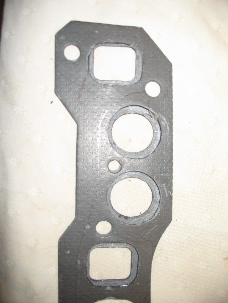

inlet and exaust ports have been opened up and flowed, and portmatched ilet mainfold and extractors.

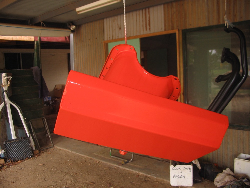

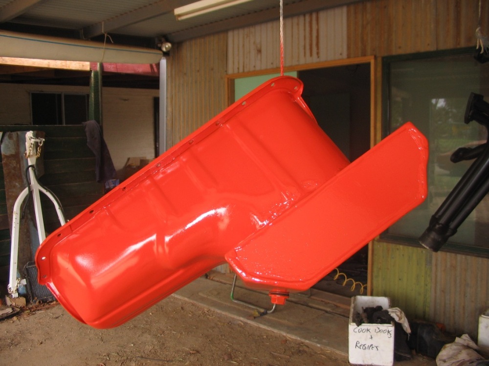

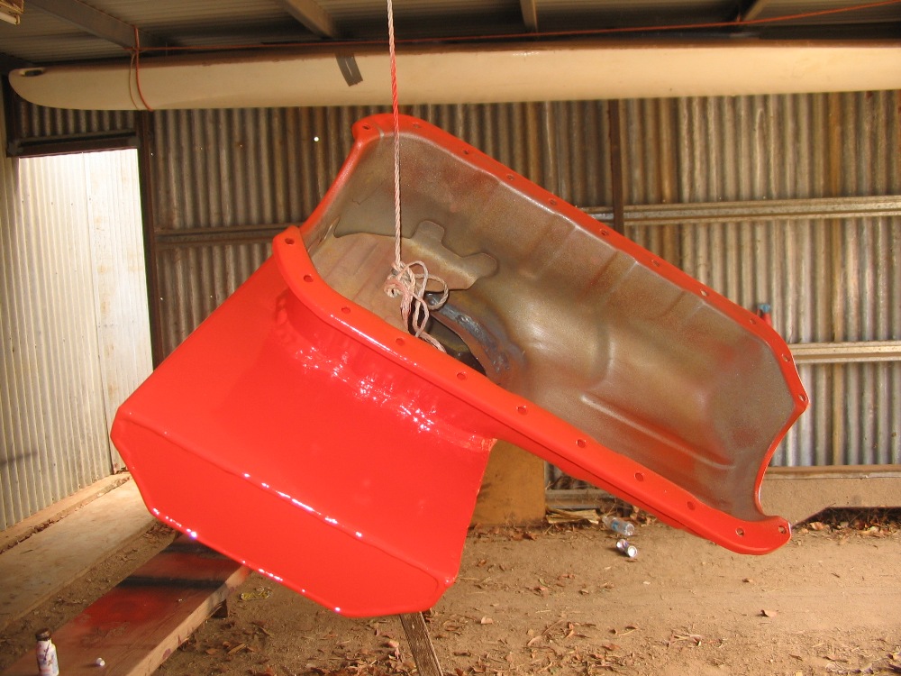

modified sump
electronic dizzy

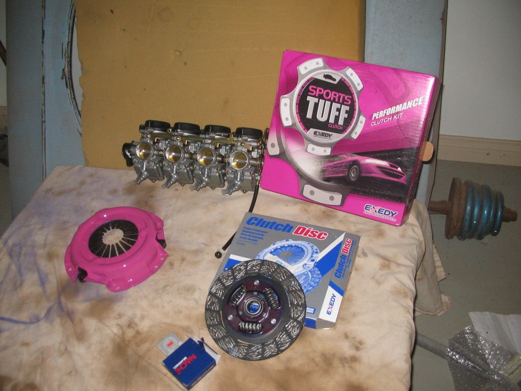

looking into fitting quad 900cc kawasaki carby's???? (any sujestions)
note: have engine out of race car still on engine stand thats why this is being put together on a milk crate

Sexy K motor, love the single Weber! very nice :hmm:
Bloody big ports!!! :wink: Good to see you have the bigger valve below them to make them worthwhile too!!

Not sure on all the costs yet get bill on friday and also a heavy duty clutch and presure plate. still trying to work out what to do about carbys?????
got brand new kawasaki quad carbs last nigt now just working out the manifold and everything should nearly be ready to go :D

Where did you get your extractors from ?
Sweet build :D
Hey thanks Doogs, and i got the extractors from an exhaust center in swan hill was going to cost me $260 for them to make me a set but then he had a look in there stock and turned out they had these ones sitting in there so i got them for $100

and yeah I'm going with the quads manifold is getting built as we speak.
also here are some pics of carbys and new clutch and pressure plate.
