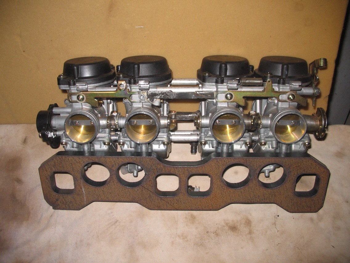

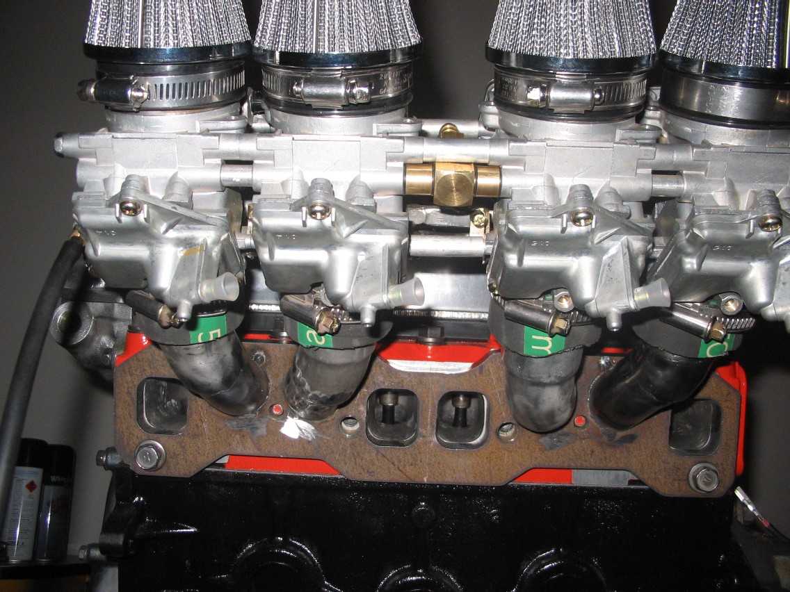

Mate whats the total length of those carbies from one end to another? My crude estimate from that picture is about 400mm?
You might have a hard time fitting them in if they are too long because the carb may be quite close to the firewall. You could end up needing different length intake runners. I'm very keen to see what you come up with manifold wise!
The two end carby's line up with the two end ports so theres plenty of room only trouble now is there is no where on these carby's to connect vaccume hoses from the dizzy????
Wow that's good. Sounds like they're quite a bit shorter overall than a set of twin dells/webers! Definitely interested to see how you go with this setup!
I would say you wont have vacuum ports. I'd just piss off the vac advance anyway and run mechanical advance only. You should be running a better cam to take advantage of your carbs, so if I were you I'd get the dizzy recurved to suit the new cam and no vac advance.
Yeah thanks philbey will be using mechanical advance to over come that problem didnt get the manifold cut out over the weekend so hopefuly tomorrow it will get done so we can work the rest of it out.
Why not make a vacuum connection across all the manifold runners. Like a vacuum plenum type thing, and feed that to the dizzy vacuum advance.
Vacuum advance gives better part throttle drivability and added fuel economy.
Cool little car you've got there. Good effort. :)
Thanks mate um where abouts do you mean to build this just onto all the runners?

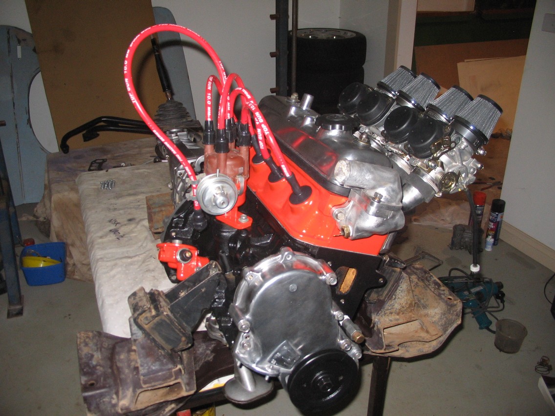

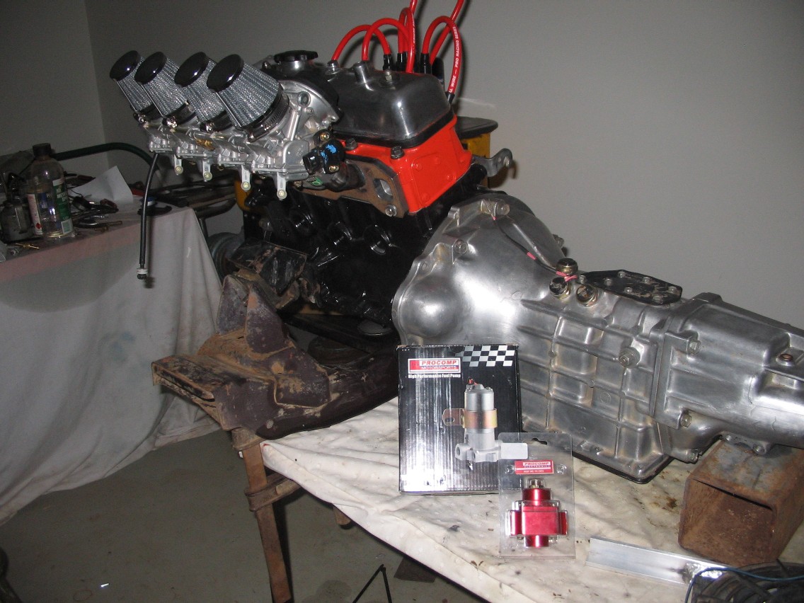

Hey guys got the manifold plate cut out and also a few spares, we have spaced the centre of the carbys out to even them out on the inlet ports so that all four inlet tubes can be made the same lenght (this should save a lot of stuffing around). Will be running four chrome 54mm pods.

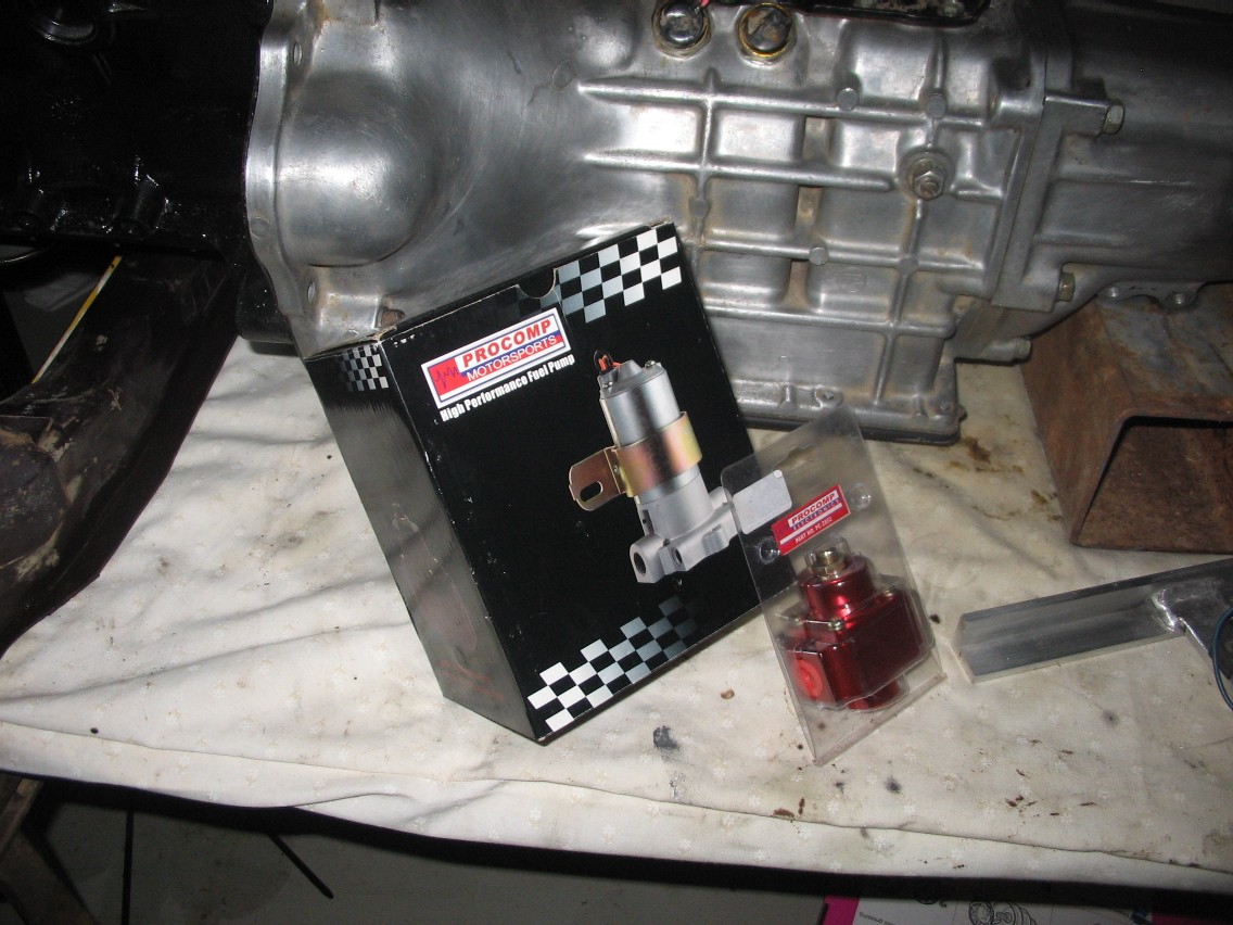

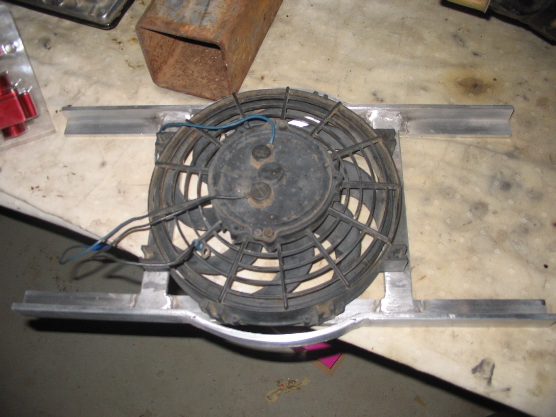

Hey guys here are some more photos of the motor build the manifold has been built for the carbies and they are now fitted up :D . Have bought all new gauges and also 10 mm top gun ignition leads an also a pro comp electronic fuel pump and regulator :D . The radiator has been tripple cored and dad built a new bracket to hold the thermo fan rather then going through the radiator.Dump pipe on the extractors is for travel purposes only to get it to town to get the exhaust done(will be a noisy 11kms).Hopefuly all going well with the long weekend it should be all fitted up and ready to be dynoed tuned later in the week will put results up once done. :cool:
