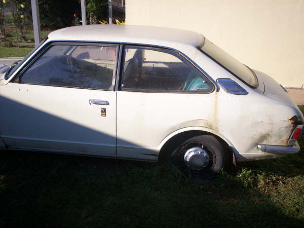

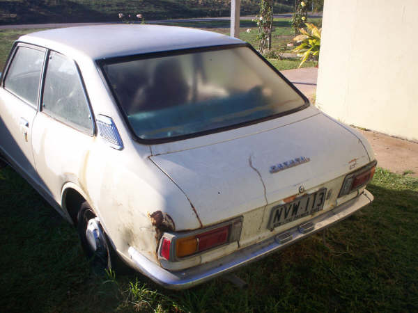

ke30dude Posted May 31, 2008 Report Share Posted May 31, 2008 I am looking into buying this beastie, but worried about this damage. Rest of the car is pretty good, not much rust at all even the spare tyre well is excellent. What is this gonna cost to have fixed up in that corner for the basic metalwork and bogging? I am plenty capable of stripping out the parts around it and painting at a later date just not very good at unbending panels. Has been sitting for a LONG time. Quote Link to comment Share on other sites More sharing options...
radrollaz Posted May 31, 2008 Report Share Posted May 31, 2008 (edited) I reckon any panel beater worth anything should be able to get that straight in a day or so, i take it that rusty bit is just surface rust from flaked off paint. The hard parts are the edges and lines is it bent around the tail light area towards boot lid or just near bumper. :) Edited May 31, 2008 by radrollaz Quote Link to comment Share on other sites More sharing options...
ke30dude Posted May 31, 2008 Author Report Share Posted May 31, 2008 Haven't actually seen the car yet, I had the bloke send me more pics but these were the best for showing the damage. its going for $250 reserve not met at the moment. Quote Link to comment Share on other sites More sharing options...
oh what a nissan feeling! Posted May 31, 2008 Report Share Posted May 31, 2008 The bit near the bumper is no worries, it looks pushed in over the wheel arch?? If it is, thats a bit of a worry. Quote Link to comment Share on other sites More sharing options...
Budowski Posted June 1, 2008 Report Share Posted June 1, 2008 I reckon any panel beater worth anything should be able to get that straight in a day or so, i take it that rusty bit is just surface rust from flaked off paint. The hard parts are the edges and lines is it bent around the tail light area towards boot lid or just near bumper. :bash: I agree, i ran a workshop for a fleet company seen alot of damages like this. Id say 600 roughly to straighten and paint in primer, the panel shop will probably recomend painting the whole car due to the condition which will be something else ull need to consider espcially being old. May have hidden rust and some more dents that require attention Then you may need to go down the track of getting new windscreen rubbers or even a whole rubber kit haha where does it end Quote Link to comment Share on other sites More sharing options...

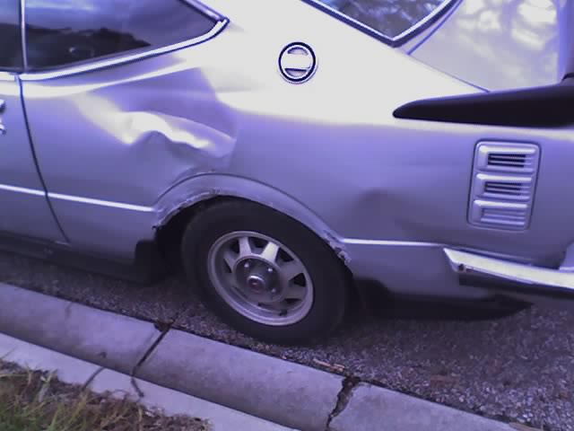

Murd 55 Posted June 4, 2008 Report Share Posted June 4, 2008 (edited) well. this is an example of my car after being killed. so I'm sure that can be straightened out. Edited June 4, 2008 by Murderess-KE55 Quote Link to comment Share on other sites More sharing options...

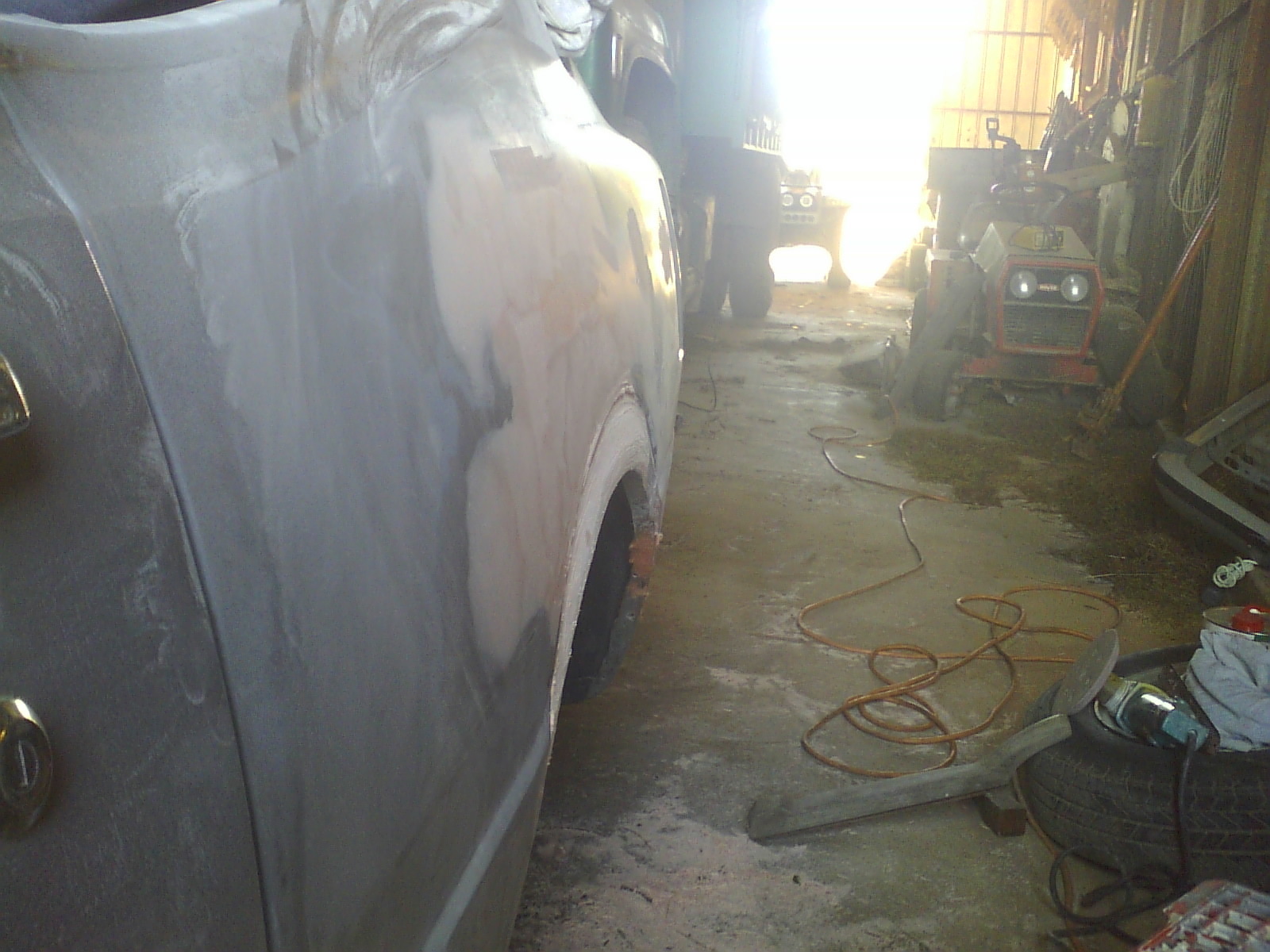

Murd 55 Posted June 9, 2008 Report Share Posted June 9, 2008 lol. this is where i admire haveing an ex mechanic grandpa. 2 hour drive to the middle of no where and he fixed it all for me on the farm i just payed for materials. still annoying as it wasnt my fault but the cops are surely gonna believe a qualified bus driver over some kid who had her p's for a couple weeks. Quote Link to comment Share on other sites More sharing options...
