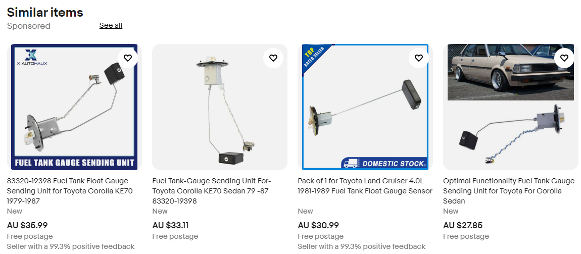

Hi Jose !   Welcome aboard.  Where are you located ?  In Australia, there are a number of after-market fuel guage sender units available here, on ebay; primarily for the KE70.
Not sure whether the sender unit, for the KE70 is the same as that for the KE55, although they were both built in the 1979-80 era.  Altezzaclub, might be able to clear that question up ?
Frankly, they are a pain in the butt, as sometimes, when the guage is not working; replacing the sender unit, does not fix the problem. The guage does not work off 12 volts, like most things in the car.  There is a small regulator, behind the dash instruments, that produces a 8V, or 9V voltage, to power the fuel guage, so it's reading does not jump up & down, with the battery voltage, which is always varying.  This regulator, sometimes burns out, & needs to be replaced. Happened to me, & you'll probably find a thread on this form, regarding that, if you search.

Where's the KE55 tank?  Behind the back seat?  Deep short tank? Quite the opposite of the KE70's one under the boot floor which is large in area but shallow. I'd expect different sender units.
The new KE70 one I bought off Ebay only gives half a tank reading, so you can have the top half and run out at halfway, or have a full tank showing half and run out at empty.
I don't know where you'd get a specific KE55 one from.
