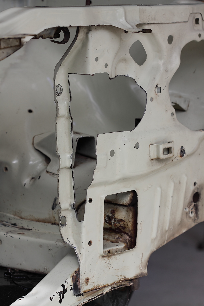

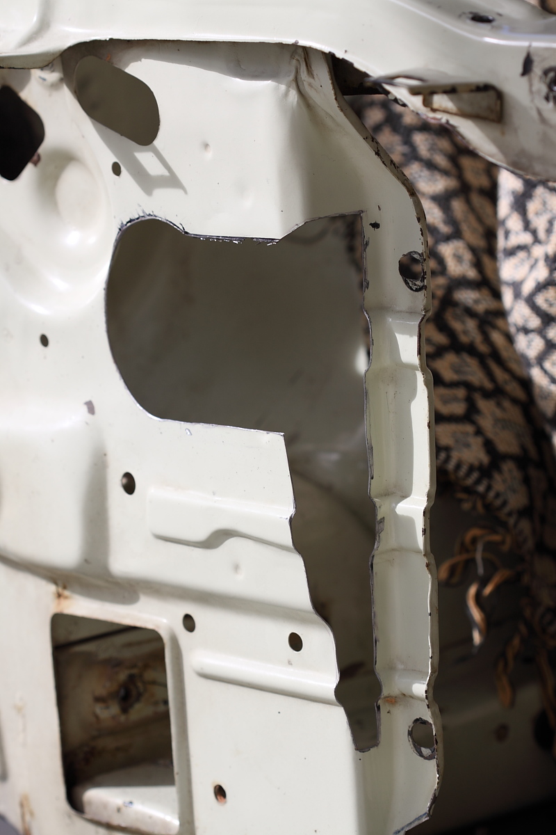

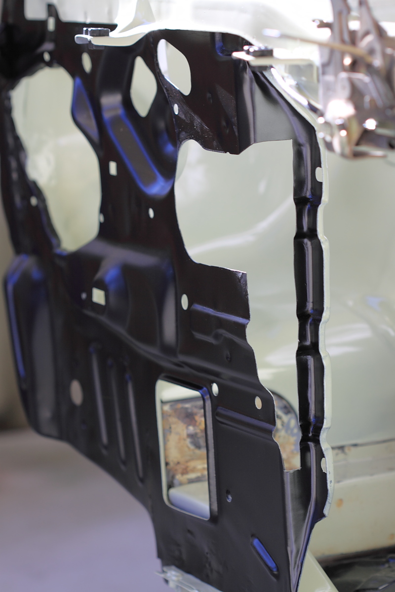

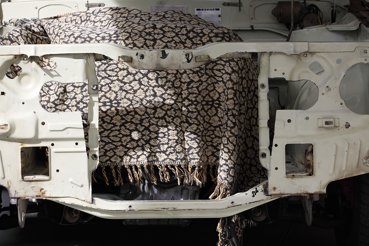

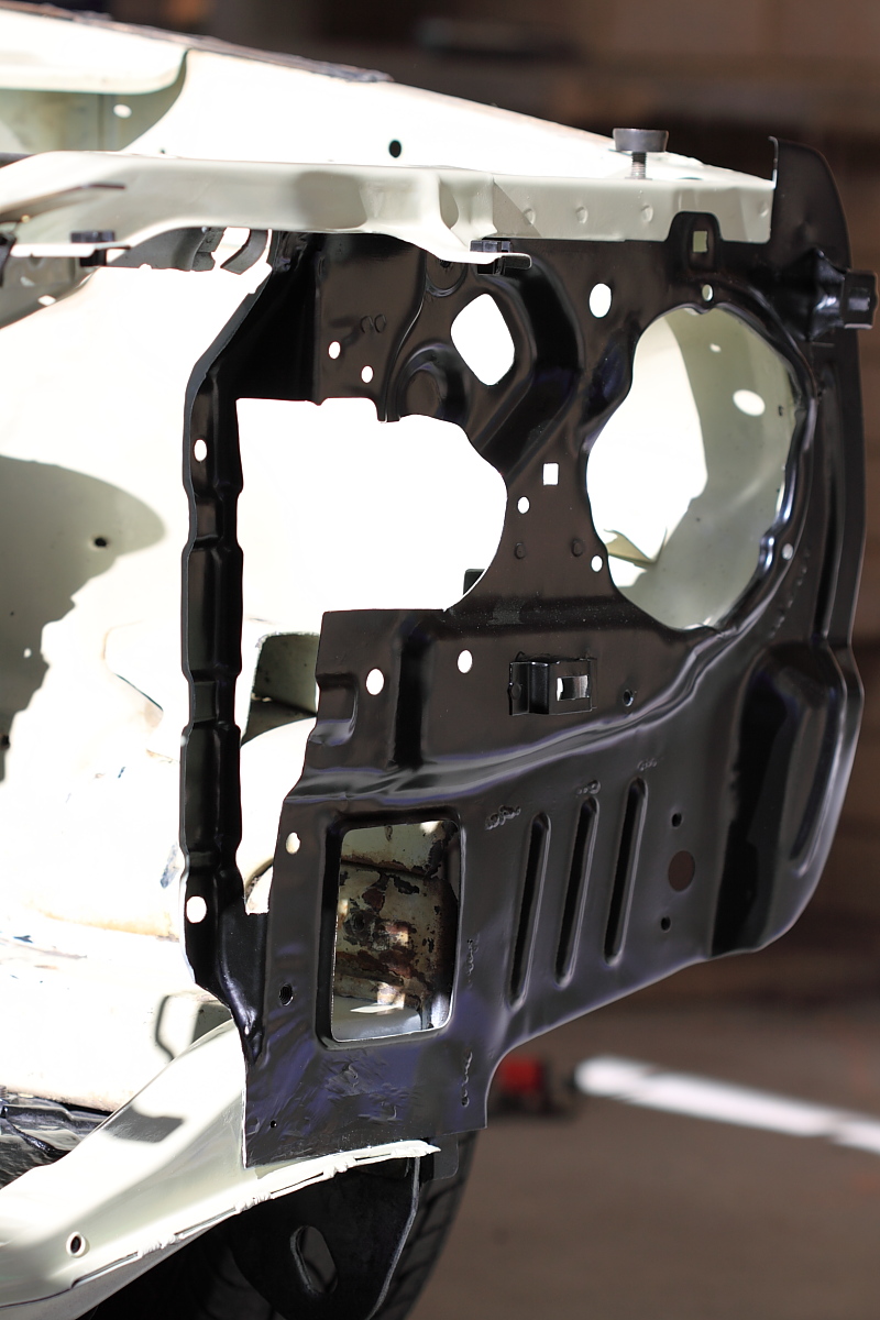

Since the last update i have started to fit the intercooler, it bolts up sweet with some custom brackets.
I have cut away some of the front panel, so it fits with out having to chop the grille and have it stick out like dogs balls.

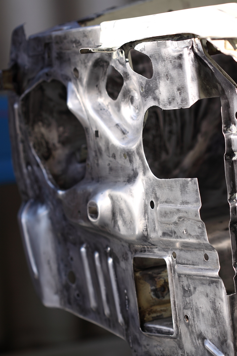

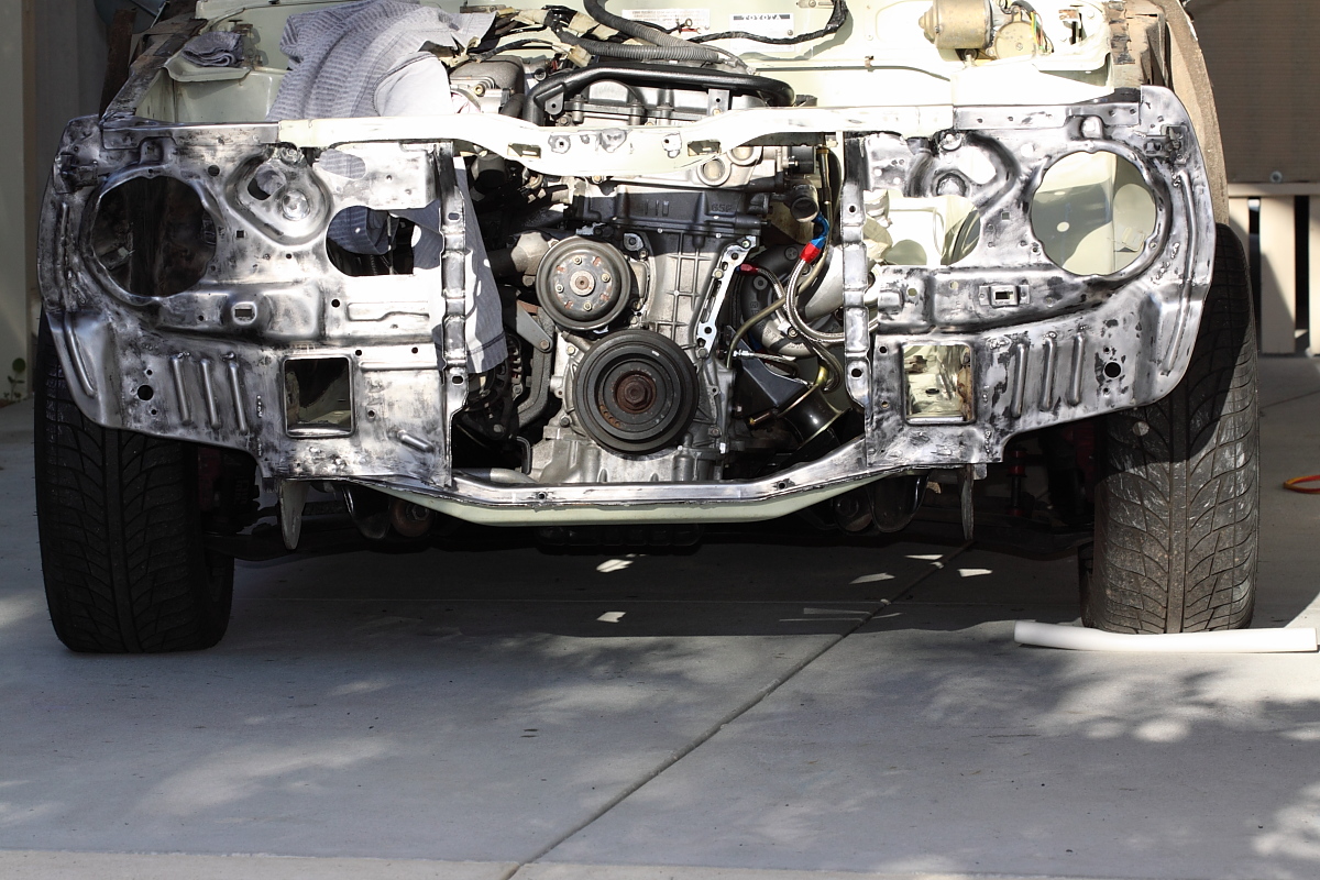

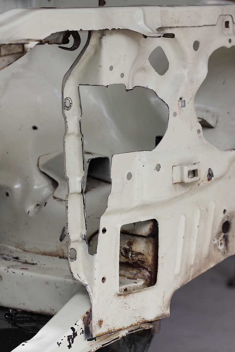

I am in the process of stripping back the front panel and painting it black.
Will update with pics soon.

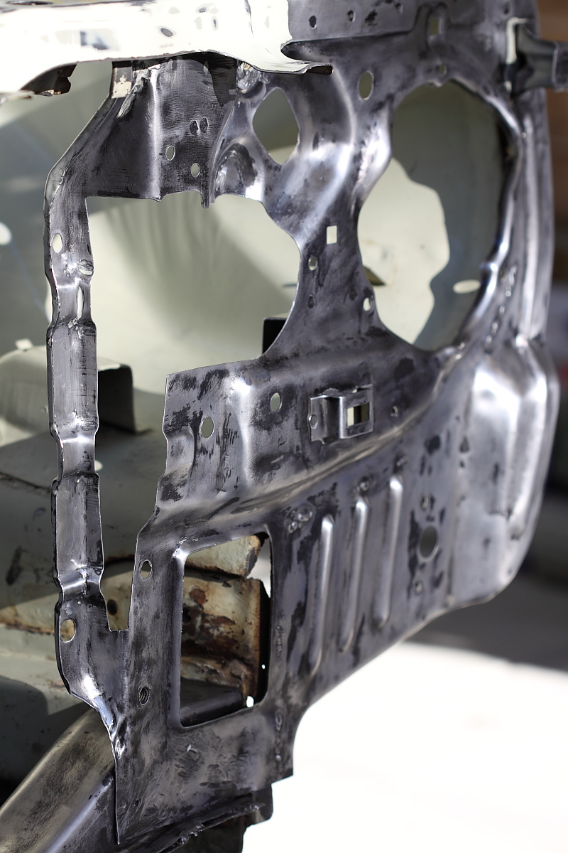

Hours later.
Stripped to bare metal and treated for any rust.
post-4551-1278247223_thumb.jpg post-4551-1278247257_thumb.jpg post-4551-1278247283_thumb.jpg
Managed to get it in etch primer today as well, hopefully get some colour on tomorrow.
How's the strentgh of that front panel now? Not to flimsy is it?
No it hasn't made it too flimsy, but just incase there will be some bracing added to the front panel to it keep rigid.
The front panel isn't a structural part of the car.
The strength is in the top rad support and bottom cross beam.

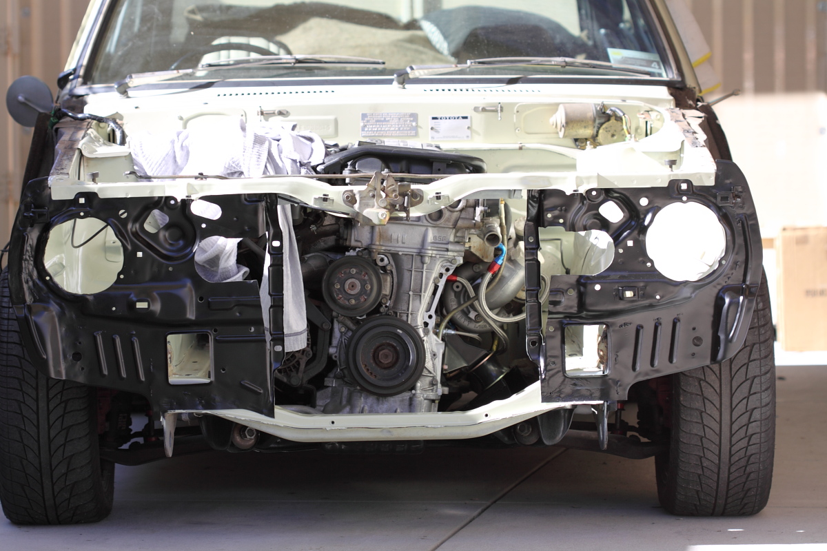

Here it is all painted, i reckon it looks pretty factory.
Before And After

hay man great to see the progress still coming along nicely, with the front panel this is what i done
after i cut the holes, just welded a strip 10mm wide i think around the hole, it strenghten it up alot
and dosent move at all,can sorta see what i mean below,
also i seen on another idea that chrisgt done,sorry mate for stealing your pic :)

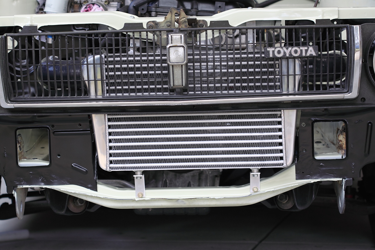

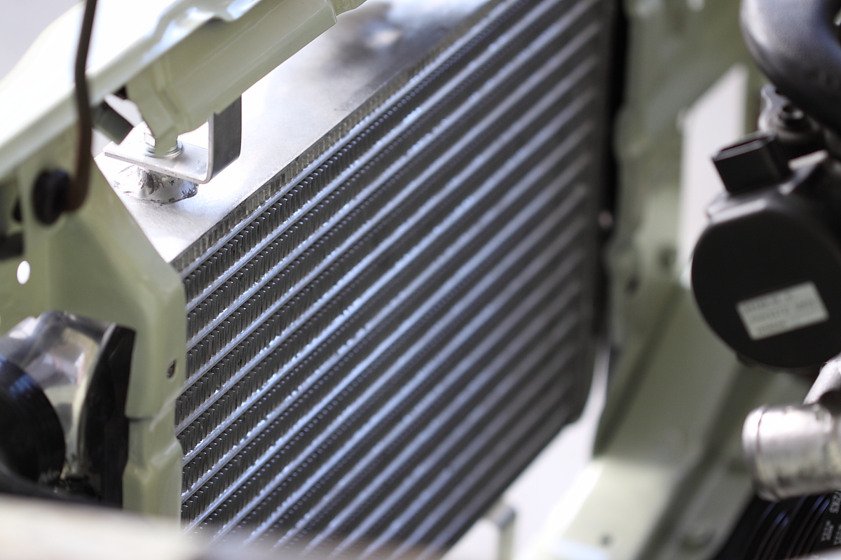

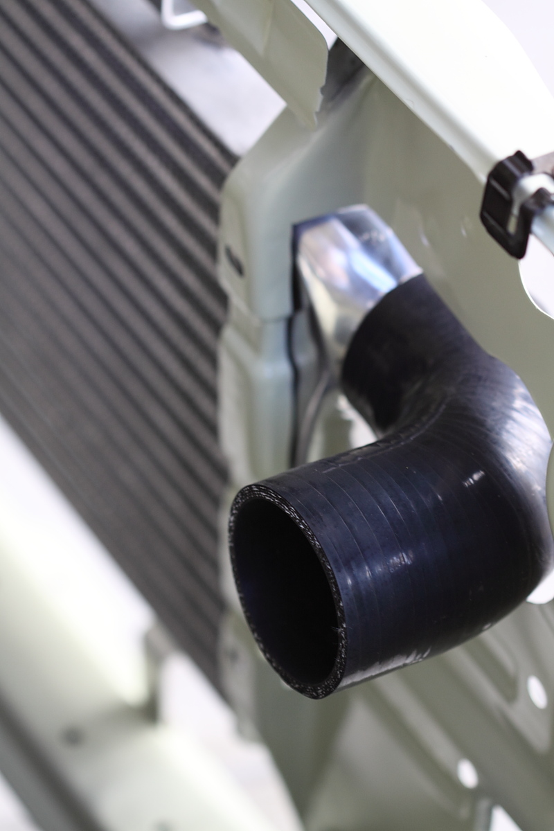

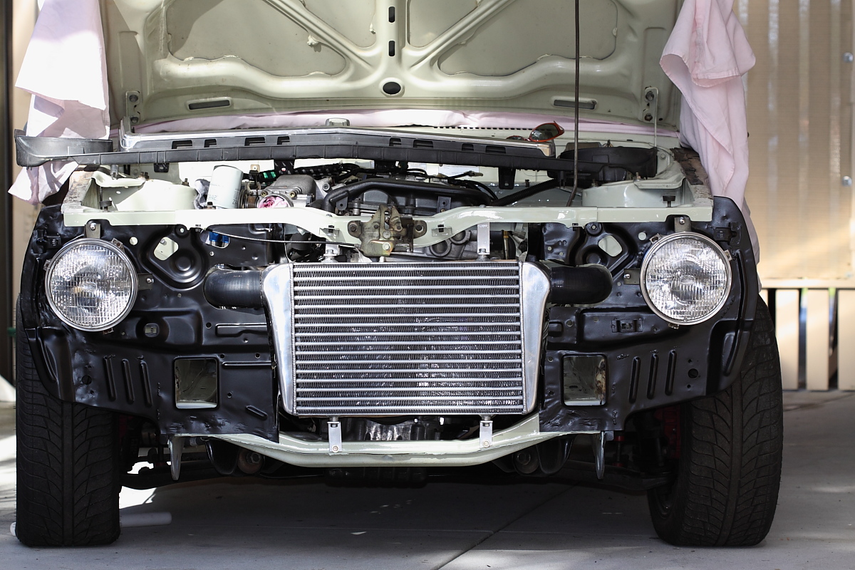

Starting to put the intercooler on, fits well.
The way i have mounted it leaves the radiator mounts still standard, hopefully get the rad the next day or so.
Not sure if i want to black it out or leave it silver, i will decide once its all together if its still noticeable i will paint it black.

paint it for sleeper look
AS above,
I would paint it black, go for the stealth look. It is also harder for the boys in blue to spot aswell.
So that cooler is off centre? Like to stock rad?
Yes it does sit off center, i want to flow as much air as possible to the radiator which is still in the factory position.

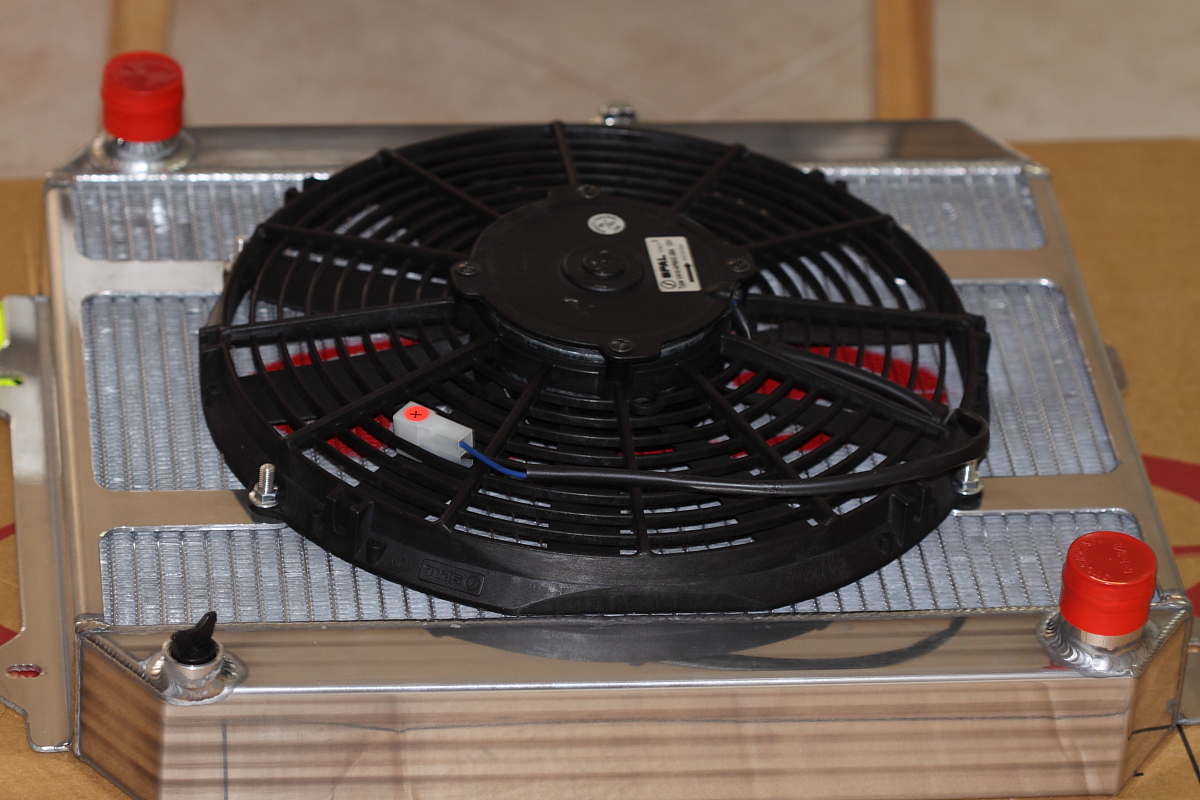

Just running an upgraded 55mm twin core alloy rad in the same spot.

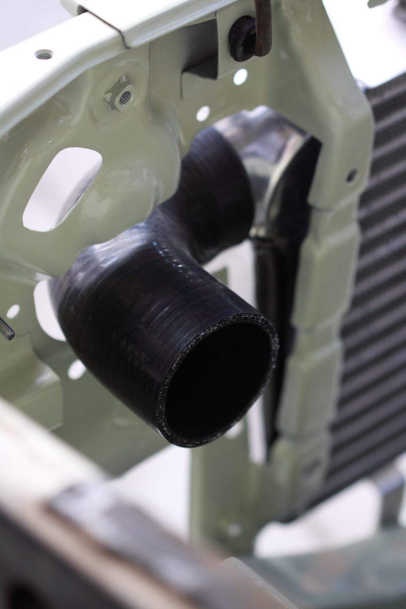

Just got this in the mail, now to go see how it fits.
Also a pic of the remote oil filter, so much easier to change filters this way.
Very nice ........
Thanks mate

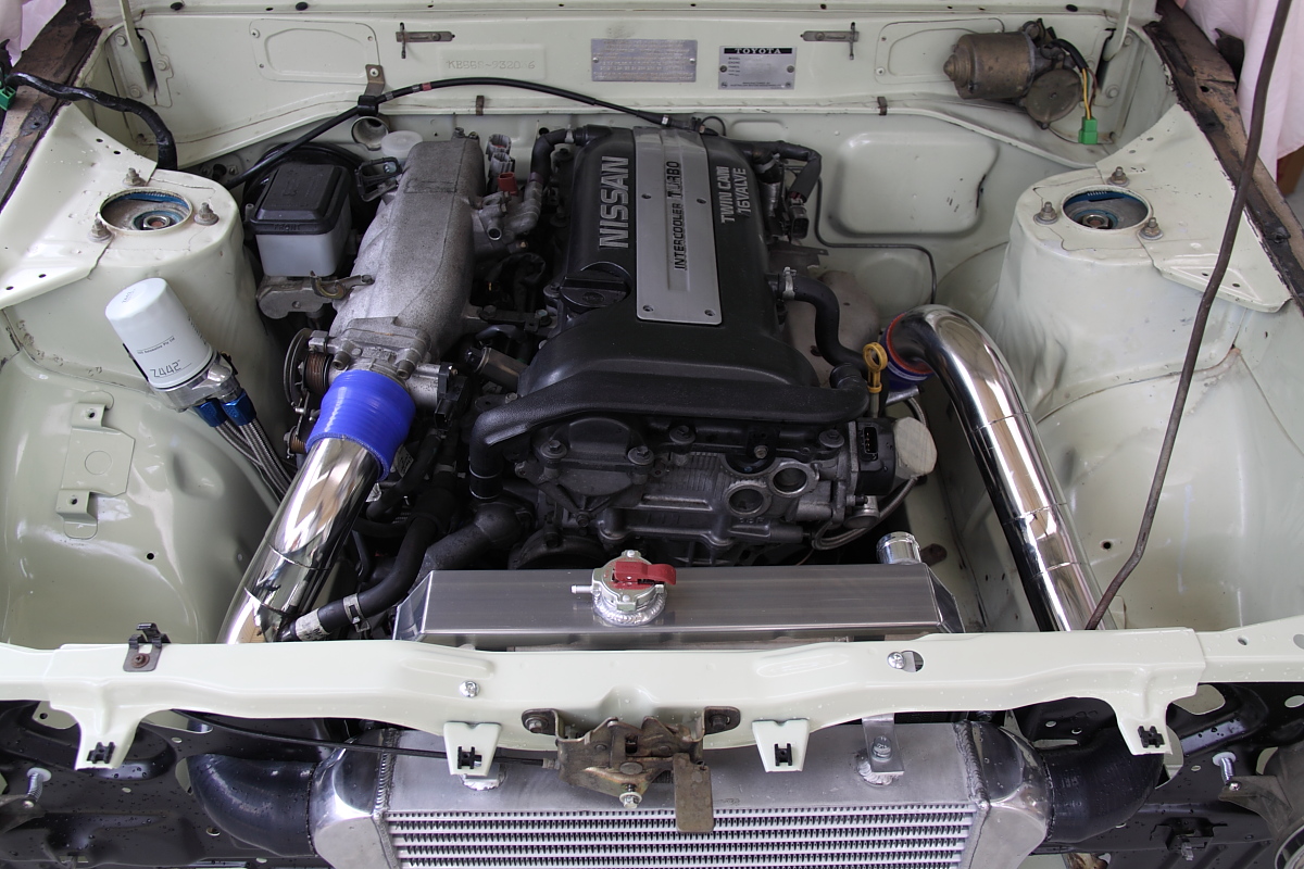

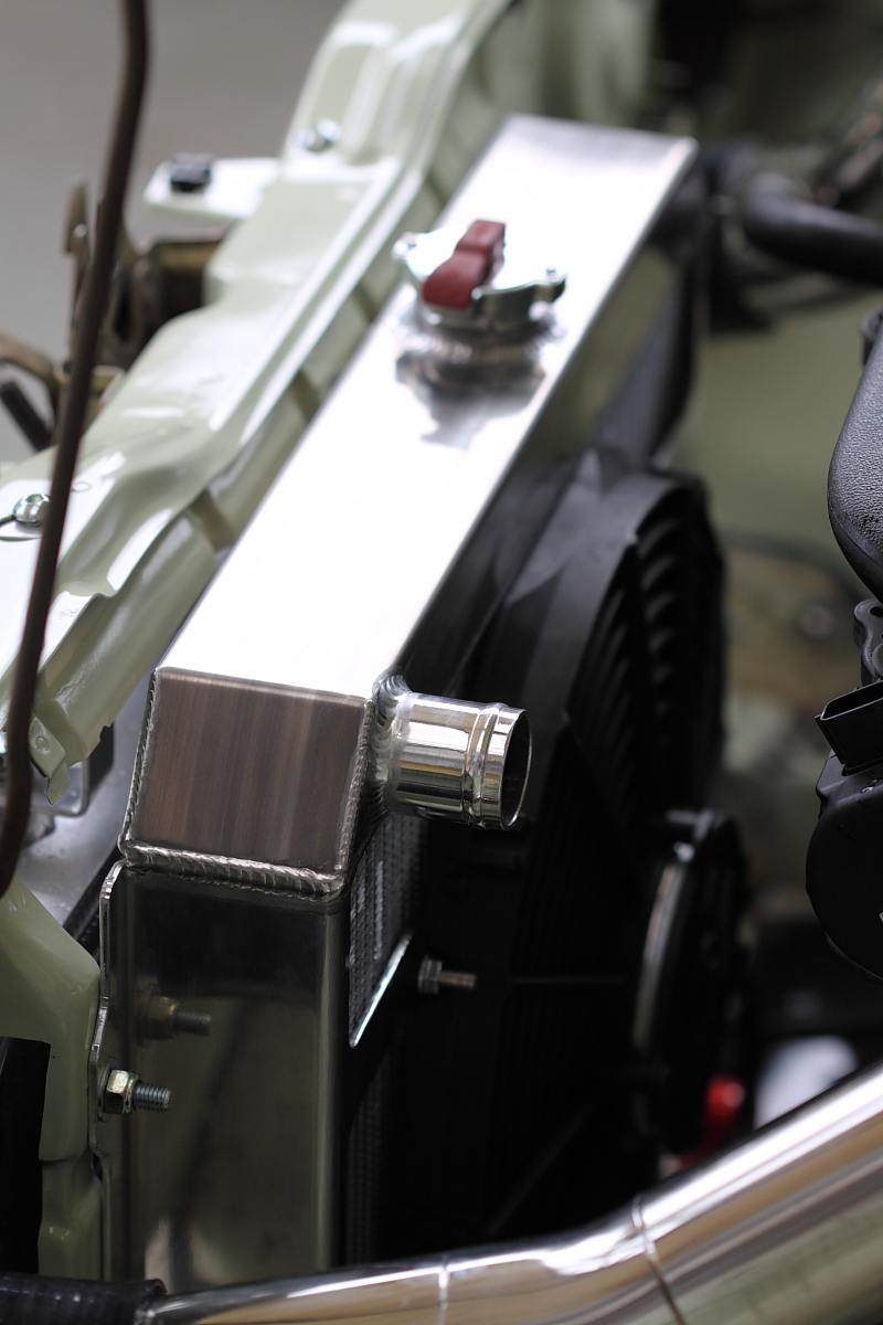

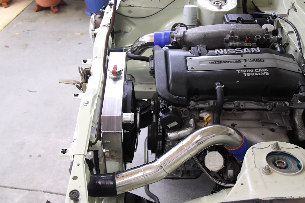

Fitted up the rad just to make sure it fits with the cooler pipes.
Still have to get some decent cooler hoses as well.
Coming together quickly now, made a start on the wiring.
What a nightmare trying to decipher all these wires, none of the colors match up to the factory corolla manual :D :( ???
Any way here are some pics of the rad and engine bay as it stands.
