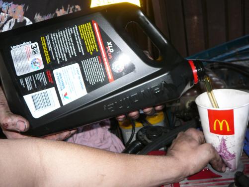

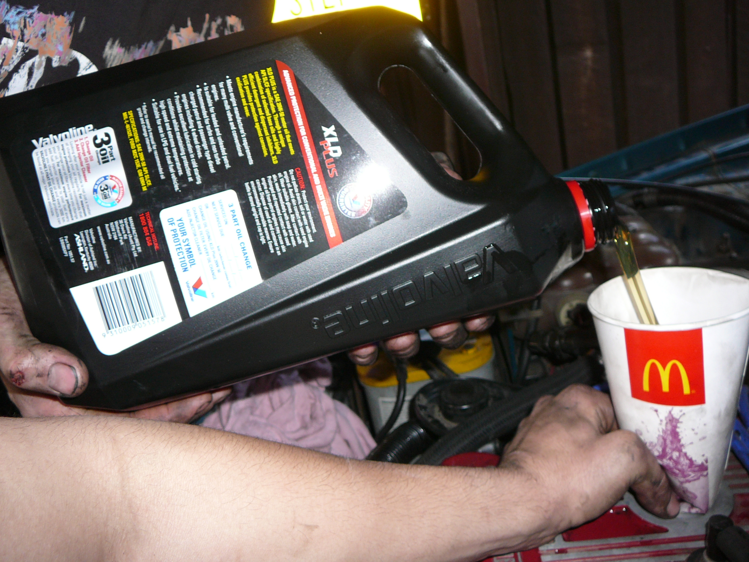

Evan G Posted April 26, 2010 Report Share Posted April 26, 2010 from camerondownunder Also want fast way to bleed brakes... Get a container run 2 hoses from it. one to bleeder nipple on brake and one hose to inlet manifold. Loosen off brake bleeder nipple. Start car start filling brake master cylinder as car sucks through brake fluid. If I am by my self I just kill engine from in the bay and presto go tighten brake nipple. Easy fast sucks a LOT of old crappy dirt out to. and one of my tools Quote Link to comment Share on other sites More sharing options...

Evan G Posted April 26, 2010 Report Share Posted April 26, 2010 my maccas cup is a better funnel! Quote Link to comment Share on other sites More sharing options...
