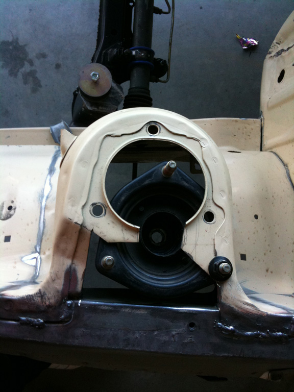

Small update. Did half a day's work today. Had no 3mm plate left to finish the strut tops tho.
