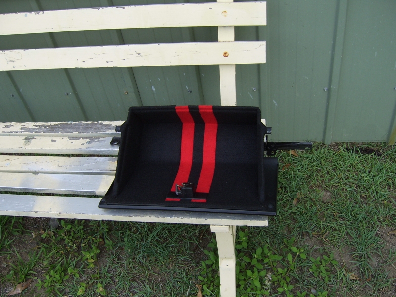

Big thanks to J for the alarm so far; wow ... haha.
Once he uploads the pic of the glove box.. you'll see what took me 3 hours today lol. I think it looks tops :)
