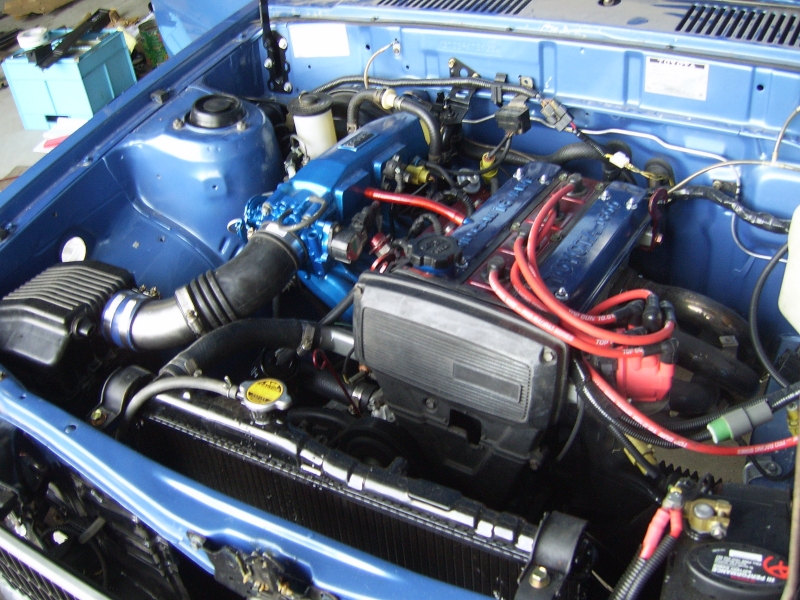

Motor (as of this being typed, motor still in need or reco, may change, but what I would like…)
- JDM Ae86 4age bigport (With Tvis connected!)
- Bottom end o/Sized pistons, new rings / bearings. Shaved block.
- Top end – Head shaved (20thow ) 4 seat valve re-face intake, 3? For exhaust. New valve steam seals.
- Stock Cams, Stock JDM ECU, stock injectors.
- Toyota oil (castrol corporate oil haha ) – 20W50, Genuine oil filter
- JDM RWD intake manifold.
- Bottom end painted black, head cleaned up, unpainted. Red bling-bling r/covers. Manifold / TB Bling-bling blue

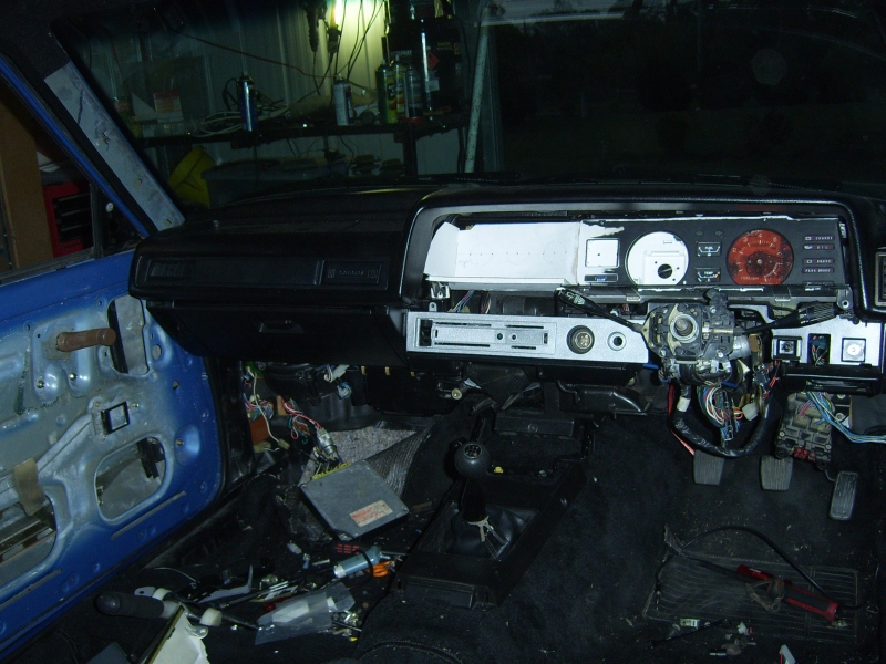

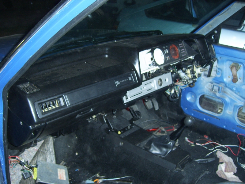

- Dash frame changed; stock radio area all removed in place for new custom dash
- Custom dash built; stock assembly continued all the way over to the left ~ converted to LED.
- Dash consists of Stock backings modified in Macromedia flash, stock lettering and spacing applied over new oil temp / oil pressure / water temp / fuel gauge / volt gauge meters. Printed out onto clear Vinal, as black gauges. Stuck onto 2mm purspex backing plates, with milk bottle (yes milk bottle, pefect material) sub backings for even spread of LED light – White letters, with Red “warning” zones. Red LED needles used, modified and created from 100 series landcruier, TCR 10 tarago, Ke70, Ke55 corolla, 1989 honda civic, 2006 jaguar x type?, TRX bluebird, late-late sigma and an Is250 dash’s. Covered in 5% black tint on custom clear purspex covering – giving the lexus impression; when the vehicle is off – everything is black, nothing is viewable. When vehicle is on, The white and red LED’s light up, and all you can see is the gauges :) – ½ VTBI !
