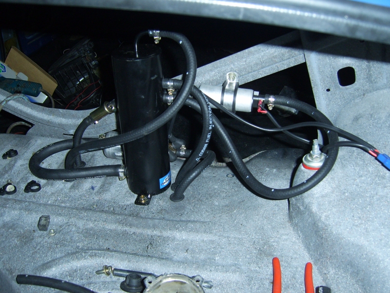

Matt has changed plans with his fuel setup, Now he is going to run an inline pump to feed a surge tank with a high pressure pump. Also today upgraded the feed and return lines.. Fuel system should be sorted again by the weekend.. He also cleaned and painted the kickpanels and the carpets are now sitting in the car ready to be cut to suit.
I Fitted new high tensile bolts, nyloc nuts and spring washers to hold extractors on, Fitted O2 sensor, Mounted coil and half mounted washer bottle. Engine wiring harness has now been run inside the car, I have fitted the ECU relay and Circuit Open relay to control the fuel pump.

Teddy got all the surge tank setup completed just before, Finished wiring up the pumps and it fired up on the second go :locked:

Yeah, I manually Primed the surge tank (Didn't want to run the high pressure one dry) But it took one crank cycle to pressurise the fuel rail (Was no fuel in the lines up to the engine because they are all new)..

So many new things happening.. yeah, fuel system wasn't good enough. Old pump running 2 years odd in 1/2 tank fuel, in un-baffled carby tank on small lines ~ bad. Car now has Surge tank, lifter pump, lifter pre-filter, Main pump, fuel filter and upgraded from standard (5mm / 6mm ? to 8mm lines ~ 5/16th? Something like that) - Upgraded as in bent all new lines up; chucked out the old lines that i painstakingly painted gold hahha.
We even removed, and re-bent up and assembled the pickup assembly - welded and all. Didnt get any pics, silly me. Its a work of art.
