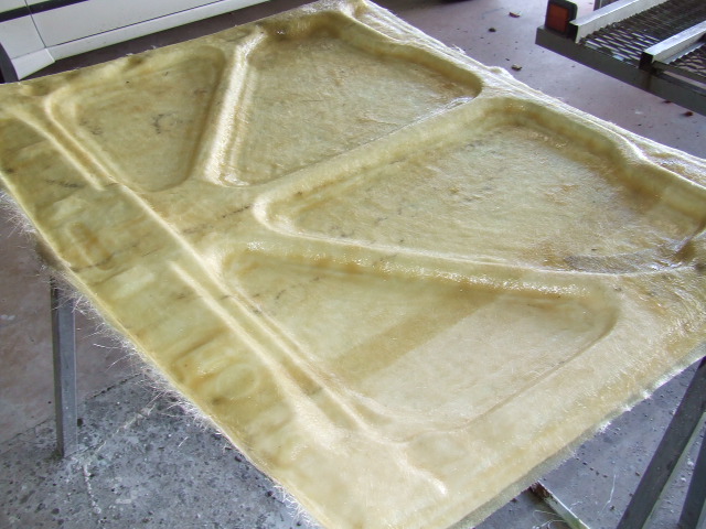

Inner and outer bonnet skins in the molds.

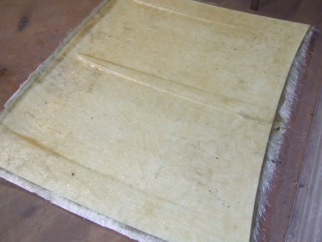

dat fibregloss, I need 2 lern dis
Messy, spiky and sharp, poisonous chemicals, poisonous vapours, impossible to clean up afterwards or get off your skin, poisonous sanding dust too....
You sure?
Light though......
Not quite sure what your trying to say Keith. Please explain? LOL.
It is nasty stuff and you need a proper respirator with a styrean filter, not just a dust mask.
Do you mind if I ask where you get the matting/resin/catalyst/release agent? I've wanted to try to make fibreglass panels for a while now but I haven't found anywhere that sells the materials.
Edited by rian
What's with all the negativity on the fibre glass, Craig has done a fantastic job, fibre glass is great stuff, it's only sharp if you don't sand it, not trying to start an argument hear or anything just saying it sounded a bit harsh
I get my stuff from SEDALS here in Toowoomba but Iam sure you could find somewhere near you on the net.
A good marine shop or boat builder should be able to help.

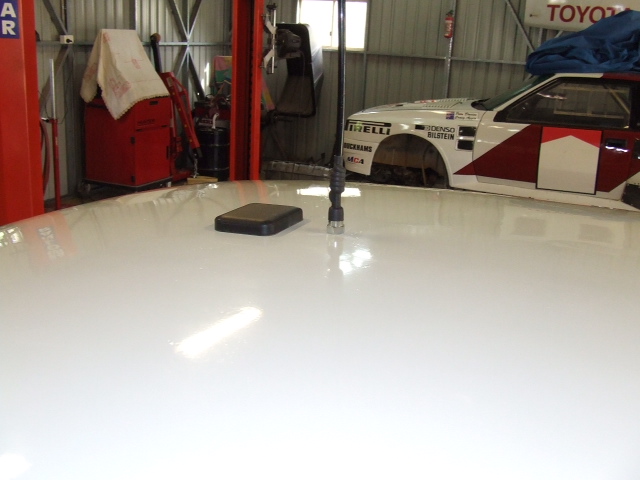

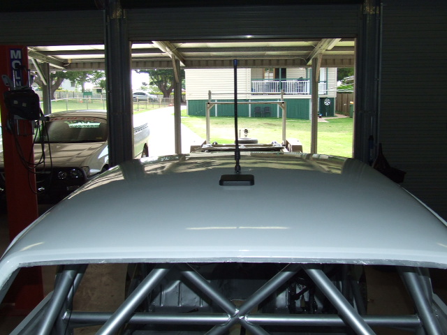

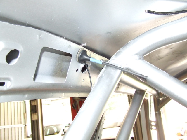

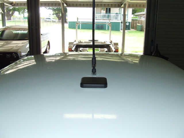

Aerials for the UHF and rallysafe computer are in.
Use to work for Sedl's. Just be careful with the fibreglass mattting, i had to cut the lengths on the floor, myself and one other guy, we were the only ones that'd clean the floor first the other guys would just roll it out regardless what crap was on the floor at the time.
Try Brauer's Marine on Markelee Street. Near the corner of McDougall and Hursley. From memory a mate found they were cheaper on the resin and hardener
Cheers Rob. I buy a whole roll of glass mat still in the box and resin in 20lt drums so they do me a good deal on price.

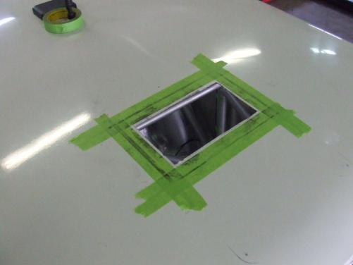

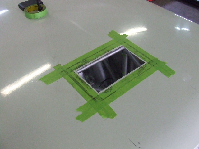

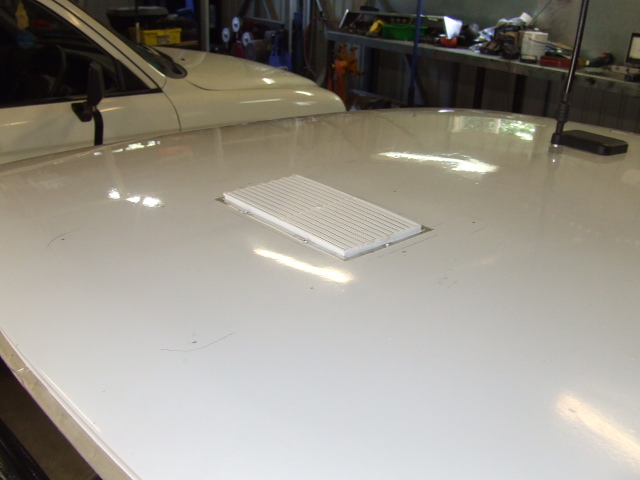

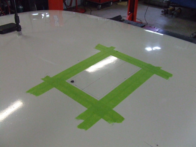

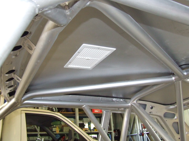

There is something fundamentally wrong about cutting a hole into a freshly painted roof panel.
It has to be there, but your head says "don't do it".
Its just disgusting stuff to work with- I thought welding and grinding and painting was messy and grubby until we got in fibreglass panels.
We made guards, bonnets and boots for the Datsuns years ago.

Yeah ... don't use abrasive discs to cut the roof vent hole on paint, rust spots are a PITA.
I cut the hole before I painted this time round.
Good advice Mika. I used a jig saw. I should have cut it before paint as well but it turned out ok.

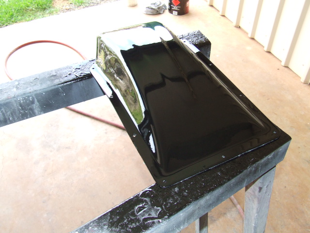

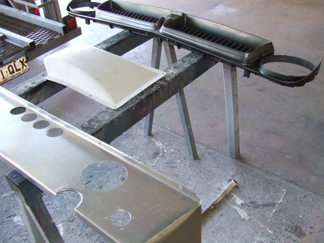

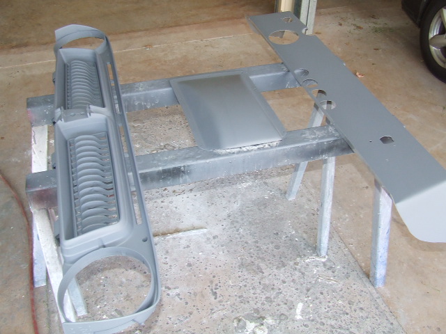

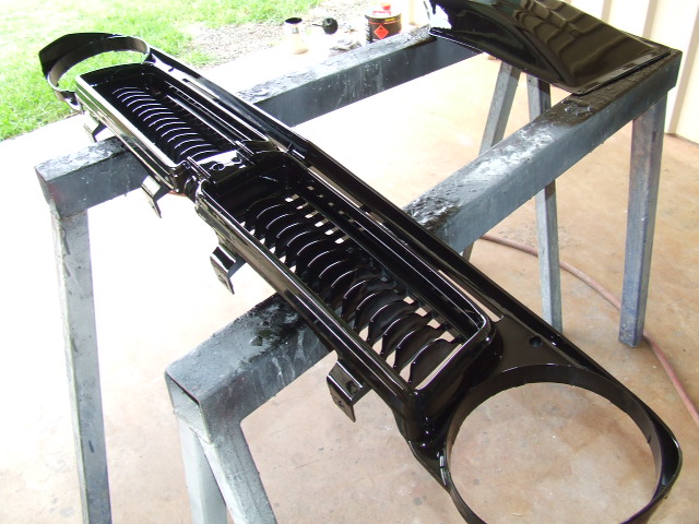

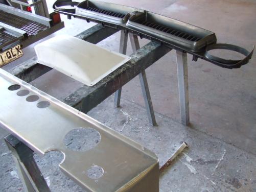

Dash, Grill and roof vent being painted.

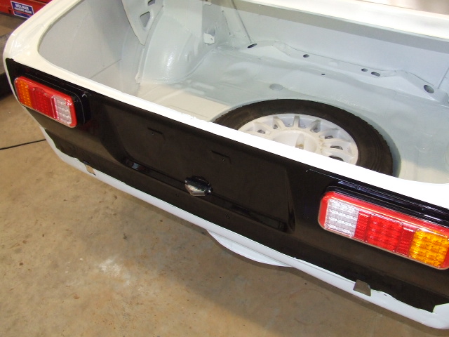

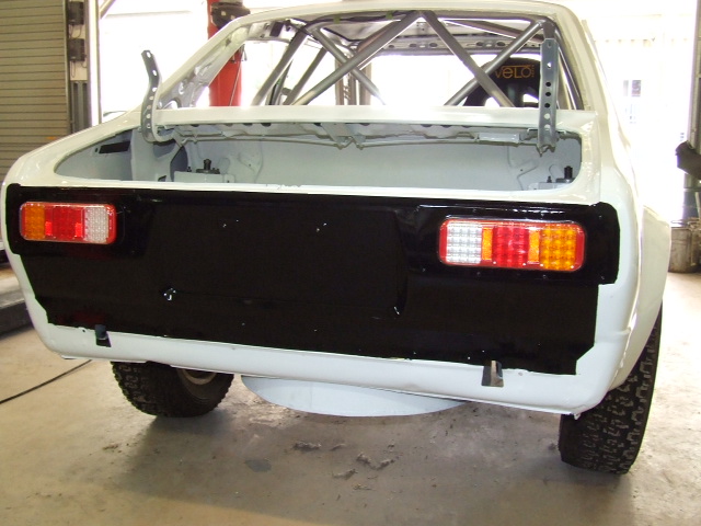

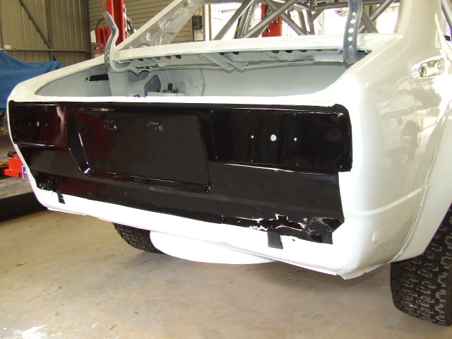

Tail end is painted and lights are on.
